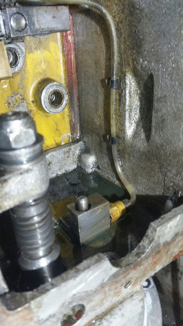

One thing i can't figure out is the machine is piped for way lubrication, I found a pump in the bottom of the table feed gearbox, which runs from a cam on the bottom gear shaft. What i can't get my head round, is how the oil would be topped up.......or does it use the oil from the gearbox and pump that out on a total loss basis, presumably you would then keep topping up the gearbox ? If so then it would need really thin oil in the gearbox like hydraulic fluid ?

That pump is for the table feed gearbox itself. On the Mk1, 2 and 3 gearboxes, lubrication to the gear train relies on oil being carried upwards on the gear teeth of lower gears to feed higher gears and bearings. It worked, sort-of, on the earlier ones...
My Mk1 had suffered the indignity of at least the previous owner using grease on the ways. At the end of the re-scraping/rebuilding process, I blanked off and redrilled the existing oil ports and added a few more when fitting a one-shot system. It has 68ISO oil for the horizontal ways and 220ISO oil for the column ways:-

Alan Waddington 231/12/2016 17:56:35

That makes more sense now, thought it was strange.
Where was the original oil reservoir sited on your mill ? I have a pipe coming out of the side of the main column high up, it goes into an aluminium block that has a grease nipple threaded in to it ( although the pipe looks to contain thin oil) I can only assume the previous owner used a grease type gun to force oil through the lines.

It didn't have an oil reservoir, just a number of oil nipples. Which is probably why previous idiots had used a grease gun on them. The original had 6 oil nipples, which gave limited lubrication of the table, little to the vertical knee ways (oil port exited into a gap that let the oil out) and none to the horizontal knee ways. After spending a lot of time re-scraping all the ways and making new gibs, I didn't want to have to do the job again, so nearly every separate surface has its own oil feed (26 in all).
