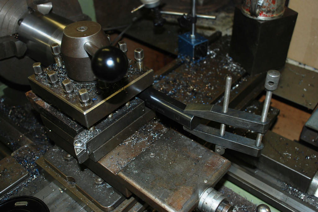

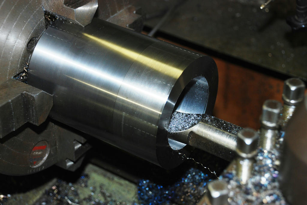

Being the largest part I am starting on the body. Ideally made from a bar of steel about 120mm in diameter by 320mm long, something I do not have lying around the workshop. I did however have two chunks of steel that had been used as very heavy bench weights, they were covered in rust and had a handle welded on but they were big enough for the job including a join, so I set about grinding off the handles and then I skimmed them all round to see what sort of steel they might be? Once I skimmed them I knew they were not cast iron, the curly malleable chips proved that as did the shine of the surface. I was hoping the welds once skimmed off would leave soft metal, that was not the case the steel under the weld was very hard; the cooling weld had chilled the metal of the bar itself hardening it for a depth of maybe 5mm. That would indicate that the weights were some sort of carbon steel. They had come from a sheet metal works when it closed down, Maybe they were for making dies.
One benefit of the smaller pieces is that I can work on them more easily. drilling and boring a piece 330mm long would not be easy, a piece 150mm long is a lot easier to work on. I started out drilling a 14mm hole in the centre of the bar using the lathe, I happen to have a drill long enough so I drilled straight through, although it could be just as easily done from both ends even if it does not line up perfectly it does not matter it will be close enough. I then passed a 25mm drill through making the hole big enough for a small boring bar, that I used from both ends as it was not long enough. the hole was widened to about 45mm. Finally the hole was big enough for a big boring bar that can handle the overhang required to pass right through the work without chattering.
The setup in the 4 jaw chuck is not ideal with a large overhang for such a large piece I kept speeds down and the cuts light to reduce the chance of the work moving in the chuck. Before the finishing cuts were taken I re-trued the bar in the 4 jaw chuck very carefully (both) near the chuck and at the overhanging end to make sure the work piece was running perfectly true.

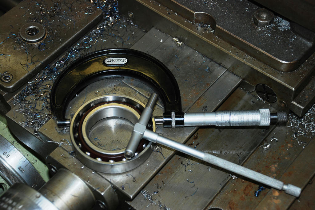

The final step were to bore the 100mm deep x 75mm diameter recess for the stack of 4 angular contact bearings that will support the work end of the spindle. I made the fit a firm push fit rather than a press fit to make adjusting and servicing the spindle. Once the pocket was complete the outer edge and face of the spindle body was turned assuring it was concentric with the bore and that the face was perfectly square the same the bearings also press against a 5mm step at the bottom of the bored hole, this was also finished turned in the same setting.In this design there is no threaded nose piece to preload the bearings instead an end cap is bolted on the face using packers to set the preload. This will be done later.

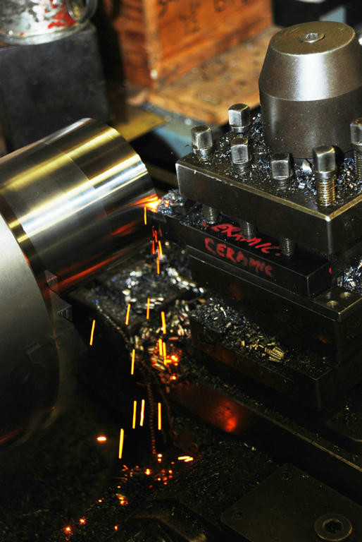

If you study the photos you will notice there are sparks flying off the tool as I make the finishing cuts. The cuts were taken at 1200rpm (And this was on a 110mm diameter that's about 1360 surface feet per minute cutting tough carbon steel even the hard bits left by the welding were peeled away) As fast as my lathe will go using a three thou depth of cut and a feed of .002" and I got a very nice finish.... Using a ceramic insert! My neighbour is an engineer and he gave me a holder and some tips. All I can say is wow! the metal just fell away as sparkles leaving a very nice finish. if you get the opportunity to try a ceramic insert you will be surprised. Don't try this with a carbide insert it will not survive. Ceramic inserts do not like interrupted cuts they will chip my friend warned. And they do like speed. below 600 RPM the finish was not as good. I think its to do with the heat, the metal appears to be wiped off I guess its physics at work.
Over the weekend I hope to prepare the other half of the body......

BT 30 Spindle Front Half
Boring Pocket
Ceramic insert at 1200 RPM
4 75mm bearings will be used
Clamp is for vibration damping

No coolant with the ceramic toolbit?? Amazing cutting and finish.

I did not use the ceramic inserts for heavy cutting just finishing, the power requirements for finishing are smaller than you may think, at high speed the metal is so hot it is effectively wiped off. Coolant is not recommended due to heat stress on the tip.
