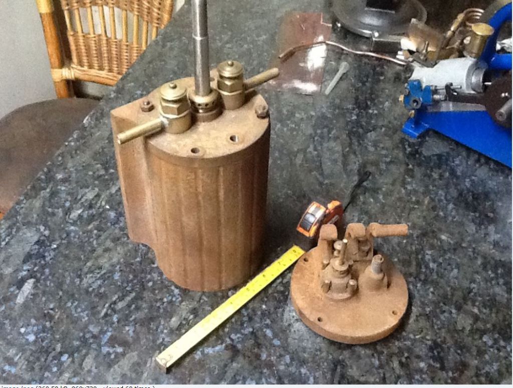

Posted by SillyOldDuffer on 25/07/2020 13:00:44:
Stage One: Gather Information, identify Risks & Issues, & Tooling
  1. How does the engine work? A. Brayton Open Cycle, issues for later: From Graham's description "Picture a canister filled with a pressurised combustible mixture of air and Town gas, a recipe for disaster if ever there was! Well this was exactly how the fuel was stored prior to combustion. At bottom dead centre the admission valve opens allowing the mixture to pass by a burning pilot light within the cylinder head. The result is an expansion of the Nitrogen that presses against the underside of the double acting piston. On the other side of the piston the air and gas that was drawn in on the last downstroke is being moved through a non return valve into the tank that forms the engine's beam support column. At a given point the admission stops to allow further expansion due to the heat generated by the flames. As the engine reaches TDC the exhaust valve opens and the flywheel carries the piston down both exhausting the power cylinder and drawing in a fresh charge of mixture in. The cycle repeats.... Well until sometimes the flames could pass the many safety meshes and ignite the fuel in the column!! The engine was fitted with a large volume safety valve to allow for this condition without an explosion of the cast Iron receiver." model will probably run on propane.
  2. Decide what the parts are. Many obvious, like cylinder, piston, flywheel, others less so. Is the bedplate/frame 1 part or 2? Is the top bearing block part of the frame or separate? Is the reservoir part of the frame or separate? Can the reservoir be cast into the frame directly, avoiding machining? Bedplate will be a separate casting, reservoir will be be formed bya core cast into the frame. Bearing block will now be separate so that a 50mm dia corepring can be used to support the reservoir core
Graham's cylinder, head and frame pattern with half a corebox along side
part of the top bearing yoke pattern I cut earlier today
I tend to draw to the size I want the model in Alibre including machining allowances on the faces that need it and draft angles where required then scale the model at the end to increase the pattern for shrinkage allowance. Fusion makes it a bit easier to draw the finished part then add draft and machining allowances before scaeing the shrinkage.

Delighted to see I've not got it completely wrong. This bad-boy has got to be the James Dean of Internal Combustion engines! Every home should have one!
I guessed wrongly the engine didn't have inlet and exhaust valves! The gubbins that works them must be round the back.
This clip from Jason's photo reveals what's on the mysterious bottom of the cylinder, which I was ignoring:
I now think the claw holds a rocker arm driven from the back of the engine, and the Inlet Valve is the spike thing. Still mot clear to me where the fuel connects, or how the flame works.
This is a fascinating engine, a nice mix of clever engineering and genius design, but with many early imperfections. Very inventive considering it's a piston engine based on the same thermal cycle as a modern gas turbine. (I'm sure Duncan is right.) I'd pay money to watch a few of these ticking over at an Exhibition.
