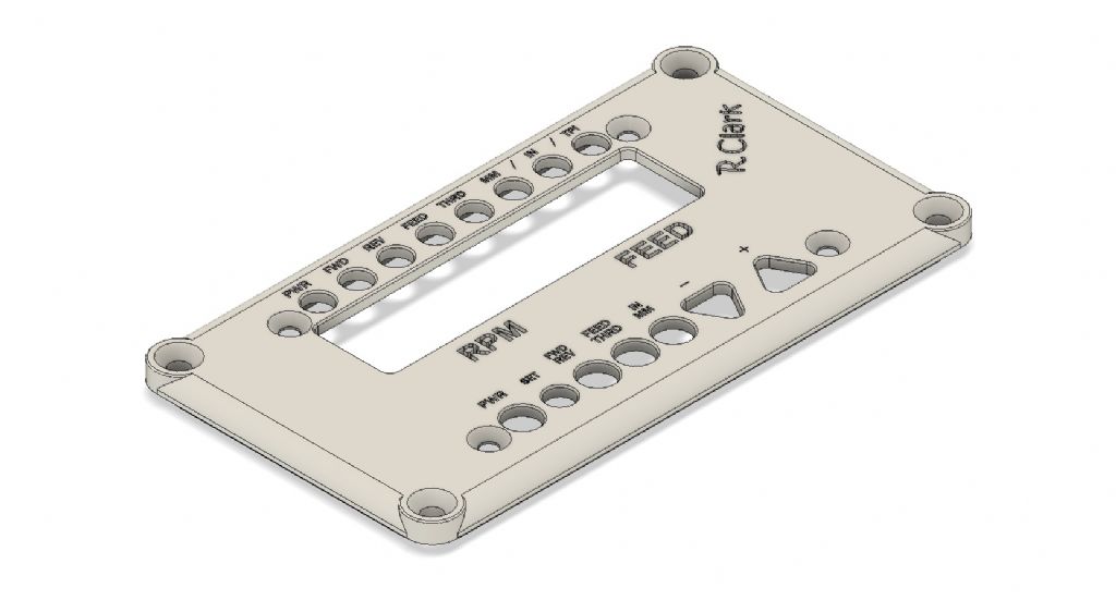

Rockingdodge27/01/2020 20:17:19
avatar
396 forum posts
111 photos
So I wanted to 3d print the lid but wanted to customise it to my requirements, to this end I downloaded Fusion 360 as it's a product that I wanted to learn so I loaded up the STEP file for the lid and over yesterday pm and this evening I worked out that svg files were the way to go so downloaded Inkscape and learned how to create svg files from text and here is the result:
I'm happy with it but haven't tried printing it yet, not bad for a 68 year old! devilwink

SillyOldDuffer27/01/2020 20:44:57
10668 forum posts
2415 photos
Posted by Rockingdodge on 27/01/2020 20:17:19:
Roger
Brilliant!!!
I've been struggling to do similar. Been getting mixed results from outputting STL from Inkscape and manipulating it with 3 or 4 different packages. I shall kick myself if the answer is to work directly from SVG.
Well done you!
Phil Grant27/01/2020 21:00:10
Roger
I did the same thing on my 3D printed lid in fusion 360 but when I printed it the text didn't come out to well, print it with the smallest layer height you can but it will take a lot longer to print.
Rockingdodge27/01/2020 21:23:11
avatar
396 forum posts
111 photos
Posted by Phil Grant on 27/01/2020 21:00:10:
Roger
Hi Phil,
I bought myself a resin printer so hoping that I can get good results on the fine detail.
Got priorities at the moment like re-assembling my mini lathe after stripping the teeth on the drive pulley, I also decided as it's in bits I'll fit dro as well so got that to do before anything else.
Roger
Rockingdodge27/01/2020 21:27:35
avatar
396 forum posts
111 photos
Posted by SillyOldDuffer on 27/01/2020 20:44:57:
Roger
Brilliant!!!
Well done you!
Hi Dave,
If you use Fusion 360 you can 'INSERT' svg file and then 'Extrude' either up for emboss or down '-' as I did.
This was the first time I'd used CAD, simples devil, just had to deal with sky high frustration levels sad
Roger
Phil Grant27/01/2020 22:29:13
107 forum posts
21 photos
Posted by Rockingdodge on 27/01/2020 21:27:35:
Hi Dave,
Roger
Roger,
I've been using Fusion360 for a couple of years and I never new you could do that surprise every day is a school day thanks for the tip.
I spent ages inserting and placing the text on the front surface sad.
Phil
Phil Grant27/01/2020 22:36:09
107 forum posts
21 photos
Posted by Rockingdodge on 27/01/2020 21:23:11:
Hi Phil,
Roger
Roger,
You should be fine with a resin printer the resolution should be more than enough, my Ender3 struggled with the small text above the LEDs.
Phil
Rockingdodge28/01/2020 10:24:16
avatar
396 forum posts
111 photos
Just found this Adafruit tutorial on creating a box, I found it easier to pick up than some of the others, lots of ways of stringing dimensions together to make adjusting easier. Adafruit snap fit cases
Roger
SillyOldDuffer28/01/2020 13:28:56
10668 forum posts
2415 photos
Posted by Phil Grant on 27/01/2020 22:29:13:
Hi Dave,
Roger
Roger,
Phil
Me neither; I'm moderately fluent in both Inkscape and Fusion and hadn't spotted that, despite looking! (I must have wasted a full week investigating alternatives that don't quite fly. Arghh!)
Ideally Fusion would be as good at text as Inkscape, but it only does the basics. Inkscape has many excellent features, but it's not a CAD tool. Nice to know there's a way of getting the two to work together!
