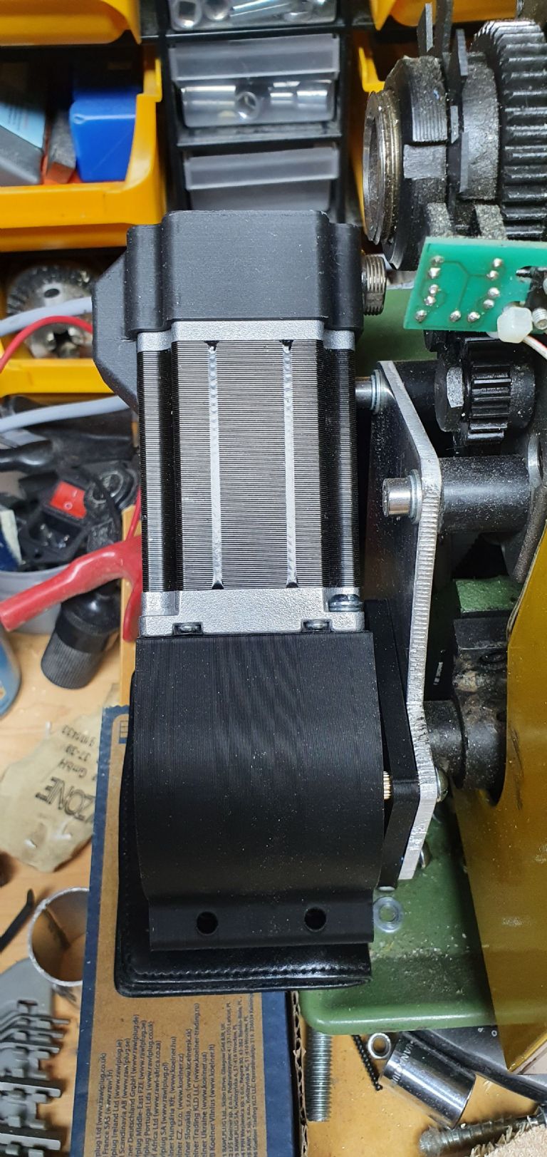

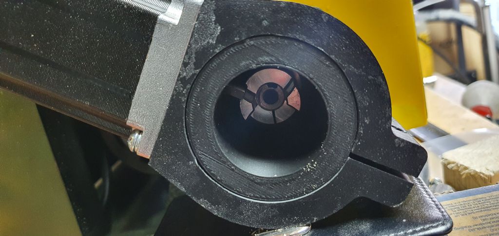

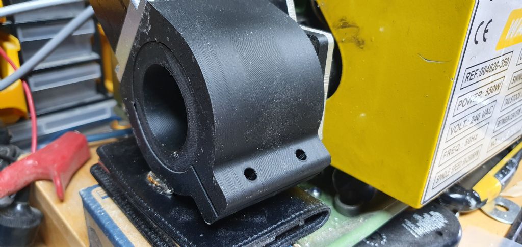

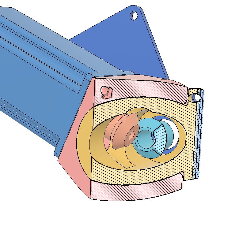

28/05/2020 09:54:27
Are you intending for the bevel gears to be enclosed within the casing?
Domestic chores are slowing progress but I'm drifting off the skew gears idea as I'm pretty certain the stepper motor bearings aren't too keen on the end thrust. My next iteration may contain bevel gears if I can squeeze it all in the limited space.
I'll also hope to be fitting my twist of the lead-screw thrust bearing.
Wish me luck.
Yes the gears are enclosed apart from the end which I plan to cover with a piece of perspex. The inner sleeve is fixed to the lathe bracket but the outer clamp slides around allowing for a variable mounting angle to clear the bits on the lathe.
Ofcourse, good luck with your twisting.

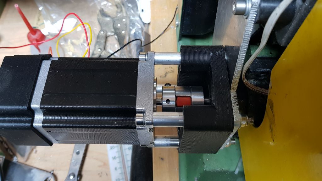

28/05/2020 09:12:35
Hi,
I've had my stepper mounted end on to the leadscrew but always wanted to have it at right angles but didn't want to spend the cash on a proper gearbox so I've been playing around with the idea of my own mount.
I ordered some "Mitre / Bevel" Gears from China for about £3 and did a design in F360 with the idea of 3D printing them, yes I know that the 3D printed parts may not be up to it but it's not going to cost me a lot to try it out.
Anyway i've got the first off prototypes printed and now just checking for fit. Here are some pictures just incase it sparks any ideas .... Still very much a work in progrgess though.90 deg stepper 1.jpeg
20/04/2020 10:12:15
Andy,
I think the layout on the W180 and 240 are quite different than my Mini lathe but you're welcome to use what I have, pictures are in my albums, I'm now looking at converting to a right angle drive arrangement to reduce the width of it all.2018-11-09 16.57.24.jpg
