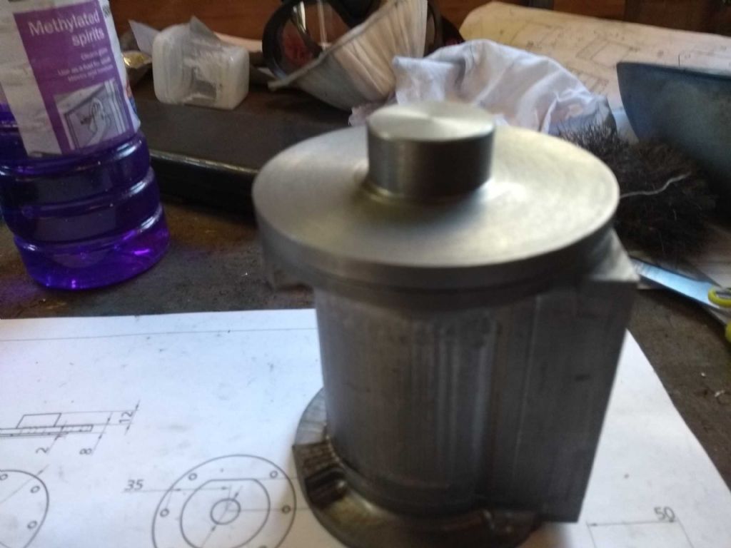

Being as my cross head / con rod progress is stalled pending parts for the little mill, I thought I'd crack on with the piston (whilst the lathe still works...).
Here we have the chunk of cast iron from which the piston and it's rings will be carver. I used a centre as much as possible throughout this process as the grip from the 3 jaw isn't great and the chunk quite long.

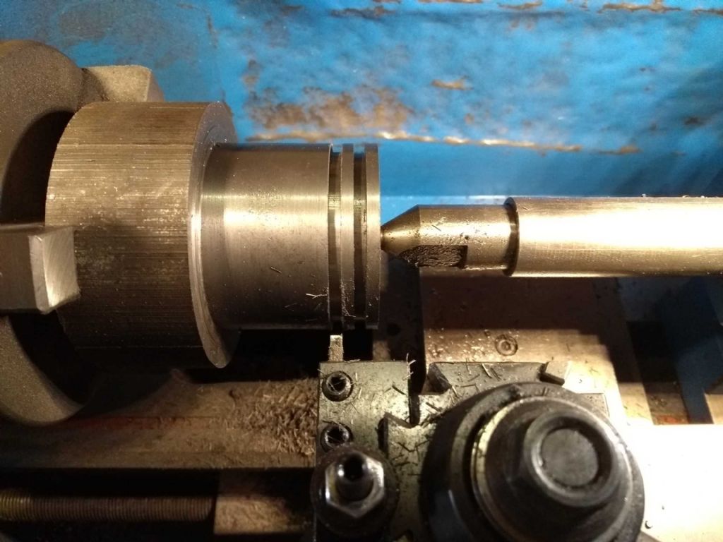

Having trimmed a bit down to a little over 50mm, I then made a grooving tool exactly (for me) 3mm wide.
Then the grooving.
A bit of chatter on this - no idea why and not going to affect the performance.
Then. Oh. My. God.
The parting off. For this I took some half inch x 3/16ths HSS (yes I know. Everything else is metric, but this is how I bought it) and added a bit of top rake and some side clearance. I added a bit more later (part way through) and this should have worked.
I was very nervous about the parting off. It's not an area I've had huge success with, though the QCTP made of steel rather than the rubber one (well Ally really) that I had before makes it closer to possible.
I tried to make sure the parting tool was dead on right angles to the work.
Not my best photo.
you can see some chatter in the groove here. This was a serious issue all the way through. What would happen is that as you fed the tool in it would not do a lot and then start to grab. Sometimes (not too often)this caused a jam which in turn would dislodge the piece from the jaws so I had to loosen push back and re-tighten. After a while I got used to the feeling for this and could pull back (mainly) before anything untoward happened..
Curiously, the cutting got easier the further in to the material I went.
I started off with the tool perfectly (for me) centre aligned, but after a little while dropped it by maybe half a mm which may have helped.
This was a very very cautious parting off. In fact it took the best part of an hour, feeding in a fraction at a time.
Phew!
Sadly, my lathe is not equipped with the means for a back parting tool.
IN the end this was reasonably successful. I've found that the parted end isn't exactly straight. It domes towards the centre. Also my adding up must be wrong, It's about 0.25mm too long. I'm thinking that I'll put it on a stub mandrill and shrink it back to the right size.
Next, the piston rings. I wasn't sure to be scared of these or not. My greatest concern was that I had to finish these to spot on the diameter of the bore. I actually seemed to have got pretty close to that so I'm quite pleased.
However, we start with yet more discarding of perfectly good metal.
LIke this
2.5 wall thickness with 3mm width rings. I started off with a reasonably chunky indexed carbide bar but finished of with an hss tool.
And finally, here we have a piston and three matching piston rings.piston done.jpg
If anyone things my maths is a bit dodgy, the word on You Tube is that these get broken easily when tempering or fitting, so I need a spare. In fact I probably need two or 3, but I didn't leave enough metal for this.
I'm really hoping I get my spares tomorrow and can get on with the con rod bits.

Iain Downs01/06/2019 17:50:32
976 forum posts
805 photos
Multi-tasking again!
Whilst my armchair engineering has been contemplating budgets and how to cut metal, my active alter-ego has been working on a couple of components.
The cross-head paused whilst the parts to fix the mill turned up. In the meantime I wondered what I could make next. I'd originally bought a piece of 50mm piece of 90mm cast iron bar for the cap. This was as small as I could buy it from Metals4U (I was buying a batch of bits). I was somewhat naive in retrospect for thinking there was any way I could cut a piece of round metal this size in half!
What I realised was that I had a bit of 100mm x 25 cast which I'd bought for some scraping practice - but how much happier it will be to be part of a motor, eh?
Here it is in my lathe.
I found this difficult to machine and I don't know why. So far cast Iron and I have been quite good friends, but this one didn't like me at all.
I did most of the cutting with an indexed carbide insert and found that I couldn't take more than about 0.25mm off or the lathe would stall. This is not a good thing.
I also had a lot of chatter / squealing so the surface was rougher than I'd like. It was also easy to have a jam and in fact I appear to have chipped (and discarded) at least one of the inserts.
I tried this at speeds from about 300 up to 600 and it didn't make much difference to the chatter.
Still, got there in the end.

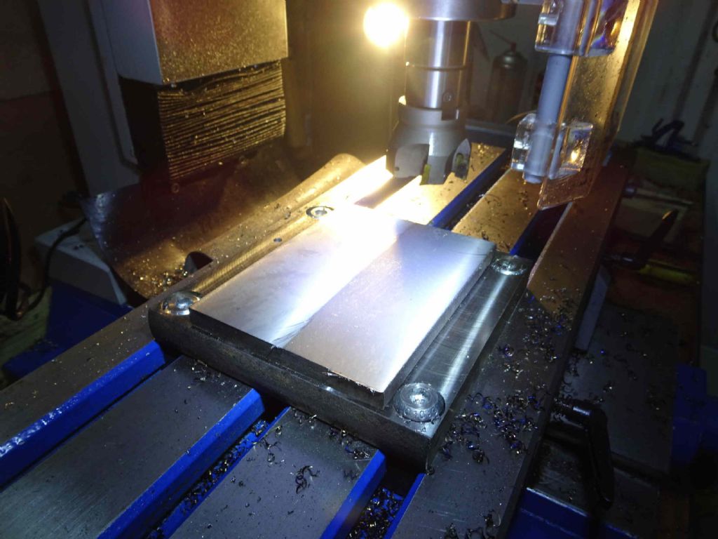

I actually started this because I was trying to be careful (!!!!) with one of my home made tools.
The mill was back in excellent working order so I continued to thin it down to 30mm.
next was to take a corner out - and to clarify this, here is a drawing of the cross head
I thought about setting to with the mill, but it really deserves a break and I thought - Ah- I can saw the bulk of it off and just mill clean!
Prior to purchasing my melted chop saw, I'd just finished making a home made version of it. It kind of worked, but not terribly well and I thought my 50 quid was well spent.
So I pulled it out and cut down the excess.
Having (maybe?) learned something about overloading DIY tools with work that's too big, I did this in careful stages, letting the angle grinder cool between cuts. In the meantime I got on with the top cap.
In the end (and with a bit of final help from a human powered hacksaw) I completed the cut and my mill was very pleased indeed!
I shall probably finish this off before getting back to the top cap.
Oh, by the way - Jason you agreed that threading the bottom end of the piston rod was a reasonable approach, but suggested a finer thread. As it happens I have a 10mm 0.5 pitch tap and die set. If I reduce the end to 10mm do you think that would weaken it too much?
Iain

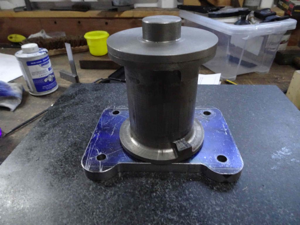

When I turned the piece round to hold the stub in the 3 jaws, I wanted to make sure that it was secure, so I set a centre against it.
Then turned the part down to 80mm and made sure it matched the cylinder (it turns out that one end external diameter is about 0.1mm smaller so I've engraved T on the side of the cylinder to make sure I get it right.
Following that took the thickness down to 7mm, and removed the centre and turned down the nun.
I then took 2mm of the face up to 50mm leaving a 2mm raised locating area. This was taken down to a measure 50 point something and then I used try and fit to get a perfect registration with the cylinder.
You can also see here the drilling out of the centre to allow the nut securing the cylinder to have some space.
And then trimmed to size.
And here we have the result.

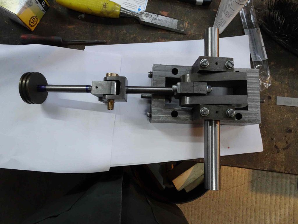

Back to the Well, I've had a bit of a run at work on the con rod assembly - which is nice, but it's going to make this post a bit of an Epic...
And it will be subtitled, 'Measure Twice, cut ... Oh Bugger!'.
You see, the cross head is basically L shaped. So I marked out where the L should be and then in a stupor of insanity decided I'd got the wrong end and marked again. Fool! It turns out I was right the first time. I started cutting and then had a moment. So I measured for a third time and compared to the drawing, said some bad words and took stock.
It turns out (fortunately) that I'd not gone to far with the cutting and was able to re-mark and carry on. In the drawing below you can see one of the false lines near the top of the G Cramp.
Although I took the bulk off with the face mill, I finished up to the edge with an end mill and trimmed the bottom at the same time.
Next was to make the radius for the bottom of the cross head. What I do here (are reported earlier) is to centre the rotary table on the mill and then centre the work item for clamping with a centre in the mill spindle.
Here I centre drill the part
And the centre
And then on with the milling
In this operation, the part moved (clamping not tight enough), but I spotted it before it was unrecoverable. Sadly in the process I grabbed an Y which I should have grabbed a turn and took a bit out of the side.
Next was to take 5mm of either side of the cross head proper
As follows
The shot above is also the set up for drilling the hole for a 10mm x 1mm threaded hole (threading not yet done, but tap has arrived!).
I drew up a design for the oiler hole, but when I looked at the part I found an easier way of getting something good enough (I hope).
As you can see just resting the part on the surface table leaves a perfectly good oil route as a vertical. So I marked that out, clamped the piece and milled a small hollow. Not shown here is that I ground a small groove in the clamping plate to keep it in place.
The drill through
It turns out that I'm being too loquacious and so need to stop here or the system tells me off.
More in a moment!
Iain
Iain Downs17/06/2019 21:02:16
976 forum posts
805 photos
And to carry on ...

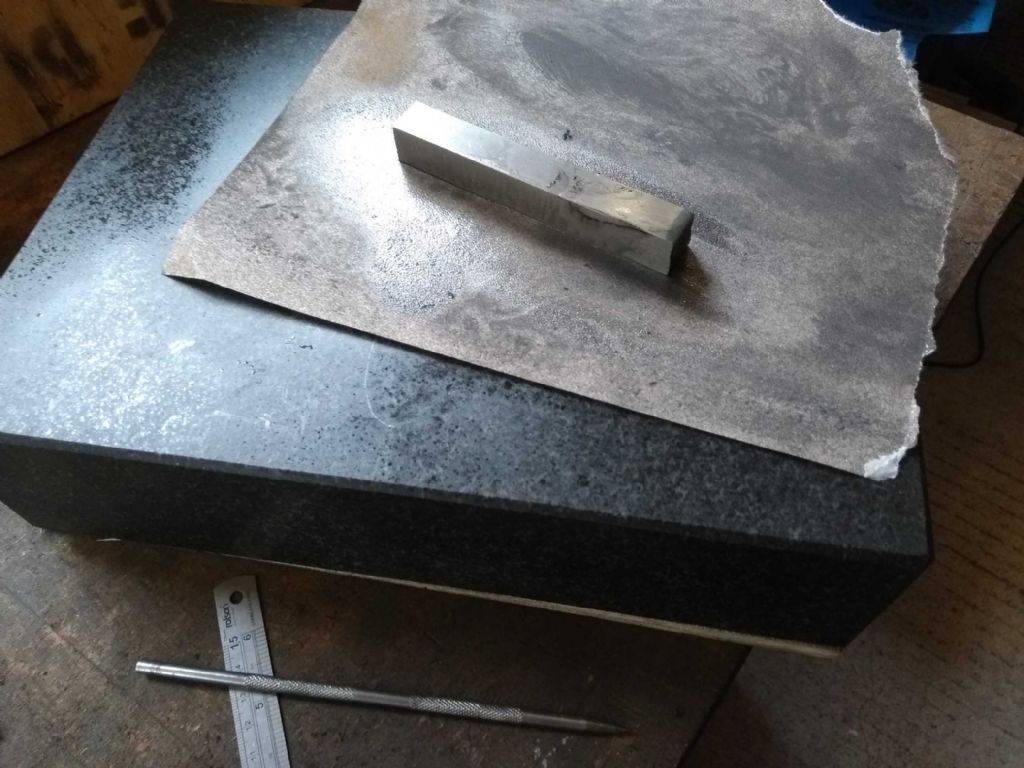

The next operation on this part was to be to mill a slot for the guide. However, before I got to that I wanted to clean up the rod I'd got for the guide. It turns out (I seem to be saying that a lot in this post!) that the 15mm square bar I bought at the show is a tad under 16mm. Rather than attempting to mill it down to what I'd drawn, I thought I'd just make the slot a little bigger.
However, the first step was to final and emery it reasonably square, straight and smooth.
Back to the Mill and cutting the slot. As I got close to 15.8 mm I took very fine cuts and started to try the guide.
I still need to cut the bronze for the cross head guide bearings, but I'd had enough of this piece. It's probably the most complex piece of machining I've ever done and surprised I got (nearly) to the end with out breaking it!
So I took a nice refreshing rest on the lathe.
This was to machine the bronze pin which would act as an axle / bearing for the cross head.
As usual, I had a bit of metal too big and needed to lose most of it .
a 25mm piece of bronze which needs to be turned down to 10mm, Mind you with a 20 mm head on .
And here I part it off. Parting of bronze after cast iron is such a pleasure!
You may notice by the way the profligate use of marking blue in this post. The marking blue was a purchase at the show and a welcome one. I've been using a sharpie (per advice in this forum) which is all very well when you don't want to do much. But a few wipes with cutting oil and it disappears leaving you none the wiser where to cut. This stuff stays on very nicely, but still can be cleaned off with a but of meths.
And here is the finished product after cutting a thread for the bolt.
I was originally going to file a head on this, but it seems a shame to take away the purity, so I may get my slitting saw out instead.
Never fear! The end is near! Only a little bit to go and this is the bit that goes below the cross head. I've no idea what people who have a clue call it so I've called it the cross head con rod. The bit tha the pin above connects to the cross head and which then goes down to the crank.

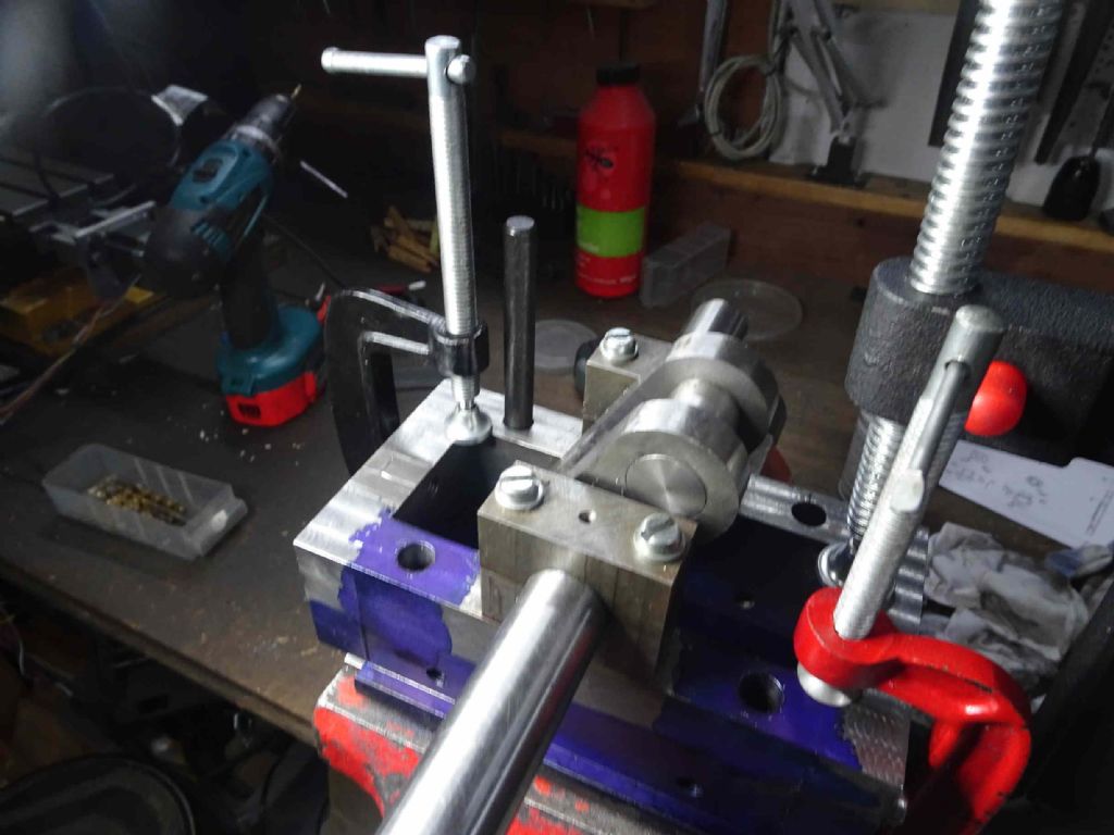

The main lesson from this is to clamp better.
Here was my first clamping arrangement.
It survived about 5mm of cuts and then the cutter caught, then clamps went sideways and the motor quite. Just the overload light and a pretty common affair with this build.
A bit more thought and care ended up with this.
You can see on the left of the piece where the cutter went mad on it.
And as you can see above this arrangement meant I got to the end with no blow ups. Also I could position the piece back accurately when I took it out to measure the base thickness.
The observent will notice little squares at the base of the cut. My intent was to finish the cut with a ball nose cutter to provide relief. Sadly, I'd not taken into account the length the bit would have to stick out and the (carbide) tool went was part way through one side.
This left me to finish it off with files with the result below.
It still needs a bit of cleaning up, but it's getting there!
Iain
JasonB18/06/2019 06:58:34
avatar
25215 forum posts
3105 photos
1 articles
Progressing well, keep up with the posts.
Will have to see how well that bronze pin holds up when you start running.
For the future a part like the conrod end two holes can be drilled first to get the corner radius, you can even stitch drill along the bottom and then saw down the sides to get most of the waste out before milling.
Iain Downs24/06/2019 20:52:58
976 forum posts
805 photos
Hi, Jason (and others, of course).
Today I had a bit more soldering practice and that turned out well. What I'm struggling with now is how to hold the parts of the con rod (big end connector, rod and cross head connector) in such a way that they end up at right angles.
I've thought of pinning them (or the second one to solder) or trying to make some sort of rig. I'm not convinced that just standing them up and hoping they don't move is the right approach!
I did think of drilling the corners as a starter but rejected the idea for no good reason I can now bring to mind...

So this week I've been finishing off the drive train. This is probably the wrong term, but i mean the bits from the piston down to the flywheel.
First off was to trim the piston down lengthwise to be exactly the right length, it being about 0.15 mm too long.
I have become a fan of wax chucks recently - with superglue playing the part of the wax. IN this case I had about 5 goes at making a stub mandrel and always seemed to end up a few thou too thin. I got bored and slathered some superglue on, with a nice bake at 250 degrees for one hour to free it.
I finally got my ER32 stuff working. In this case using a collet chuck which attaches to the face of the spindle not into the taper.
Here the 12mm silver steel rod is turned down to 8mm and then threaded. And, rather nicely, the piston fits on it!
Later I will clack it together with some threadlock and turn the piston down to exactly the cylinder width - but first I want to make sure all the parts fit.
The other end is reduced to 10mm and threaded 10mm x 1mm
This fits into the crosshead to allow some tuning of the location of the piston and here is the whole connecting assembly put together.
And even more remarkable, the whole powertrain (as I'm calling it)!
Next step is to make the lower cylinder plate and the supporting pillars. I'm hoping to start on that today, all being well.

Starting off with a piece of 100 x 130 x12 EN1A.
This superglued to my base plate and then skimmed - as well as wanting to get it flat, the plate is also 12mm and needs to be 10mm - Metals4U had no 10mm in stock.

A good weekend. First time in ages I could be in the shed with no heating and the door open. More of that to come I hope!
The main thrust this weekend has been to complete the bottom plate of the engine. The cylinder sits on it and is supported by some struts above the crankcase.
I started on this some posts (and months) back, but didn't want to do the lathe work until I had a piston gland to try fit as the other way round just wouldn't work.
I've become fond of the superglue chuck, though I still have some issues with release and heat. I have some blue masking tape, but haven't used it yet.
I seem to struggle with interrupted cuts - which this clearly is. I suspect I would be better off using HSS tools as the carbide tools used here seemed to chip easily.
I also had a nasty few moments with fairly horrid grinding noises coming from the lathe and the spindle showing hesitations. I was terribly afraid that I'd broken the change gears which, frankly would be a nightmare, despite now having specialist tools to remove and replace.
It turned out that the motor had worked loose and the timing belt was loose and slipping raggedly. Not fun, but much much easier than a gear replacement!
Still it worked in the end and the results were pleasing
And this with the piston gland in position. I've not decided if I want to attempt to solder this or to glue. Soldering feels nicer, but it's a big chunk of steel.

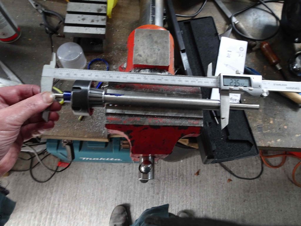

As I mentioned above, the attempt to get the right inside (leg length) dimension by measuring down from the ends didn't work particularly well with nearly 0.5mm variation between the 4 legs. So I popped them back in the collet and took a bit more of each and ended up well within 0.1mm - 4 thou. For god's sake, they're only legs!
And here it is. With a little imagination you could believe that one day it will grow up and become a steam engine!
