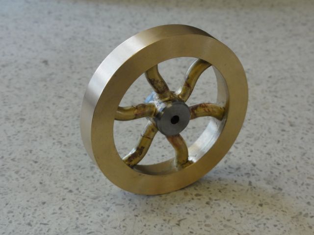

My latest project is the Popcorn Engine designed by Stew Hart. One of the reasons I was attracted to it was that it lends itself to a bit of "bling" and part of that is the curly spokes in the flywheel. They looked a bit tricky, so that was where I started. After a couple of failed attempts I devised a way of making the spokes to a consistent shape and the result is:
Just remains to add a bit of filler round the spoke ends at the rim, a coat of bright red paint and polish a shiny finish on the rim and it's onto the next bit, the cylinder block.
