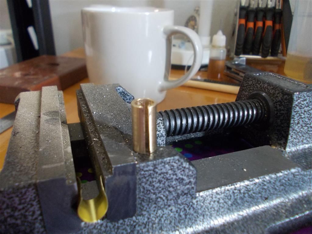

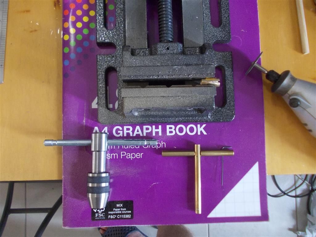

I had intended to drill out the holes for M4 grub screws and use a solid bush then I remembered that in order to tap the holes on flywheels I need a special tool. My usual tap wrench will not let me get in close enough. A few months ago I made a brass tool to take M3 taps which can be seen in photo #1 below but I did not make one for M4 taps. (The taps are held in place with M2 grub screws.)  I decided it would be easier to split the bush then to make another tool and I did that using the Dremel tool.
The bush was a tight fit in the FW hole so I knocked it in with a piece of wood remembering to insert the split between the grub screws.
It all looks good but it is a bit tight for the crank ; I can only just get it on but not all the way. I might have to polish (800 grit) or drill (6mm) the inside of the bush to get a better fit. The problem is that using the external jaws as I did to hold the inside of the FW rim, then the jaws are almost fully closed up. The drills cannot be inserted all the way through the FW or they will hit the almost closed chuck jaws ; they only come out the other side about 10mm. A 6mm stub drill would have been better but I did not have one at hand. I have ordered one for future jobs.

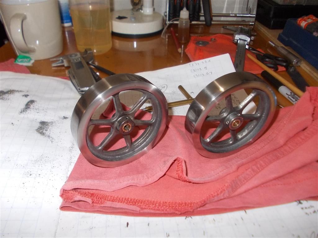

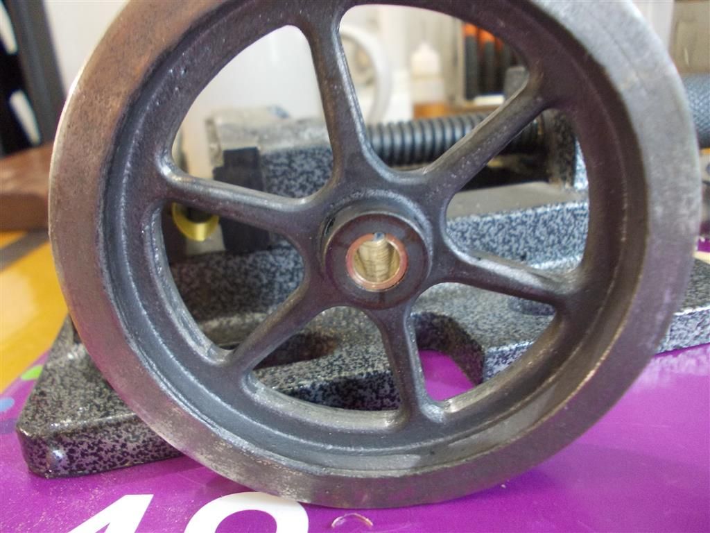

Both flywheels have now been bushed and polished. It is much quicker when you start with 120 grit ! I am not entirely happy with the FW that has the crack in it. If it did not have a crack then I would give it another light machining but I am worried about the structural integrity of it. Depending on how deep it is, that crack could be why I have had so much trouble dealing with this FW compared to the other one. Anyway, I have a replacement FW on the way and I now know how to machine it. I might even give the face plate another go.

Good to know the 120g worked for you
It is possible that the flaw extended into where you were drilling the hole and that would have thrown the drill/reamer off line.

Ian S C15/06/2016 11:07:32
avatar
7468 forum posts
230 photos
Brian it's probably better to hold the bush in the vice at 90* to what you have, ie by the ends, then it won't tend to close up as you make the final bit of the cut which if you are using the Dremel would mean a broken disc. My special tap wrench for getting in difficult places is a 4" Crescent spanner. Ian S C
Brian John15/06/2016 11:17:32
1487 forum posts
582 photos
I see your point about how the gap will close up as I get to the end of the cut.
Do you mean just to hold it by the ends but only 1/3 of it in the vice ?
JasonB15/06/2016 12:01:02
avatar
25215 forum posts
3105 photos
1 articles
Much like this Brian but with the slot facing upwards
Brian John15/06/2016 12:10:14
1487 forum posts
582 photos
Of course, thank you....I just couldn't see it before. I will do it like that next time.
