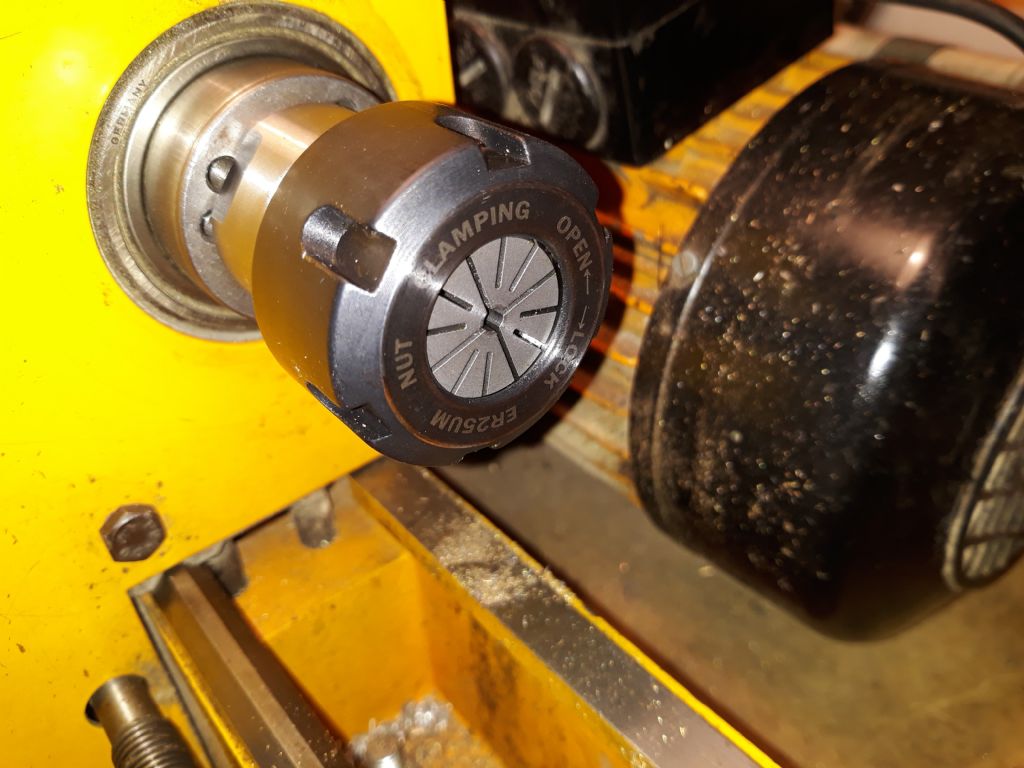

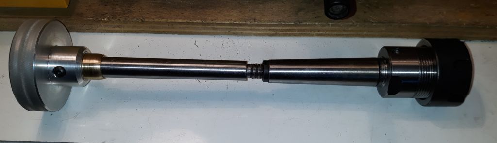

Small improvement for my lathe - took me a few days as I had to order some material for it. I have some SX25 collets, which I used for milling on the vertical unit of my Emco compact 5. As I have since a few years a Sieg SX2 I practically do not use them.
For the lathe itself I didn't purchase a collet holder. As the spindle has an MK2 cone I purchased a cheap MK2 collet holder. I had to manufacture a draw bar to hold the MT2 collet holder securly in place.
I have to say - even it dosen't run dead true - It is a world better than my 3-jaw self centering chuck and I love it for small diameter pieces. 20210218_170048 (2).jpg
End of the drawbar
The whole thing outside the spindle

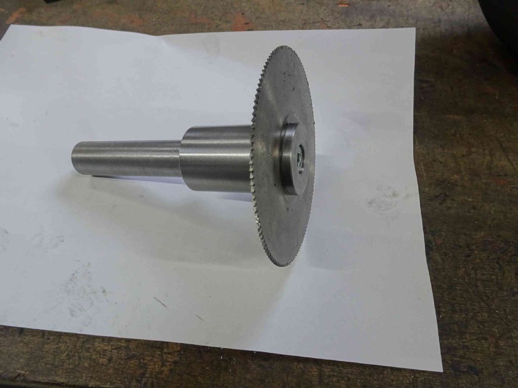

Expansion-links... Not knowing how you were doing it, I don't know the sticky-tape and glue technique but my thought is to drill the eccentric-link holes in the blank, and use them to screw it at the appropriate radius to a suitable plate secured to the rotary-table (Their radius exceeds that of the table.)
Without a rotary-table one way - and an alternative I am considering for myself as I have this problem coming up - may be to make an "arc table" from a length of thick bar or plate. This rotates around an arbour that is basically a large-diameter T-nut stud, and driven by a screw working through suitable brackets etc. on the outer end.
I like that slitting-saw arbour but how do you prevent the cut closing up and jamming the saw by the action of the clamp-bolt, as the saw breaks through?

Thanks, NIgel.
The sticky tape and glue goes as follows. Clear well both parts. put some masking tape (I went out and bought some blue philips because someone said so, but it turns out that was what they had not what was needed) on one both surfaces. Apply super glue to the non-sticky side that's up. Push the parts together (tape to tape) and let it set.
It's a variant of the superglue chuck, which is a variant of the wax chuck. I like the tape version (in principle) because you don't have to heat up the parts to break them free. In this case I suspect that the part got warm with the milling - or perhaps I should have taken a lighter cut. Who knows. But I think it's fine to drill / ream with and hten I can bolt it together
I do have a rotary table and started of by mounting the plate on some scrap aluminium and drilling / reaming / slot drilling some registration holes as can bee seen below
As you can see I'm a measure once drill twice sort of guy ....
I've cut another blank and we basically get to the same point and then I will bolt the two eccentric rod holes firmly to the ally. My other challenge is that the centre of the MT3 spindle and the centre of rotation of the table are not in the same place. We're talking 2 or 3 thou here which not going to affect this piece, but it's nice to be try and get it spot on.
The arbour cap has a 22mm protrusion onto which the slitting saw fits. This slides into a receiver on the main body and the two are clamped together with a cap head bolt in a counterbored hole.IN effect there is the same clamping force as on one of those arbours which are far too long and with a long thread protruding with a massive bolt.
This may make a bit more sense.

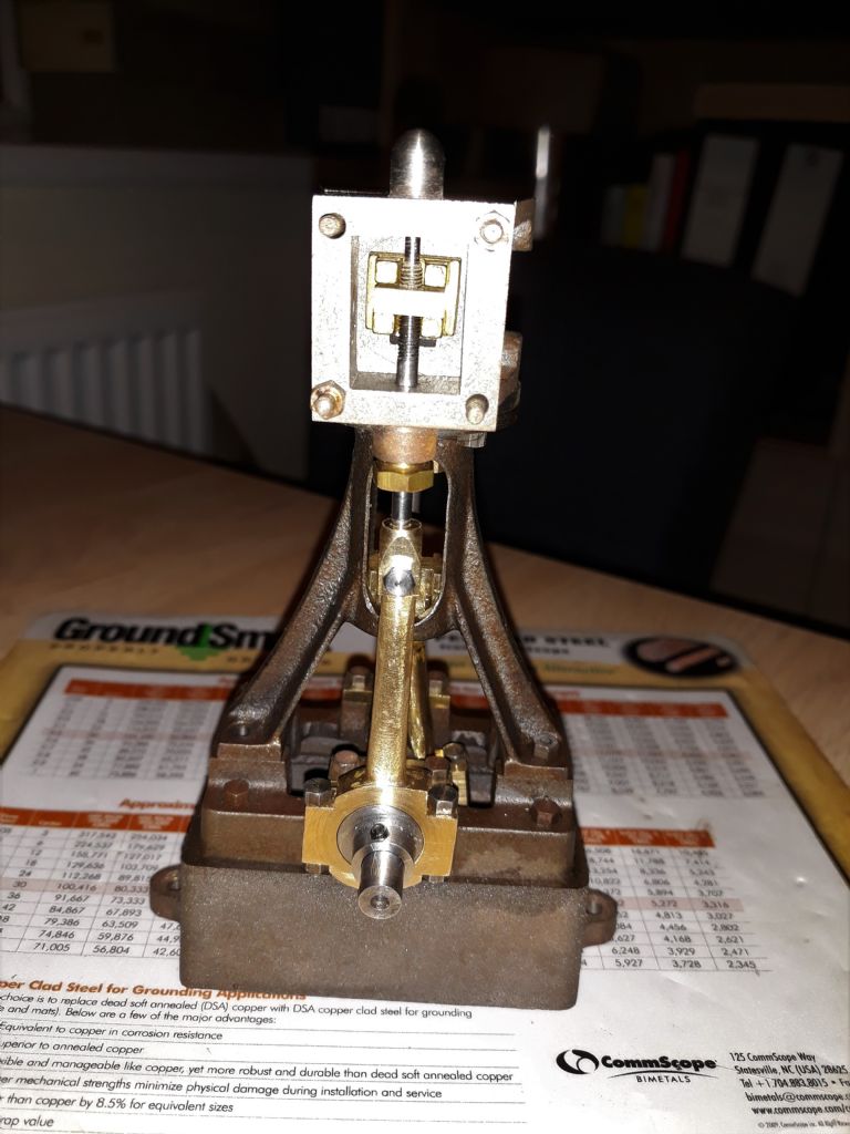

Played around with my late fathers Stuart 10V, I am almost there. Made the cylinder cover from brass sheet, drilled and tapped for drain cocks. Removed rust where possibel. Finally I painted what needs to be painted, and hopefully tomorrow I can start to put everything together. 20210217_175846 (2).jpg
