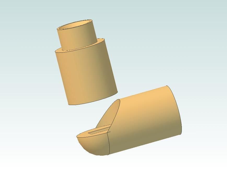

I wasn't planning to make a mitre joint, but one like this:
All that's needed after silver soldering is a quick clean up of the joint and drill out of the holes to depth. I'll probably use a short threaded spigot on the vertical part to hold the halves in alignment. The thread will disappear when the holes are drilled to depth.
The only thing I'm not sure about is part of the silver solder joint being in tension rather than shear.
Andrew
