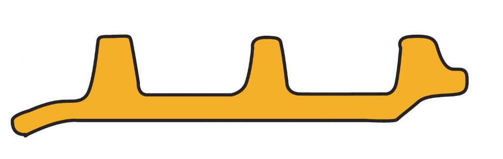

John McNamara27/10/2013 23:57:58
avatar
1377 forum posts
133 photos
Hi Rebekah
I had a look at David Jupp's Link. The tracks for excavators do look similar to your posted image. I selected one B114 for an exercise.
I screen grabbed the profile.
Then imported the image into AutoCAD as a background to trace on
Then traced over the image with a polyline (and closed it)
In order to be able to see the trace line I set the transparency of the imported image to 70%
b114 extruded.jpgFinally the image was extruded
You can then scale the object to the size you want it is better to trace first then reduce to increase the accuracy of the trace.
The track drive image would be a good contender for tracing

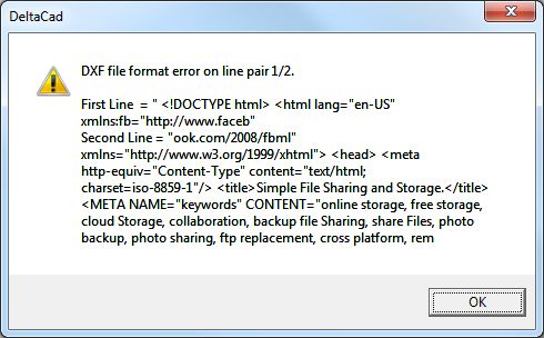

Hi Rebekah
**LINK**
Try opening this DXF file (I saved it as an ACAD 2000 format)

John Stevenson28/10/2013 08:34:23
avatar
5068 forum posts
3 photos
Posted by John McNamara on 28/10/2013 01:28:21:
Hi Rebekah
**LINK**
John,
Can't open this it has an error in it.
Seems like it's incorporating the hosting information in the dxf.
Tried it in a few programs and it barfed out in all.
Ironically the cheapest program, Deltacad gave what the error was,. All the other just said error and stopped working.
blowlamp28/10/2013 08:56:13
avatar
1885 forum posts
111 photos
It opens as a good solid with page info in ViaCAD, but only as the drawing page outline in MoI and CamBam opens it as per MoI but with text in the lower right corner.
It looks like 3d DXF files aren't handled by some CAD programs correctly.
