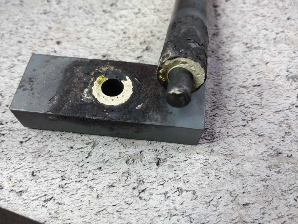

I suck at soldering.
I wanted to do some practicing before I messed up some precision (!!!) crafted pieces of the con rod assembly.
So I turned a rod to match the con rod and made a piece the same size as the big end bearing connector.
But I cannot make the soldering work.
I have some insulating breeze blocks (I forget the type, but the ones recommend in this forum) for my hearth. Having been told that my B&Q torch wouldn't touch anything much bigger than a ring, I bought a Sievert torch kit (with a 2941 burner - 7.7kW apparently).
This is the part after an unsuccessful attempt to solder
I'm using 455 solder which has a relatively low melting point and I think that despite the investment in the torch I can't get it hot enough quickly enough. Even spending 5 - 10 minutes heating it up, it's still not hot enough to melt the solder when the solder is touched to the red hot metal.
I first tried it with the parts in a 'normal' orientation (rectangular bit down on the bricks) and then as you see here.
I don't know if I'm not adjusting the torch correctly. The flame isn't quite the neat cone I would expect - though it seems a bit erratic - perhaps something needs tightening or cleaning (but not today).
I suppose I want to check that I should be able to solder a piece of this size with the equipment I've got. If not then I need to rethink the design (super glue and pins?).

JasonB16/05/2019 17:17:23
avatar
25215 forum posts
3105 photos
1 articles
Should not be a problem with that torch/burner combination.
What flux did you use?
What regulator have you got on the bottle and what have you set it at?
Edited By JasonB on 16/05/2019 17:21:56
Iain Downs16/05/2019 20:48:42
976 forum posts
805 photos
I used the flux that CuP provided with the solder and torch.
This is the regulator.
It's set to 5 - at least the number pointing to me is 5.
Many thanks
Iain
JasonB17/05/2019 06:59:41
avatar
25215 forum posts
3105 photos
1 articles
Did you get one of their starter packs? if so it was more than likely their "EF" pack", you would have done better with the HT pack or some HT-1 flux as this will be better for any jobs that take longer to heat.
Looks like a high pressure regulator so should have been giving a reasonable amount of heat at the mid setting, try it on the max to see if your torch burns more, it may not as the jet in the torch will be the limiting factor.

Posted by Iain Downs on 16/05/2019 20:48:42:
This appears to be the same regulator: **LINK**
https://www.bes.co.uk/propane-high-pressure-regulator-050-to-4-bar-9308
But I can't see the pointer on yours dont know
Edited By Michael Gilligan on 17/05/2019 07:41:31
JasonB17/05/2019 07:45:38
avatar
25215 forum posts
3105 photos
1 articles
Well found Michael, if Iain's one is anything like the link then the pointer is at the bottom of the label so pointing to 0 or 1 which would be a bit low!
Iain Downs18/05/2019 15:57:20
976 forum posts
805 photos
Who would have thought it?
You have to turn the gas ON to get a soldering torch to work! Well, well - you learn something new everyday.
I do feel like a bit of a plonker to be honest, But I am truly grateful for my muses who have helped out and managed it without pointing out that I'm an idiot (I wouldn't have managed!).

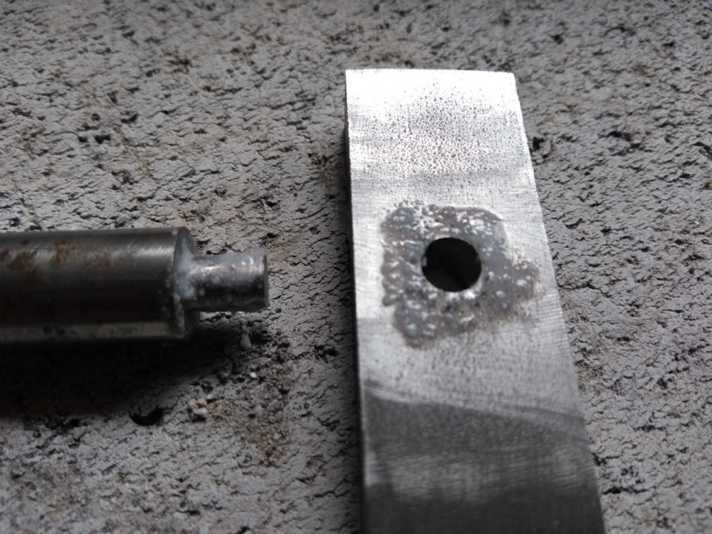

Iain Downs20/05/2019 09:04:53
976 forum posts
805 photos
My soldering still sucks.
Here is a charming little travelogue of my adventures with a simple soldering task.
The Solder

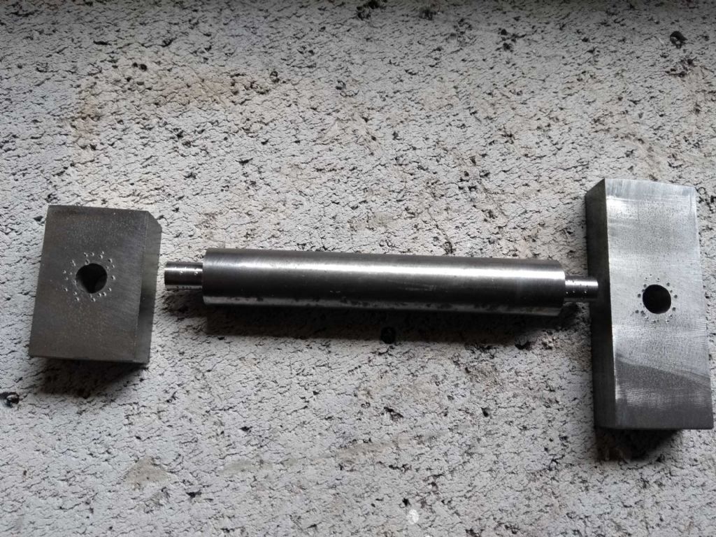

The Parts. The rod is 12mm, the bar is 10x20.
You will notice the dimples. One of the debates in the forum is if you need to use a centre punch to make little dimples to make sure there was space for capillary action. I have no idea if this is a good idea or not, but it kind of made sense.
The the fluxing. I'm not terribly happy with the fluxing. 'Consistency of cream'. Cream this lumpy would go down the sink. Not sure How I can get it smoother or stickier.

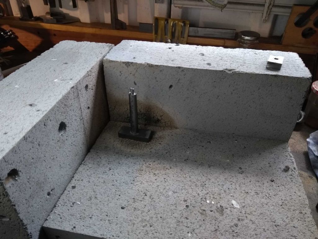

This is my hearth
and I warmed it first

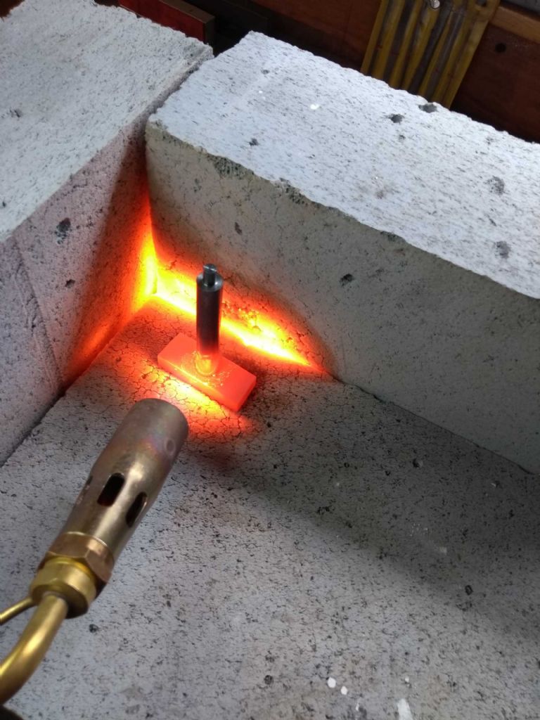

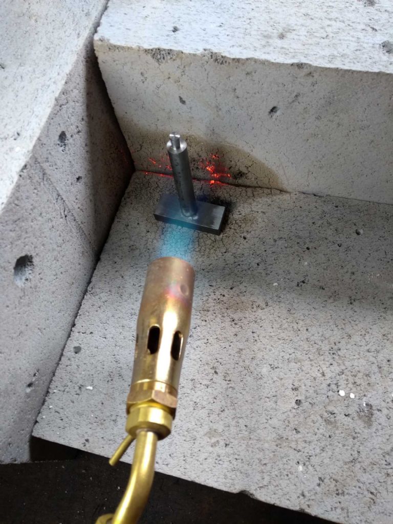

Then blasted away. I was expecting a more defined cone on the flame to be honest, though I'm not quite sure why.
The above is about where I gave up. The solder did not appear to melt when touched to the metal (but see later picture) and formed little blobs when I applied the torch. Between the first image with the torch and this was a little over 5 minutes. I do have a series of photos showing the thing heating up, but I don't really see the point of adding those.
I started trying to apply the solder when it started actually glowing and every so often thereafter.

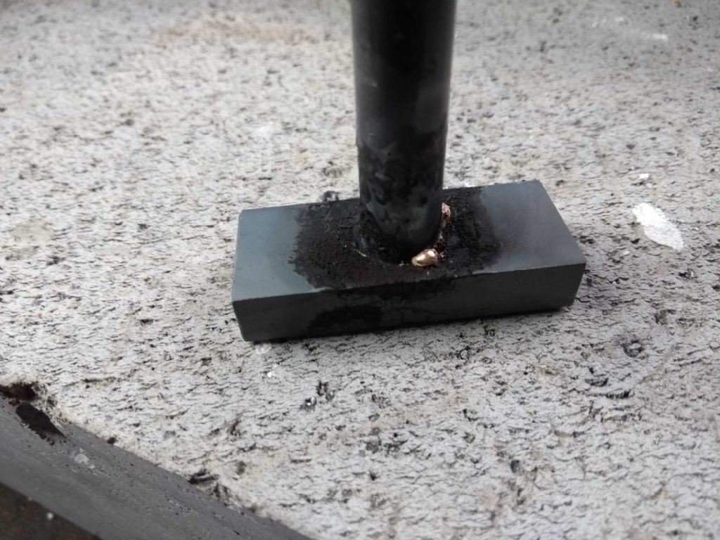

This mess is the result.
Finally I turned this upside down, but it in the vice applied a drift and a few moderate strikes with a small hammer slit it out as here.
It looks like some solder has crept in, but the joint strength is minimal and the solder has not run down the spigot at all.
This is the smallest of all the joints. the crosshead will have quite a bit more metal than this little bar so if I can't get this to temperature then that will be impossible.
Or am I getting it too hot? Or wrong flux. ARGGHHHH!
The joys of ignorance. Not.
As usual any help would be very much appreciated. I have the other end of the rod and another bit of bar just waiting for my next practice.
Cheers
Iain
