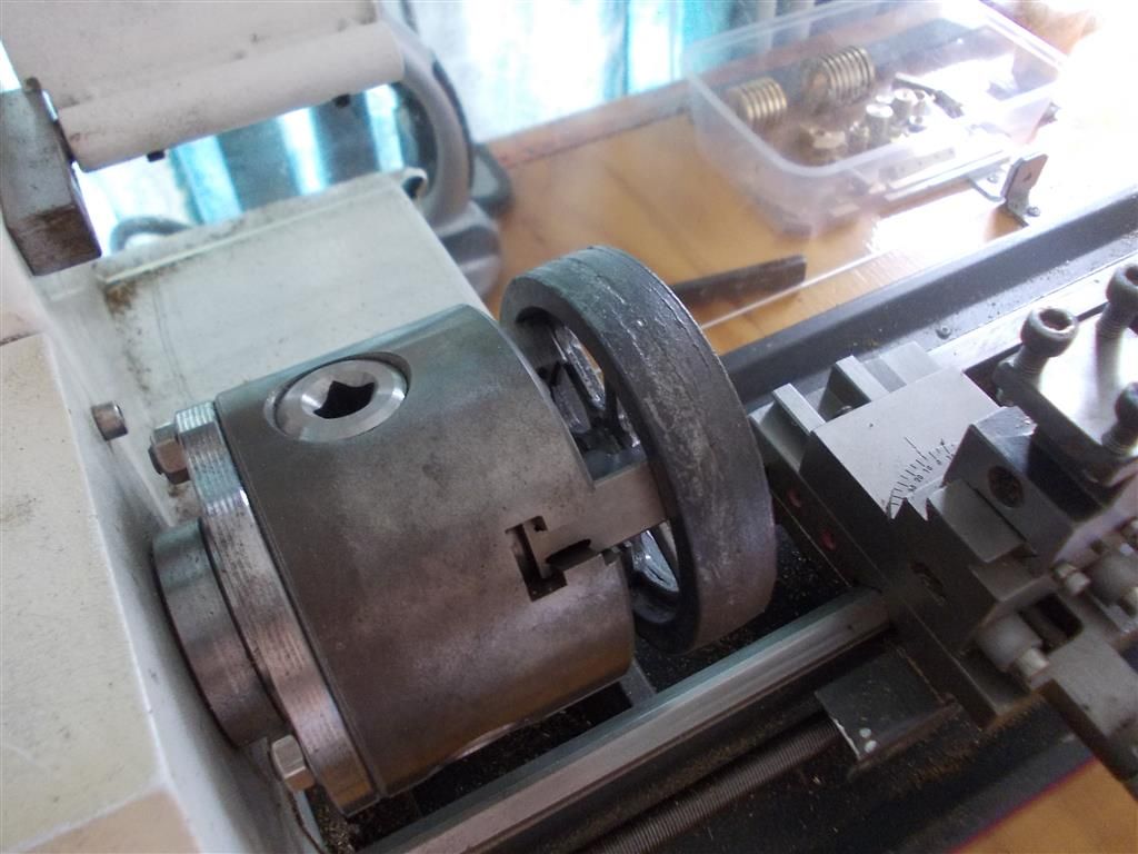

Is this a safe way to grip the flywheel by the inside rims using the flat of the external jaws ? It seems to be the only way I can get the wheel to run true. I only want to drill the centre hole before putting it in the mandrel.

JasonB03/06/2016 13:04:29
avatar
25215 forum posts
3105 photos
1 articles
It's probably as good as you are going to get. Watch out when with drawing the drill as that is when it may try to pull the flywheel out of the chuck, the rest of teh time the forces will be pushing it into place
Brian John03/06/2016 13:29:44
1487 forum posts
582 photos
Is it more important to get the out rim running true than the hub ? Ideally, both should be running true but if not...?

Andy Holdaway03/06/2016 14:51:54
avatar
167 forum posts
15 photos
Brian, bearing in mind that I'm a rank beginner at this, I would have thought that with your flywheel mounted as you have it you could drill the centre hole and machine the outside rim and face of the flywheel at the same time, then turn it round to do the other face. That way the centre hole and outer rim would be concentric.

JasonB03/06/2016 16:33:14
avatar
25215 forum posts
3105 photos
1 articles
Inner Rim as true as possible
As Andrew says if there is room bring up the tailstock ctr for support once teh hole is done then turn the outside or at the very least rough it out.

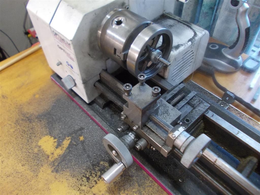

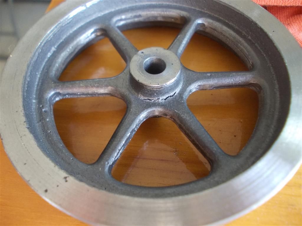

Well it was all going well and I was getting down to the polishing stage of the first flywheel when I noticed a crack. (photo 1). So I put that to one side and moved on to the other flywheel. I held it in the jaws as previously discussed to take a facing cut on the hub then drill and ream the centre hole. Even this caused problems because the lathe jaws are almost completely closed hence stopping the reamer from passing all the way through. I ended up finishing the reaming on the drill press later. I then turned the wheel over to take a facing cut on the other side of the hub. But for this second wheel I decided to use a mandrel from here on to machine the rims and outer surface (photo 2).
I do not think it is safe to do any more machining on that cracked flywheel. I really hate machining cast iron flywheels : they always seem to give problems that I never have with brass flywheels. On my lathe I can only take 0.1mm cuts at a time on cast iron so it takes forever. I can never get a decent finish like I can with brass so I have a big polishing job ahead of me tomorrow on that second flywheel.

Ian S C04/06/2016 10:44:17
avatar
7468 forum posts
230 photos
Brian, I don't think I wouldn't worry too much about the crack in the hub, some filler, and a coat of paint should fix it.  Its not highly stressed on a motor like this.   Ian S C

Brian John05/06/2016 10:07:21
1487 forum posts
582 photos
Ian : I was not quite finished machining it and I am not keen on doing that now. I might try polishing it up in its present state and see how it goes after I finish polishing the other flywheel.

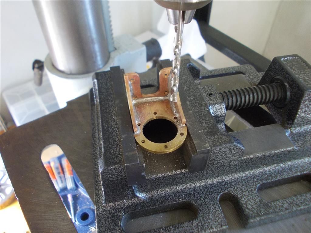

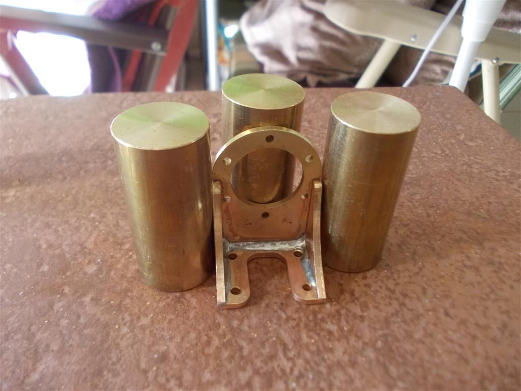

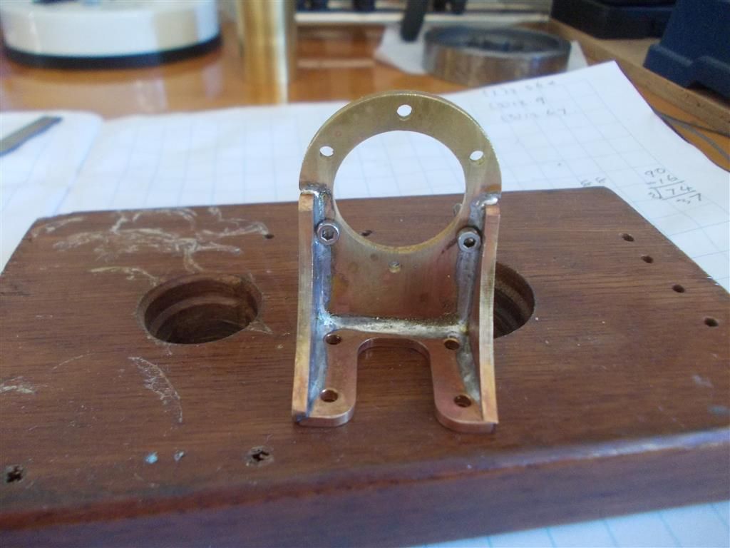

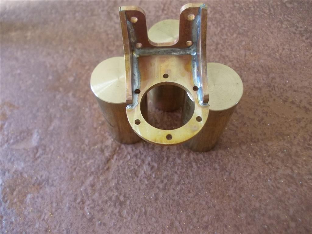

I made a start on polishing the good flywheel today but after a few hours I decided to do something else : soldering up part 19 (cylinder bracket).
I made a up a spring as per Jason's link to hold it all together but it just would not sit right. A closer inspection revealed that the left hand side recesses were not machined as deeply as the right hand side. I did what I could by rubbing it along the edge of a large file but decided to hold everything together during soldering by using pieces of brass. The brass cylinders were all oiled to stop any excess solder adhering to their surfaces.
I used 243 degree solder (photo 1) along the bottom surfaces before cleaning in the pickle. Then I cleaned up the brass again to solder the rest of it using 188 degree solder (photo 2). I had to use a 3mm drill bit to remove a bit of solder so that the M2 socket head screws would sit flat (photo 3). The finished product is in photo 4. I did think about using small pieces of brass angle to reinforce it all but there is nowhere to put it. On the inside it would block the insertion of the M2 screws and on the outside it would block the screws for the bearing cases (part 13) so in the end I had to let that idea go.

Ian S C05/06/2016 11:35:36
avatar
7468 forum posts
230 photos
Make sure that the solder flows through between the bits of metal, and you don't rely on the fillets of solder, these have little strength. If I was building this motor myself, I'd probably make the frame from steel, and either drill and tap, and screw it together, or weld it, but that's just me, I'm a bit worried that the solder will let go after a while with the vibration of the motor running, and depending on the heat of the motor it might not be too long, it didn't take long for the steel fins on my motor to go blue with the heat, far above melting solder. Ian S C

roy entwistle05/06/2016 12:38:41
1716 forum posts
Brian Did you tin the parts to be soldered together before joining them ? There is usually very little fillet with soft soldering

Brian John05/06/2016 12:47:49
1487 forum posts
582 photos
No Roy, I did not tin the parts but I did use plenty of flux. Had I tinned the parts then they would not have fitted together properly. Do you think I should I do this again ?
The guy in Jason's link used solder paste for this. Would that be better ? The paste looks very useful as there is a huge difference between the initial melt temperature (221 degrees C) and the remelt temperature (343 degrees C). Had I know that then I would have used it.

Ian S C05/06/2016 14:24:08
avatar
7468 forum posts
230 photos
A good joint even if not tinned should when the solder is feed in one side should flow through the joint and be seen on the other side. Heat one side of the joint, feed the solder in the other side, it should flow to the heat. I do most of my soldering on this sort of stuff with a large (I think about 2lb) soldering iron heated with the gas torch, if you don't have one(or two) of these irons, use the torch. Ian S C

2. I spent all day polishing up the good flywheel without the crack in it then I remembered that I had not drilled and tapped for the M3 grub screw. So I carefully placed it in the machine vice, protecting the polished surfaces with strips of thin copper sheet. The drilling and tapping went well so I checked put the flywheel on the crankshaft by placing it in the lathe...it wobbles ! It runs perfectly well on the mandrel but it wobbles when I put it on a 6mm axle. I really do not understand what is going on here. I have used these steel mandrels to machine about 15 aluminium and brass flywheels with no problems so the mandrel cannot be at fault.
What went wrong to avoid such problems in the future and what to do about it now ? I drilled the holes to 5.8mm and used 6mm reamer as per usual.
JasonB06/06/2016 09:27:17
avatar
25215 forum posts
3105 photos
1 articles
Brian could be a number of things
Hole in the flywheel a bit oversize, different material can give different results when reamed
Mandrel not set true when you put it in the lathe, its usual to true up a mandel each time it is fitted into a chuck as they are not accurate enough to hold the mandrel true each time.
Grub screw tilting the flywheel
Brian John06/06/2016 10:13:11
1487 forum posts
582 photos
I have a feeling it is the last : grub screw tilting the flywheel. Now this can only happen if the hole is too big or the axle too small (or both) which allows this tilting to happen. I cannot make the hole smaller and I cannot get a bigger axle as they all seem to be 5.97mm. So I am not sure how to proceed from here other than to start again with a new flywheel.
As for what has caused this : I only have problems with cast iron flywheels wobbling so perhaps in future I should not be reaming cast iron out to 6mm. Perhaps drill to 5.9mm and see how that goes ?
