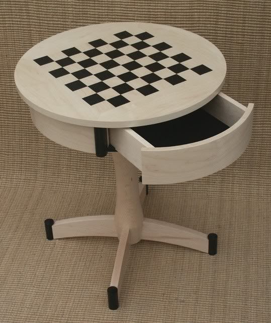

Agree any deviation in length even if only small will soon start to throw the pattern off, even consistantly butting the edges and ends together equally will be a challenge. Though more of a challenge wil be to do the T&G joints to ends and edgesdevil
I mostly use Titebond II for works and buy it in 1gal at a time, it also dries with less flexibility than PVA so is good for bent laminations. Their cold press glue is quite good for veneering and I usually use their PU for anything that may see the weather
The curved laminations and top were done with TBII on this, they are about 40mm squares of Ebony and Maple
This was cold press 24 pieces of maccasar ebony, about 1.4m dia, frame is steel also by me
