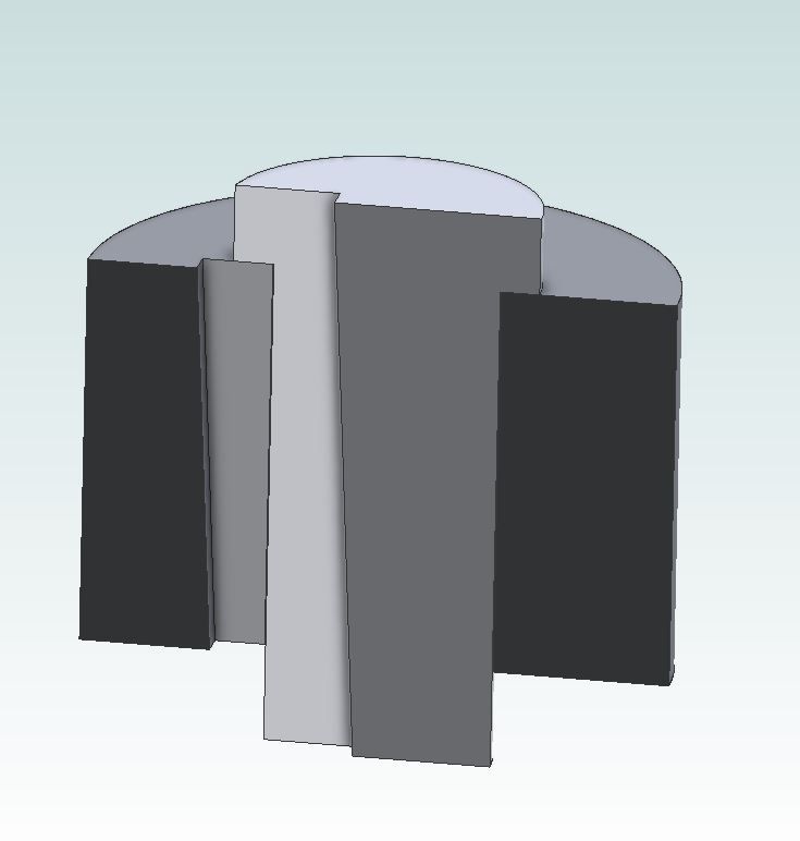

In the mean time for Paul and the Doc I have drawn it up with exaggerated taper so it's easy to see. Broach just has a few equal height teeth but enough to give the idea as it's only the last tooth that really matters.
Section with broach in place,
Section with broach removed you can clearly see the tapered slot in the bush and the broach will cut parallel to that and therefore give a taper to the keyway in the hub
This will give what is shown in Machenery's Handbook of matching tapered surfaces to key and hub keyway

Ramon, if you say you can't see how the broach will follow the tapered guide what makes it any different to the broach following a parallel guide and not drifting of somehow?
If I tilt the sketch so the exaggerated broach angle is vertical you should be able to see from the drawing that it is cutting a keyway that is parallel to the guide bush, I simply can't see what is different that may cause the broach to move away from the guide
Yes you could tilt the flywheel slightly so the broach is truely vertical but as I said at our sort of sizes the broach is so short the 75mm or so sticking out at the start of teh cut will only be 0.75mm off, thats 0.57degrees so I have not found it needs the work mounting at an angle myself.
Here is a square up against a 6" long parallel in a tapered guide a syou can see it's not far off vertical
As I said the angle in the sketches was exagerated in practice it is very small, this guide bush is 1.5" long and depth of slot varies by 0.35mm, hard to be exact one handed.

I'm not sure why you say it is not full size practice. Traction engines all tend to have a tapered key to hold the flywheel as do the many open and closed crank type engines and I dare say a few smaller steam engines too The Tidman Organ engine I modelled certainly had single gib head keys for flywheel and pulley on the real thing.. Maybe not right for a big mill engine but the info is now there for other model makers or Doc's future projects
The taper is nothing to do with the drive it is all about lateral location as there is nothing else to stop the flywheel coming off the end of the shaft. The taper being even shallower than say a Morse taper or that of a taper pin grips very well when correctly "fitted"
I think the set of three 1/16, 3/32 & 1/8 broaches I initially bought were good value, as I said more than 50 uses by myself and some leant out to others and no damage or signs of wear. These are just a Chinese set not name brand ones and I have something that I can carry on using for a lot longer
I can see that if you were broaching a much larger keyway there could be an increased risk of bending the broach away from the bush due to larger stick out and the forces needed but with these little broaches only being about 115mm long I've not found it to be an issue on the less than ideal "press" that I use.
Yes I drive the broach all the way through just like you would on a parallel keyway.
I do know of some that stop once the largest tooth just enters and have the key seat on the resulting stepped face of the cut maybe with a bit of filing. Not tried it myself but Graham Corry of Alyn Foundry fame does the engines he builds to order that way with several hundred under his belt many with twin flywheels and I'm told they don't fall off.
