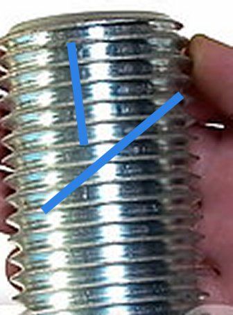

Posted by Martin Kyte on 21/08/2021 19:18:51:
No the pitch is set by the TPI of the tap. The approach angle of the cutting edge is set by the skew angle.
regards Martin
Since the original post was regarding using a tap as a hob I will continue to refer to the process of using a tap as a hob. This is clearly not a tap but a bolt but the point is the same regardless, if you change the angle of the tap relative to the axis of the blank you change the pitch of the resulting gear. As I said earlier there is no quick and simple way of cutting accurate gears.
Martin C
Edited By Martin Connelly on 22/08/2021 08:34:21

This is how I see it. In the same way that the pitch of the straight spur gear is dictated by the hob. The hob helix angle setting the set over angle. I agrre that the axial pitch of the helical gear will not be the same as the straight spur gear just by Pythagoras. However once you choose the helix angle of the gear you fix the set over angle of the hob. The pitch is then dictated by the pitch of the hob. You cannot just vary the set over angle to obtain different pitches. If you do you cease to generate an involute and merely alter the shape of the resulting teeth.
I'm not clear on how helical gears are specified but the pitch perpendicular to the helix (I would guess at calling it the helical pitch) will be the same as the pitch of the hob.
regards Martin

I've experimented with making a particular sort of helical gear - "helical lever" - which have simple straight sided teeth - they were used by a Victorian clockmaker and can realise large reductions in one stage as you can make one-tooth pinions. I believe that you can hob helical involute gears with a standard hob. From what I recall -
  • The "helical pitch" which is measured orthogonal to the teeth is the same as that of the hob.
  • The circumferential pitch is increased by a factor 1/cos(helix angle) so the diameter of the gear has to increase as well (as does that of the mating gear of course), by the same factor, to fit in all the teeth.
  • Looking at the tooth form along the helix angle it is involute because that's what the hob cuts. This is also what is "seen" by the mating tooth of the other gear which is also helical. It may not be the same as the profile of a cross-section of the tooth.
  • You have to angle the hob by whatever its own helix angle is to cut a straight tooth - for a helical tooth you add or subtract the helix angle depending on the handedness you want.

Posted by brian jones 11 on 22/08/2021 12:18:31:
For the follically scarified, note that the yellow gear has been flipped over 180 to make the red
But it does not work like that with a metal gear. simply flipping it over won't have your teeth running in the opposite direction, that is why I thought you may have a left hand tap or as John has shown will need to cut a left and rright helix pair and butt them together
Easy way to check it is to draw a diagonal line on the side of a disc or cylinder and then flip it over with line still facing you and you will see it is still at the same angle.
brian jones 1122/08/2021 13:38:49
347 forum posts
62 photos
OMG the Monsignor is RIGHT
10^3 apologies, I have flipped my gear blank wrongly????????. I will have to investigate
You do indeed have to angle the tap anti clockwise 11.4 deg for a 10 tpi (5.711deg ha)
GOT IT
My gear flipping created a mirror image which reverses LH to RH
Wow thats an easy mistake to make
