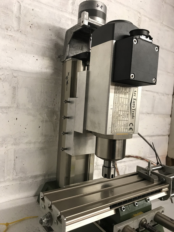

I've had a busy weekend in the workshop:
I didn't manage to run the CNC , but I did manage to re-spindle it:
Its all assembled, and the runout on this spindle is around 2 tenths with the same end mill as the proxxon one measured 2-3 thou. Speed should be more stable (and upto 24K rpm), and with the ER16 collets I can choke down to reduce the stick out.
I still need to check/fine tune the tram, and ensure the stepper is ok with the additional weight. I did a quick check before making the parts by cable tying this spindle to the existing head, and it drove that OK, so I think it should be fine.
Hopefully Ill be able to report success later in the week.
I'll also look at getting some different cutters if this moves ok - with ER16 I'm no longer limited to the 3.2mm max diameter, so the cutter selection should be wider.
There are pictures of the build on my twitter feed : @SolutionsByDave if anyone is interested.

Looks interesting. What is it?
Dave S29/06/2020 15:30:33
433 forum posts
95 photos
Many years ago I needed to do some very small precision drilling, so I bought one of ARCs ER16 high speed spindles.
That project got done and as part of workshop tidy the spindle got packed away for “later”.
I don’t think they still sell them, but similar spindles can be found out of China.
it runs of an invertor, 750w and 4-24k rpm IIRC
Bit overkill for this mill I suspect, but already in the workshop and should solve the runout issue.
Seemed worth a try for the time investment

Dave S01/07/2020 13:03:59
433 forum posts
95 photos

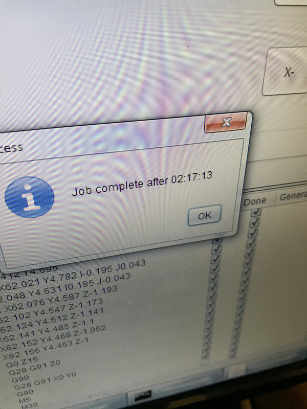

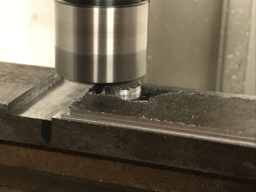

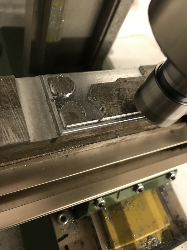

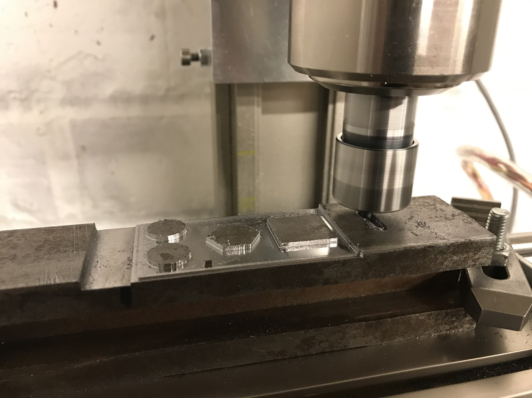

Good news!

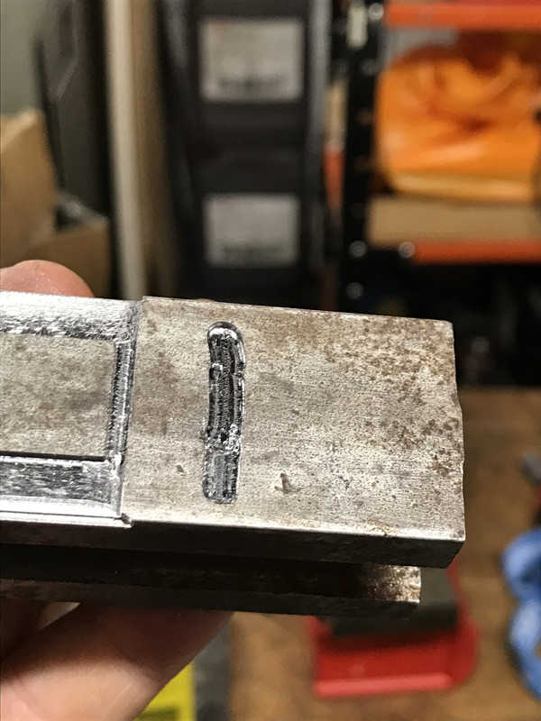

My CNC failed to snap my last 2mm endmill last night
The Job started:
and then it progressed some
As it was all looking good I even went and sat in the garden with a beer, keeping an ear out for the noise.
I was back to watch the pocketing process, as the rest of the cuts were small width, and this was the full width, after all the other milling.
took just under 2h20.
End result of the roughing pass:

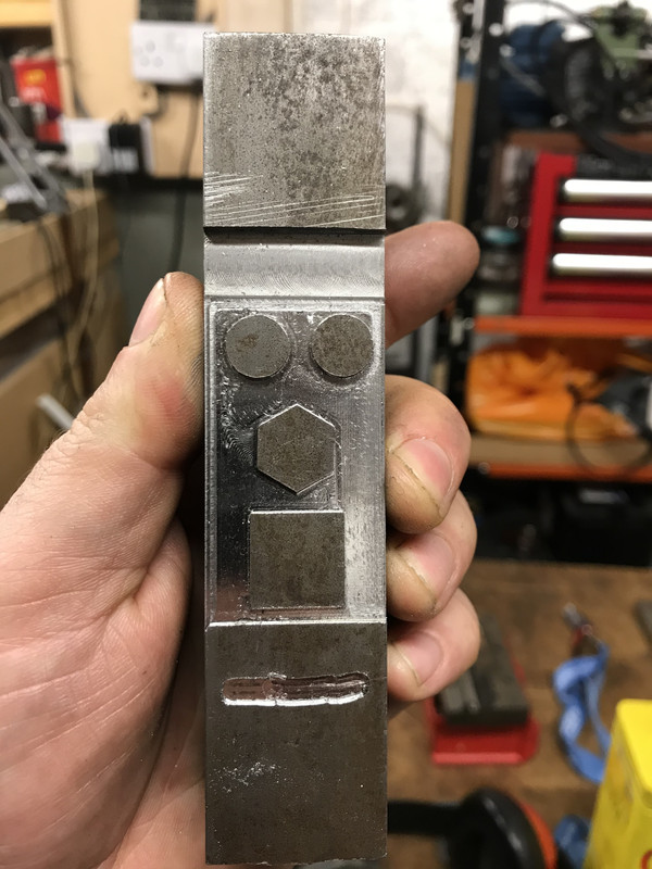

Somethings gone wrong here, the pocket is supposed to be a curve:
Turns out the recycled bearing on the X Axis has collapsed/ jammed.
Must have happened pretty much at the end, as the other shapes look OK.
That's why I took the stock off - cant run the finish on it until the leadscrew is sorted, which means stripping the table out...
Still, massive progress, and the new spindle seems to have made a difference.
I think its now in the 'tune' stage, rather than the throw things at it stage

JasonB01/07/2020 13:12:43

That looks a big improvement, did you have a similar amount of tool stick out or have some of the flute inside the collet?
It will be interesting to see how the raised features measure up once the final cut has been run.

I stuffed the endmill into the collet further - as I could do now its ER16. This spindle is loads quieter, both cutting and idling.
I'll run the job from scratch once the bearings are sorted, but I am also interested - that should allow me to tune which is where I started this whole thing.
