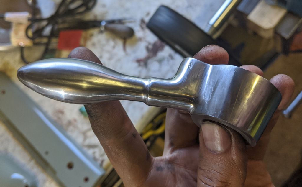

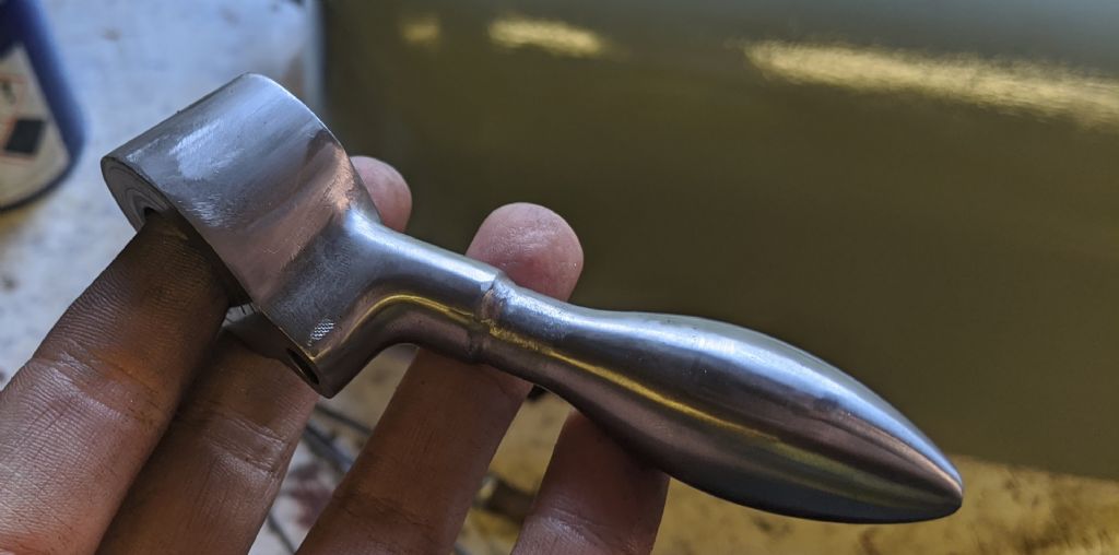

I decided that the lever at the bottom was very dinged up and not very nice to hold. And its about time I did some BLING. Got to show Herman how it's really done...
So I started off using a 600 grit belt on my belt sander, but using the unsupported belt section so it was slack and conformed to the shape. I used this to remove all the dings, then blended lots of surfaces.
Then I went to my standard green compound on a standard buffing kit wheel as a prepolish. This left a buffed surface, but not a nice shiny mirror surface like true bling should be
So I moved onto my proper buffing kit, starting with a Green 439T compound with a white close stitched polishing mop. If anyone wants a good source of polishing and bits, I find The Polishing Shop To be extremely useful for all my abrasive needs
From there I moved to a Blue P164 Compound with a Loose G quality mop
And finally, to finish it off, I went to a P175 compound with a Loose WDR quality mop.
So you tell me Herman. Do I BLING? laugh
It took me possibly 20 mins, so not too bad, and I'm very happy with how it turned out. I may be tempted to do a few more handles.

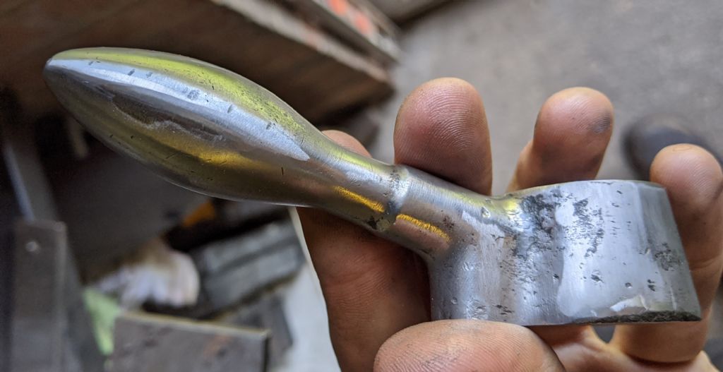

I've been painting and blinging today. Not particularly much progress as I didn't get the blinging finished.

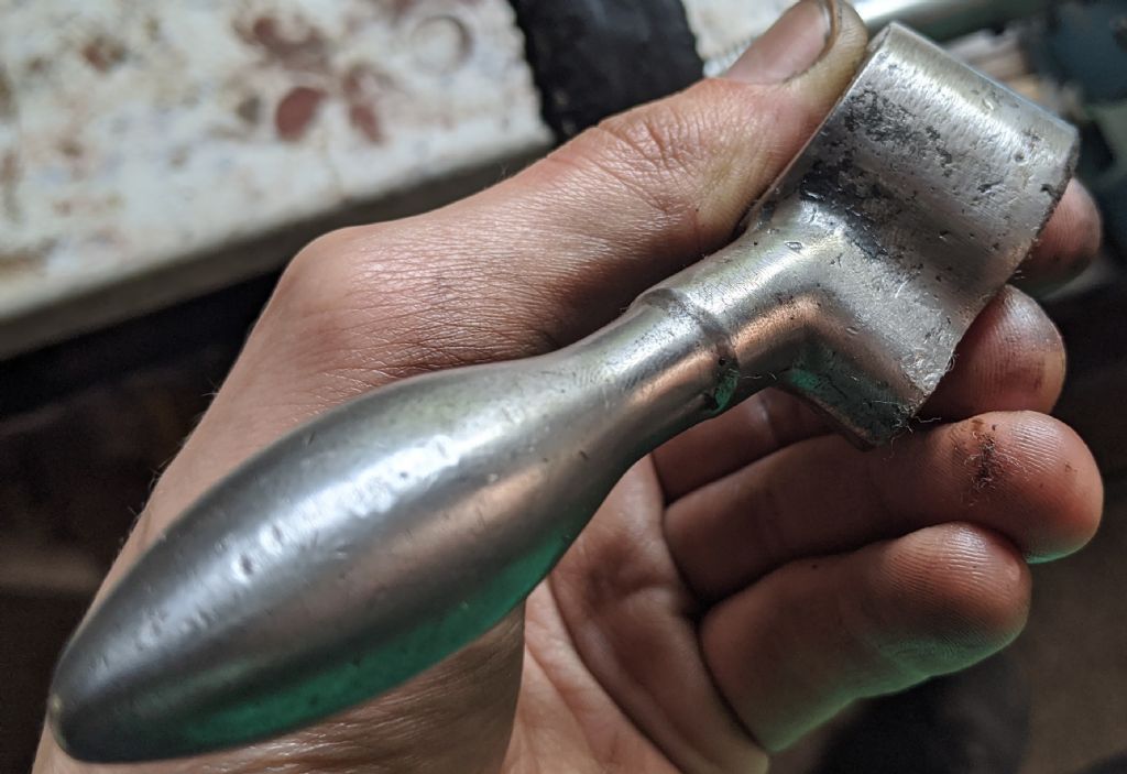

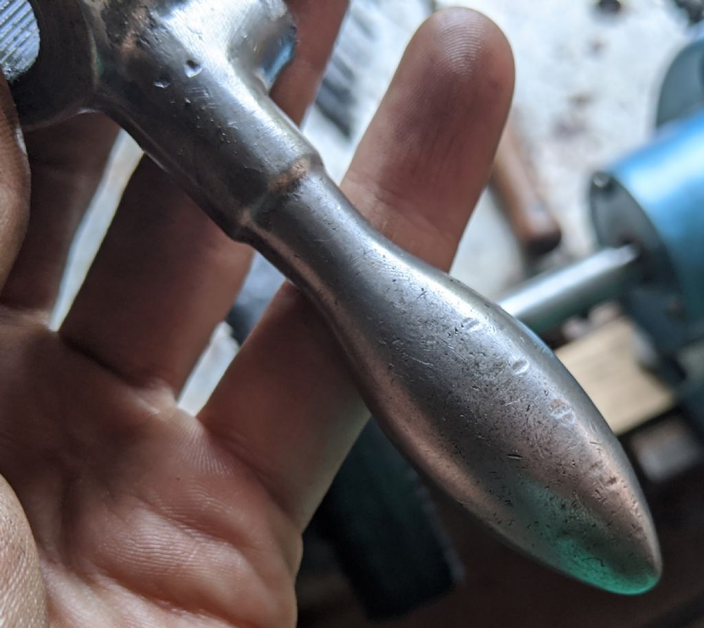

The handle was deeply beaten up and had even more dings that you can't see in the pictures. It took a long time to file and get them out. I still have to remove all of the deeper scratches and other bits before I can polish fully
A while later on the belt grinder, the 600 grit belt was not abrasive enough, so I moved down to a worn 240 and then to hand files
Hand files and then back to the 600 grit gave a decent enough finish, but there are still some deeper scratches from filing that will need removing tomorrow
Almost at the pre polish stage. Not too much work to do tomorrow.
