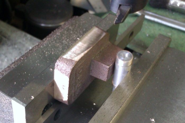

Hi Allan,
I'm no expert but the steps on the vice jaws are contributing to the problem. My vice just has parallel jaws with no steps or grooves meaning I can use parallels to position work so the milled surface is just above the top of the jaws. Gives a bigger contact area for clamping the work. Just an observastion, without a useful remedy.
Gary
JasonB20/04/2014 13:33:15
avatar
25215 forum posts
3105 photos
1 articles
As Gary says using the rebates in the jaws is not the best way with thick parts. Your fairly basic vice will also have a tendancy for the moving jaw to lift as it is tightened more so than a milling vice. If the work is supported by parallels you can tap it down with a lead hammer as you tighten the jaws which will help keep things true. Something like this. You can make do with a couple of strips of steel flat for now if you don't have parallels.
One other thing to watch when first holding castings in teh vice is the surfaces are unlikely to be even or parallel. So its good to use a soft packer between the work and moving jaw so it can take up any irregularities, a scrap of aluminium will do.
When you come to cut the grooves I would use the vice, set the work down low and keep the same side against the vice fixed jaw which will be your ref face and all six grooves can then be cut at the same handwheel setting. Simon's thread shows it here

For the sake of completeness - forgot to include the setup used on the mill for the channel...
Regards.
Allan.
