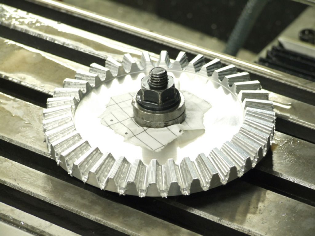

I don't know! (might be I cut a bit too deep!) Here is the spreadsheet I used to design them:
I built it originally from the Ivan Laws book, then made some mods based on Franklin Jones.

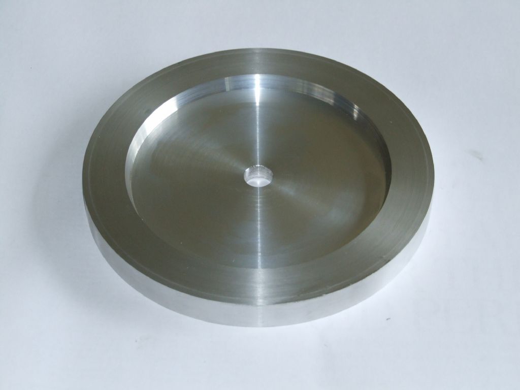

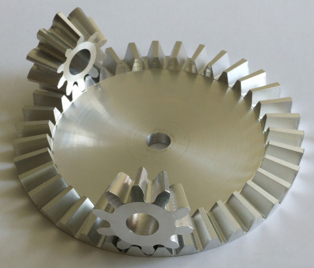

So, for my 400th post on this forum, I am proud to present another load of grossly over-engineered twaddle.
After a bit of a delay, partly due to work and partly due to toolpath issues, I've finally finished machining the prototype crown bevel gear. In one sense this is more complex than the pinion, in that the radius at the bottom of the tooth requires a 2mm cutter, but clearly it wouldn't be sensible to use that for roughing out. In the end I roughed out with a 4mm cutter, did a quick clean-up pass with a 3mm cutter and finished with a 2mm cutter. On the other hand the crown wheel is simpler than the pinion, in that it does not require the use of the 4th axis.
The crown wheel blank:
After roughing out:
And the finished gears:
The gears mesh together extremely well; better than one might have thought looking at the finish. All I need to do now is make the real gears in cast iron.

Hi Andrew, how did you get rid of the machining marks on the crown wheel, that it was a graphic at first!
Since this is all done for pleasure and recreation, not sure why over-engineering is a problem Unless it causes it to be too heavy or too expensive of course. I'd have gone broke years ago if I needed to make a living off the models I make
