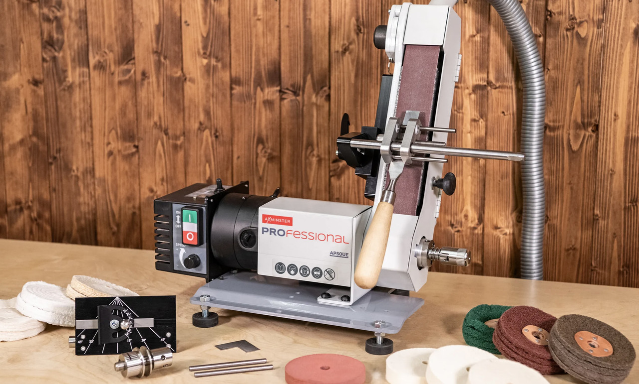

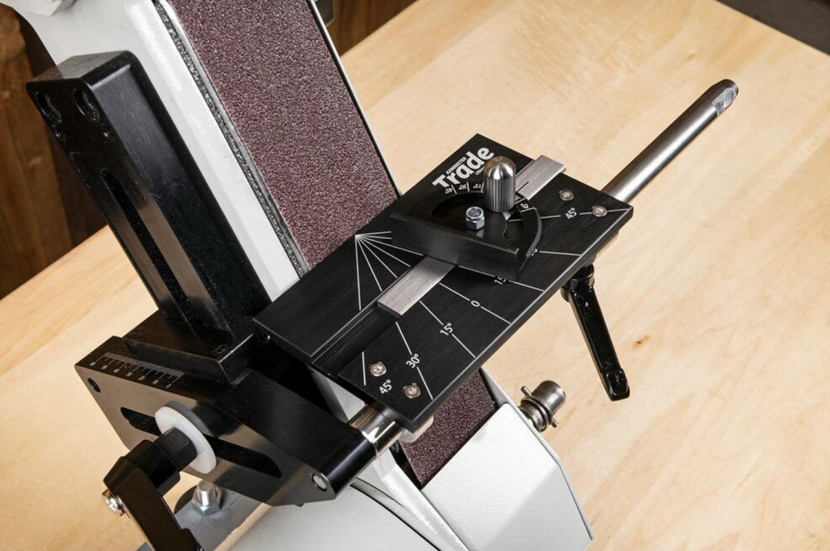

I still use a bench grinder from time to time but more often use one of these. I’ve made a nice table and a few other jigs for it. Being able to change grits for anything from 40g to over 1000g in a few seconds is very handy. You can even get diamond belts and a leather strop for it. It is variable speed and has forward and reverse. It’s been designed to sharpen all kinds of tools from carpentry tools, woodturning tools and knives etc.
A couple of product shots from Axminster.

Nice machine Vic (I like the variable speed) - but so is the price (£450).
Not tried roughing tools on my 4" Warco belt sander, might give it a go when the weather warms up a bit. Keep meaning to improve the work table in (vertical mode) but generally I use it for shaping bits of dead tree at the moment, so it's less of a problem.

I have a Record Power Belt and Disc sander that I used to use, I made a proper table and jigs etc for it. The only issue was the lack of availability of different sanding belts for it. I can get Alox, Ceramic, Zirconium, Trizact or even diamond for the Axminster machine. The arbor on the side has also been handy for using satin mops. I bought the machine when it was on special offer, think I paid £399 for it. Still expensive but it’s a handy machine to have.
