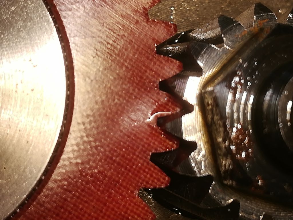

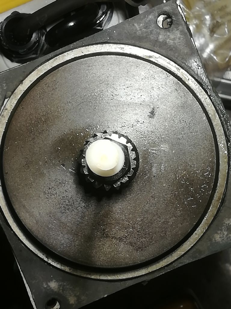

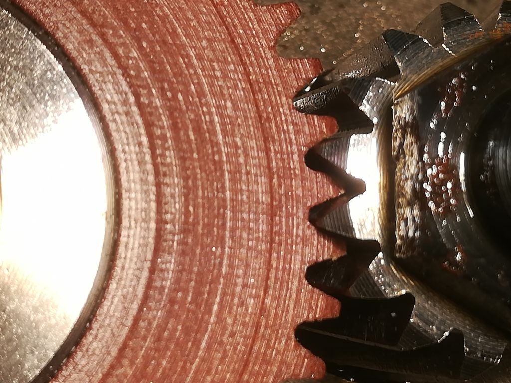

I learned a lot in this thread about this FB2 and clones. Love it.
drive gear 17T i inch outer diameter
img_20200929_174031.jpgnew gear fit 45T
old gear 47 T
Since I opened up my mill a few times and the gasgets are getting worse a drawing PDF of the top gasket would be nice. the motor gasget is a simple one. 113x113mm square with a hole of 108mm and 4 6.5mm holes 98mm square
