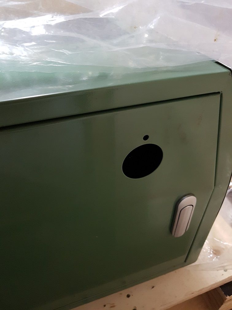

Also, should there be a cover plate on the hole in the side door to keep swarf out of the change wheels?

Yes there should be a cover over the end of the spindle . It pivots on a cap screw fitted into the small hole .

Hi Ian - my unit came with a small yellow round cover for the side door, but it was loose somewhere (can't remember where exactly) and there was no fixing to mount it with. I guess I'll get around to fitting it somehow...

Found it!
It was stuck under the foot.
That also explains the bolt that was floating about in there.

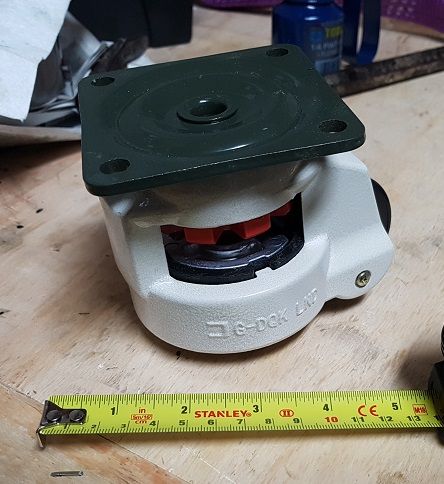

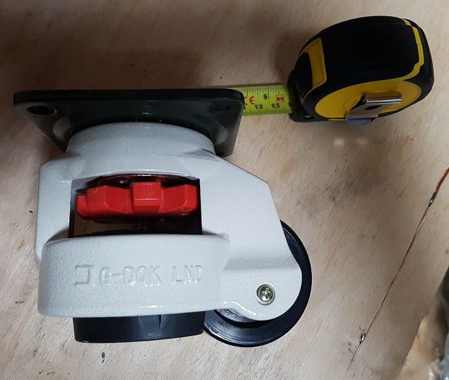

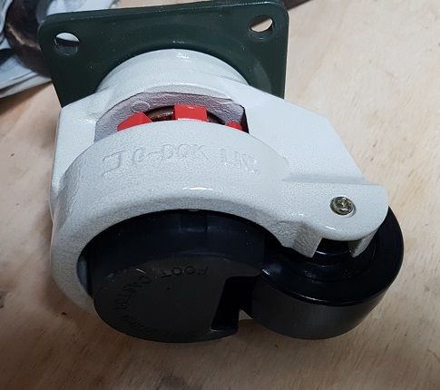

I am planning to use these machine casters:
103mm high and rated at 500kg each / 1000kg per 4.
They have a large central rubber foot that screws down.
Probably overkill, but I am going to use 4 on each pedestal to allow for fine tuning the leveling.
They will allow the lathe to be easily moved should the need ever arise.

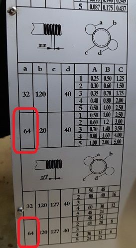

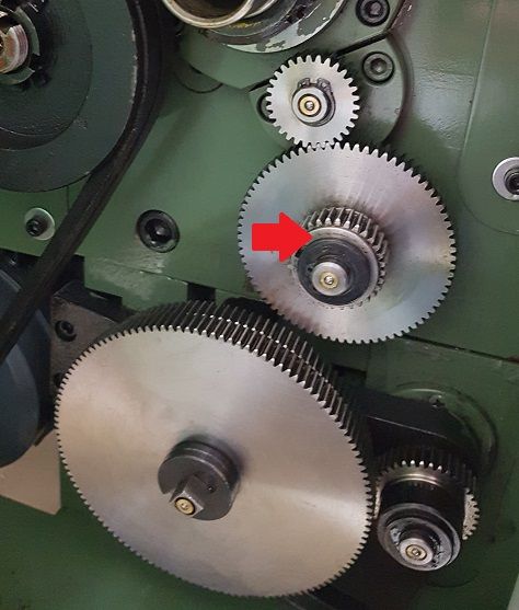

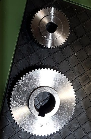

There are 2 extra gears supplied in the toolbox:1.jpg
One marked 64. I guess it goes here:
To cut these threads:
What is the other one used for?
BC Prof10/08/2019 17:21:54
182 forum posts
1 photos
Looks to me as if it is the alternative gear for the screw cutting indicator on the apron. Look at the chart on the splashback
Brian
IRT10/08/2019 18:05:29
151 forum posts
44 photos
Thanks Brian.
I have removed the splashback to make lifting the lathe easier, and it is resting currently resting on my workbench face down.
I missed that chart.
Gray6210/08/2019 18:27:56
1058 forum posts
16 photos
Posted by Ian Thomson 2 on 04/08/2019 10:26:38:
Ian, where did you get those castors from? could do with some like that for one of my grinding machines.
