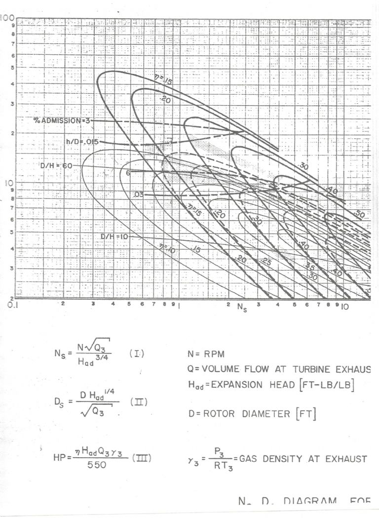

Turbine Guy14/03/2019 18:14:21
541 forum posts
578 photos
I finally have enough information to give an indication of how effective using an ejector could be for small turbines. A Penberthy GL ½ A ejector has the following performance.
Air inlet pressure of 0 psig
Air inlet temperature of 70 F
Steam pressure of 80 psig,
Steam temperature of 324 F
Steam enthalpy of 1186 btu/lb
Steam consumption of 8.3 lb/hr
Amount of air pumped = 1.77 SCFM
Mass flow of air is 8.0 lb/hr
Discharge pressure is 6 psig,
Discharge temperature is 290 F
Discharge specific volume is 21 ft^3/lb
Discharge enthalpy at 6 psig is 1186 btu/lb
Discharge enthalpy at 0 psig is 1154 btu/lb
Discharge mass flow is 16.3 lb/hr.
Discharge isentropic enthalpy drop to a pressure of 0 psig of 32 btu/lb.
Steam enthalpy at 0 psig is 1047 btu/lb
Steam isentropic enthalpy drop to a pressure of 0 psig is 139 btu/lb.
Steam specific volume at 0 psig of 24 ft^3/lb
With this information I can use the following chart to estimate the performance with and without the ejector. This chart estimates the maximum performance for the given specific speed Ns and specific diameter Ds. It is intended to be used by first deciding the speed you would like to run and then calculating the specific speed Ns. You then use Ns to find the Ds that gives the best efficiency. You can then find the optimum rotor diameter from the Ds. I am using a turbine speed of 10,000 rpm for this comparison.
For the ejector, Q3 = 0.095 ft^3/sec, Had = 24,896 ft-lb/lb, and Ns = 1.56
From the chart for Ns = 1.56 the maximum efficiency is approximately 34% with Ds =18
For Ds = 18, the rotor diameter is 5.30 in. The power is 0.070 hp.
Without the ejector, Q3 = 0.055 ft^3/sec, Had = 108,142 ft-lb/lb, and Ns = 0.39
From the chart for Ns = 0.39 the maximum efficiency is approximately 17% with Ds =40
For Ds = 40, the rotor diameter is 6.21 in. The power is 0.076 hp.
Using the ejector, the efficiency of the turbine is double that of the turbine without the ejector. The ejector definitely improves the transfer of energy in the turbine. However, the discharge mixture from the ejector has so much less energy that the power ends up almost the same.
Ns Ds Diagram
Turbine Guy15/03/2019 12:05:30
541 forum posts
578 photos
The heavy solid lines in the chart of the preceding post are for axial turbines. The dashed lines are for Terry turbines. The thin solid lines are for Drag turbines. The drag turbines are like turbine pumps. The blades circulate the flow in a way that increases the drag force on the rotor.  The units for the volume flow are ft*3/sec and for the gas density lb/ft^3.

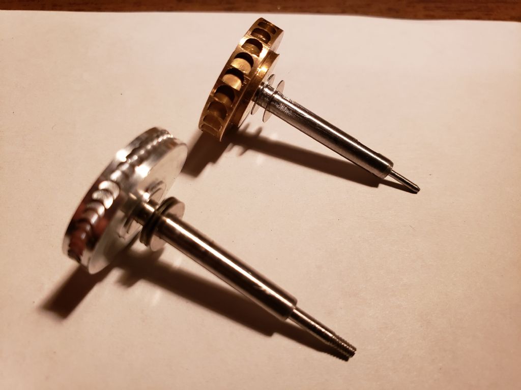

Turbine Guy26/03/2019 19:13:22
541 forum posts
578 photos
In the post of 08/03/2019 I showed a revised rotor and stated that it could get a rotor velocity coefficient of up to 1.64 times that of my existing turbine rotor. I built this rotor almost as shown on the drawing attached to the 08/03/2019 post. The following photo shows the new rotor (aluminum) next to the original rotor (brass) I tested this rotor with the same air pressure and flow used in the test of my original rotor that had a maximum speed of 17,000 rpm. The maximum speed with the new rotor was 18,250 rpm. The required power of the EP2508 propeller used in these tests is approximately 1.9 watts at 17,000 rpm and 2.4 watts at 18,250 rpm. The average rotor velocity coefficients for these output powers are 0.34 for 1.9 watts and 0.53 for 2.4 watts. The increase in rotor velocity coefficient with the new rotor is 1.56 times. I didn't quite get the maximum I thought was possible, but this is a very significant increase. The original rotor has 24 pockets and the new rotor has 48 pockets. In Dr. Balje's study of high energy level, low output turbines the highest average rotor velocity coefficient for a Terry turbine with a single nozzle and 45 blades was 0.53 The open pockets appear to be as efficient as the Terry turbine blades.

Turbine Guy10/04/2019 21:06:52
541 forum posts
578 photos
Based on the success of the new rotor that verified the importance of using as many blades or pockets as practical, I’m going to try velocity staging next. I looked at making a Terry turbine with a reversing chamber as shown on the drawing of the 04/03/2019 post. I was able to come up with ways to machine the blades but since the performance of the open pockets appeared to be about the same as with blades, I’m looking at other possibilities. I compared the estimated performance of the Terry turbine with an open pocket design that used two rows of blades on the rotor and an open pocket reversing chamber as shown on the following drawing. Since a new housing is needed, I increased the number of pockets from 48 to 60. I also made the ratio’s of the nozzle admission length (a), reversing chamber admission length (ar), and the rotor pitch length (t) approximately even multiples (a/t = 0.103/.051= 2.02 and ar/t = 0.051/0.051 = 1). With these improvements to the open pocket design, the estimated maximum power was about the same as for the Terry design. The wider blades required for the corkscrew type of flow of the Terry turbine resulted in about 2.5 times the flow length of the open pocket design per stage. Both types allow the flow to expand as it travels, so the length of travel is very important. Dr. Balje’s methods of estimating performance take this into account and were what I used to in my comparison.
Tangential Turbine 3 VS 2

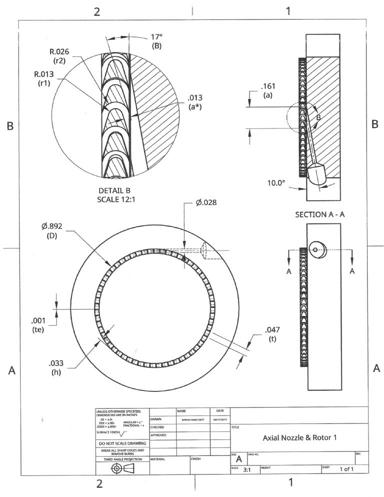

Turbine Guy18/04/2019 21:56:20
541 forum posts
578 photos
I looked at the axial rotor and nozzle that would give the efficiency given in the last post. The rotor and nozzle assumptions used by Dr. Balje in the Ns Ds Diagram are:
a*/D = 0.015, s/h = 0.02, t/te = .02, and r1= a*. The cutter diameter (a*), blade height (h), blade pitch (t), blade entrance thickness (te), and the blade inside radius (r1) are shown in the following drawing. The clearance between the top of the blades and the housing (s) would need to be about 0.001 in. Another assumption is the flow leaving the nozzle should be at 16 degrees including the 6 degrees it deflects due to the angular discharge opening. The blade inlet and discharge angles are equal and designed to have no incidence at design speed. The drawing shows the values of these parameters for Ns = 0.7 and Ds = 11.9 of the last post. The speed (N) is 18,250 rpm, the exhaust volume flow (Q3) is 0.0064 ft^3/sec, and the expansion head (Had) is 27,230 ft-lb/lb for this example.
One of the most significant advantages of the axial turbine compared with the tangential turbine is the small angles that can be used on the nozzles and blades. The efficiency increases due to the flow being closer to perpendicular to the direction of the rotor movement and the increase in admission length (a). The tangential turbine is very limited in making the blade and nozzle angles small. Dr. Balje assumed a nozzle angle including the 6 degrees of flow deflection of 20 degrees for the Terry turbine.
