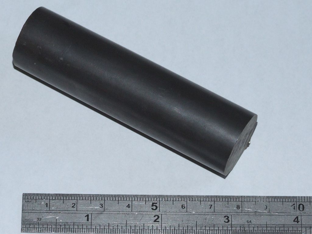

Andrew Johnston27/08/2017 21:47:34
avatar
7061 forum posts
719 photos
My tungsten alloy bar arrived last Thursday:
I've had a go at machining it this evening. It machines very well, no issues with facing and turning. The finish looks a little rough, but I was using a 0.2mm radius insert at 0.1mm/rev. So no doubt I could improve on the finish:
I measured the surface roughness at six points around the circumference; the average was 2.09µm Ra. Surprisingly that's comparable to what I achieve on other metals so not bad.
Sadly drilling and tapping proved to be more problematic. I managed to get a M6 tapped hole produced, but it wasn't easy. Once I'd started a hole using a carbide slotdrill (removing the broken HSS drill in the process) HSS drills opened up the hole without a problem. Tapping proved difficult, although my M6 taps are far from sharp. More research is needed and I feel a tooling order coming on.
Parting off was simple at 4 thou/rev feed and a conservative 260rpm, giving a good finish:
The centre tab was easily removed by filing.
The next exercise is to use the hydraulic copy unit to produce a hemisphere.
Andrew

Andrew might be worth investing in one of the colour coded taps, maybe a red ring ?

Yep, I was reading about the issues last night. The problem seems to be that tungsten has a high Young's modulus so it tends to grip the tap and contract rather than flow slightly. From what I can see a blue or green ring tap may be better as these are intended for materials that close up slightly. The question is do I go for blue, intended for tough stainless steels and tool steels, or green which is intended for tough non-ferrous materials, which of course includes tungsten. Ideally taps would be two flute and have extra relief ground. Or should I just use red, as they are intended for tough steels. Decisions, decisions!

Andrew Johnston02/09/2017 20:58:58
avatar
7061 forum posts
719 photos
More progress, forwards and backwards. I've had another go at drilling and tapping tungsten alloy, and drilling small holes. I still don't seem to have the tapping sorted. Even with spiral flute and spiral point ring taps I managed to break one. And that was with a thread engagement of about 30%. Although it was my fault, I think I put a bending load on the tap when trying to back it off. This stuff seems to grip the tap like a boa constrictor. The spiral point tap seemed best, even then it looks like the black finish has worn away after one hole.
On the plus side I found that slow helix carbide drills cut the stuff like butter, beautiful. Still at £11 for the 3.6mm drill I'd have been might upset if it hadn't worked. I also had a go at drilling 1.2mm holes, as I will need these for the 18swg hoops that stop the balls flying off if the governor springs break. Here's the result, two 1.2mm holes 6mm deep, no problem:
The drills are 4-facet so I didn't centre first, just straight in at 2500rpm, using WD40 as a lubricant.
Andrew

duncan webster02/09/2017 21:05:33
5307 forum posts
83 photos
can you not drill all the way through, counterbore the back and glue in a nut. Tapping this stuff looks like self imposed purgatory

Drilling blind to say 5mm dia and silver soldering in a more user friendly metal sleeve that can then be tapped M4 would be another option, this would mean your outer ball half looks solid. I've had no problem silver soldering tungsten TIG electrodes.

Do you know anyone who could try thread milling this material? I suspect that would be the way it would be done in an industrial production process.

Andrew Johnston03/09/2017 10:46:08
avatar
7061 forum posts
719 photos
Based on the reported composition I've calculated the density as 17.92gm/cm³. So a bit less than pure tungsten, but much easier to machine.
I'm not beaten yet on the tapping, although I do have some alternative plans sketched out, just in case. As long as I have enough thread to hold the blank while I form the hemisphere I'll be happy. To avoid loss of density due to the tapped holes I plan to buy some tungsten/copper alloy from fleabay and make some short studs. If I use a Coventry diehead I can tweak the thread OD to be a snug fit in whatever tapped hole I manage to produce.
I've considered thread milling. Although there are a number of local machine shops in my area I expect their prices for a relatively small PITA job would be out of my budget. Anyway if I thread mill I want to do it myself. I've bought some single point cutters to have a go, but I'd like to start with larger threads in a more benign material. Thread mills for M4 cost around £80; that's a lot of wasted drinking vouchers if I break the cutter.

Out of idle curiosity this afternoon I drilled a couple more 3.6mm holes, about 50% thread engagement for M4, in my remaining bar and tried tapping with an old set of Dormer HSS straight flute hand taps. Worked just fine! I used all three taps in sequence, and cutting fluid definitely helped. For one hole I used Rocol RTD and the other Ferrofluid, a thin oil intended for tapping tough materials like stainless steel. It's difficult to know which was best, but the oil is less messy. The taps needed noticably more torque than normal materials, but no worse than austenitic stainless steels. So much for the fancy sooper dooper taps. Sometimes you just have to reverse up and try a different path rather than press on regardless with ever more involved, and expensive, 'solutions'.
The next question is do I stick with M4 or change to M3; the original design specified 6BA? Ultimately it'll depend on the leaf spring design. But I'm inclined to stick with M4 as during manufacture the thread takes all the cutting torque generated when using the hydraulic copy unit to form the hemispheres.
