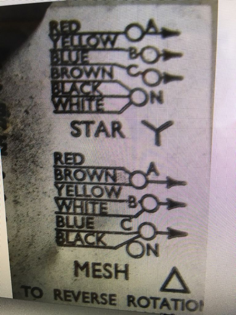

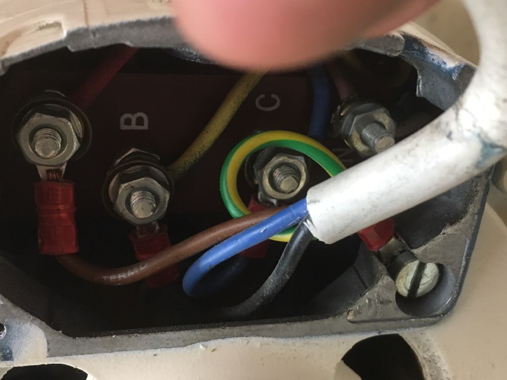

Lee Goulding20/06/2017 13:58:52
123 forum posts
19 photos
some picture of the Star wiring that i need to make Mesh/Delta so i can then connect the Inverter which i believe connects from U,V,W to any of ABC on the motor.
Any helps would be great
Thanks
John Rudd20/06/2017 14:58:50
1479 forum posts
1 photos
Need a better picture.....
If that is a Star wired motor, you need the star point accessing to change to Delta....
What motor is it?
There are threads on here giving advice in how to change from Star to Delta...

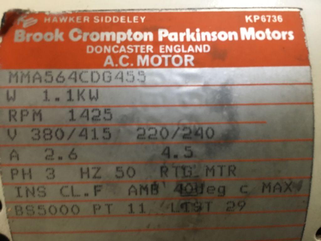

Lee Goulding20/06/2017 15:27:08
123 forum posts
19 photos
Hi John
i have seen a few posts on it but no simple explanations i.e remove all wires and connect Colour/Wire to A,B,C,N etc
The white cable in the picture is going to the electrical control unit on the lathe itself so i presume that will be disconnected altogether and the remaining wires i are to the motor which then need connecting Brown to A, White to B and Black to C with nothing on N to make it Mesh/Delta
Thanks
