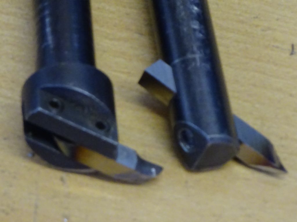

JasonB12/09/2016 11:47:19
avatar
25215 forum posts
3105 photos
1 articles
Flycutting with the cylinder vertical on the cross slide looks an even better option now, this would also square off your 16mm block
JasonB12/09/2016 17:15:09
avatar
25215 forum posts
3105 photos
1 articles
Here you go brian, flycutting as I suggested earlier.
Infact I used the boring bar on the right as it will be easier for you to make one but a small flycutter like the one on the left will also do the job with the right cutter in it..
Take off the topslide then use a tee nut, stud and nut to hold the cylinder in position, pack it upto ctr height. Set the cutter tip to be 15mm from the central axis, you could do this by touching it against the top or bottom flange. Then simply take a cut, advance the carrage a little, take another cut and so on.
As you can see this gives a good flat surface to solder to and the corners are nice and square.
I would suggest a trial cut first on some scrap and also when rotating it is hard to see the cutter so you may want to refit the chuck guard for this.

Okay, I can now see how that would work. I will have to order a fly cutter and make up the cylinder.

Would this 19mm fly cutter be suitable to do the cylinder ?
**LINK**
JasonB15/09/2016 16:08:08
avatar
25215 forum posts
3105 photos
1 articles
Yes, probably go for the smaller of the two heads as the tool bit is not so thick and will need less grinding.
