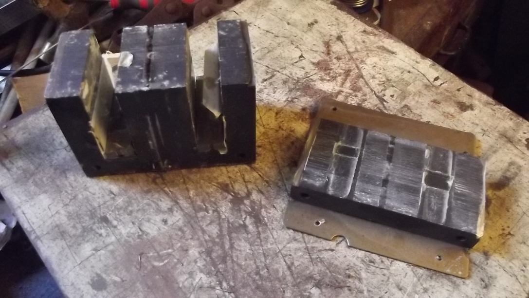

To be more specific about it all I have had a mystery transformer which has been sitting around for a while. Have so far torn the copper out the middle (might be able to cast it into something later) and have it ready to wind my own transformer (after I do some maths to check it won't catch fire). Then the output goes into a rectifier. That will probably be in its own standalone box cause it might have uses other than motors.
Then I can stick an ESC to the outputs and power whatever motors I end up with (in theory).

The transformer had been sitting around for a while. Makes a useful doorstop, anvil, glueing weight... Winding were a bit frayed when I thought of using it for actual transformer stuff. Windings had to go.
I was about to say that to get 1.5kw 3 phase inverter + motor is £240 or more.
I may or may not be able to get a bargain, by this time tomorrow I might be very strongle on the path to three phase. Shame about no being able to hook stuff up to a computer but oh well.
