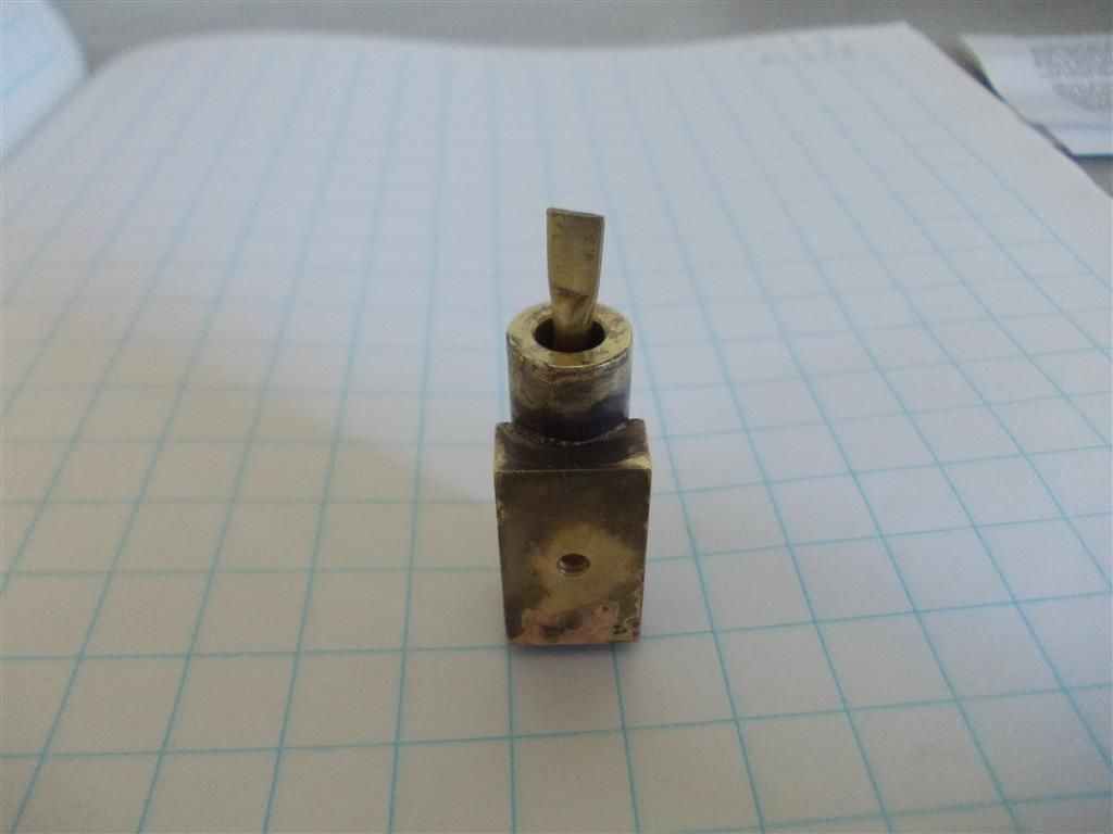

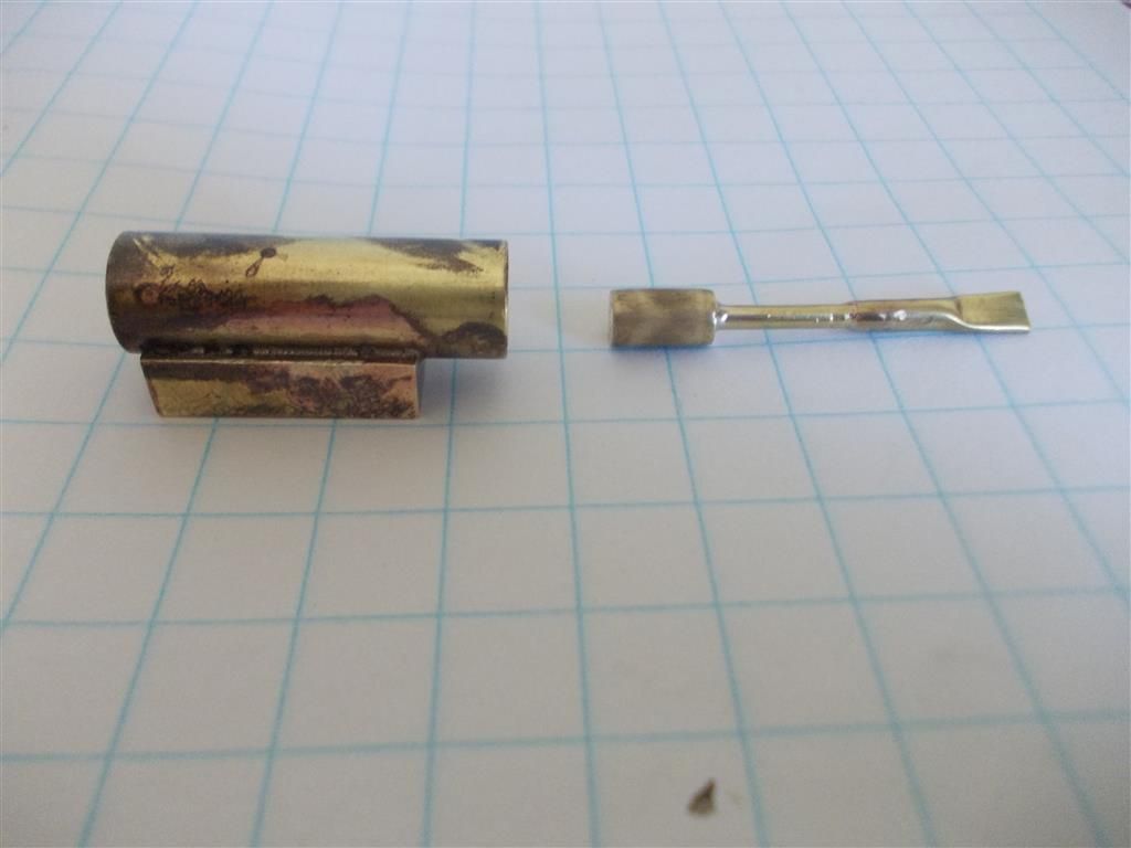

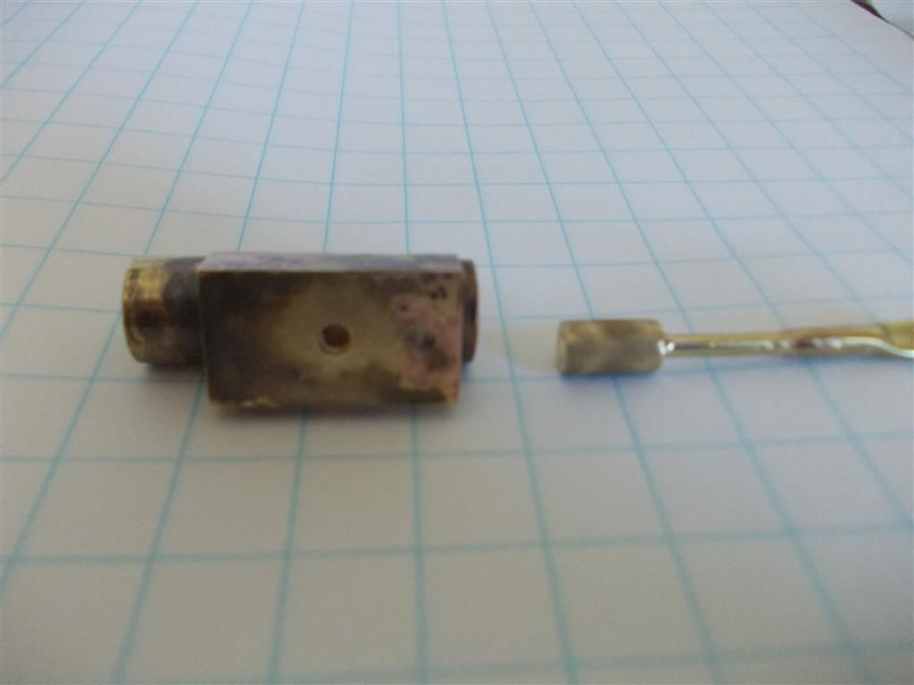

Disaster : As suggested above, the propane torch did not get the metal hot enough. I decided to start off with something small and easy : I tried to solder the piston rod to the piston and the cylinder to the the brass spacer as per the instruction. The flux did not turn to glass as advised, instead it turned pink. The solder would not melt when I touched the metal parts ; there is just not enough heat. I did end up with blobs of solder over many of the parts including the piston !
Oddly enough I cannot get the parts apart ! I know they are not soldered correctly as the solder did not run into the fluxed joins.
The propane torch kept flaming out when I pointed it downwards. Do they have to be kept in an upright position ?
With the equipment I have I might have to consider soft soldering the boiler. Can I use 15% silver plumbers solder from the hardware store for that ?
NOTE : The parts are sitting  in a glass of citric acid now. I will post some photos later.

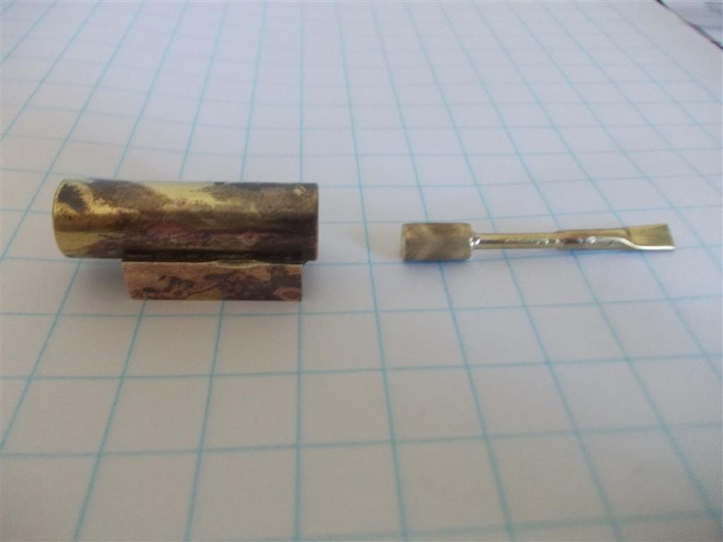

I have had another go today. This time I changed things, I fluxed the joints then placed pieces of solder wire on this flux. I then applied the torch to the metal until it was as hot as I could get. The solder was almost starting to melt so then I applied the flame directly to the solder. I know this is not how it is supposed to be done but I decided to give it a try anyway. It seems to have worked but I doubt that I could use this method for soldering the boiler.
Problems :
1. I have managed to solder up the steam hole so I will have to drill that out.
2. I have dipped it in citric acid for a few minutes then worked on it with the Dremel tool fitted with a wire brush. I will put it back in the citric acid overnight. Should all the pink colour be removed from the brass ?
3. I may have stuffed up the piston. There was some solder on it and I removed it by placing the piston rod in a drill and applying 400 grit sandpaper to the surface of the piston. The piston may not be a tight enough fit in the cylinder now. I will have to try it and see. I should have used 800 grit which is what I usually use for this sort of job.
Brian John19/11/2014 06:42:37
1487 forum posts
582 photos
I cleaned it up and put it together and it runs like the clappers. The piston probably could have been a better fit but it does not seems to make much difference.
