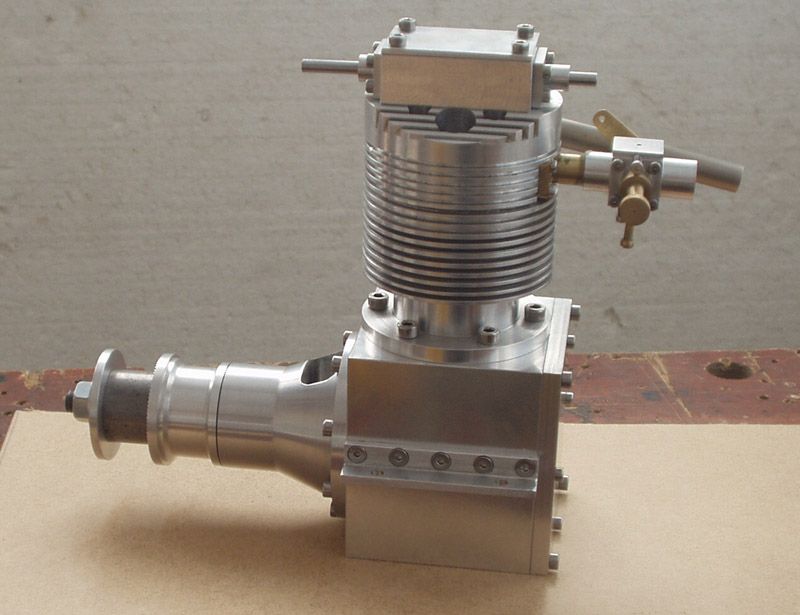

wheeltapper30/09/2011 13:39:54
avatar
424 forum posts
98 photos
Hi
I thought I'd stick it all together temporarily to see what it looked like.
behold the beast
cheers
Roy
Clive Hartland30/09/2011 15:59:43
avatar
2929 forum posts
41 photos
Now for a nice bit of anodising Roy, The head in Red and the cylinder in deep Blue and the crankcase Black.
Very good work there Roy and you should be proud of what you have made.
It should run well!
Clive
