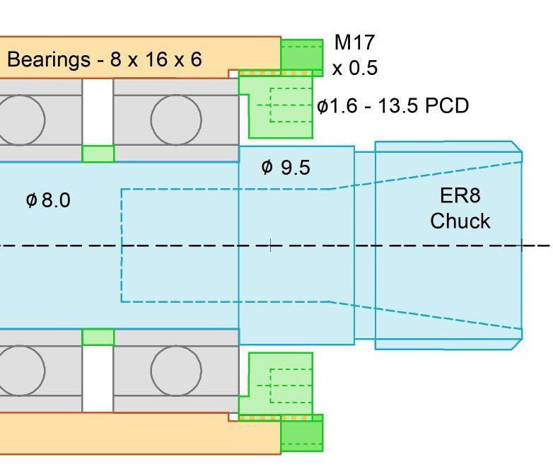

OK, more simplification. Probably.
Make the 'nose nut' without the flange you've drawn, so that, when tightened, it sticks out say 3mm beyond the end of the housing. The nut's OD is threaded along its entire length (easier to machine), and it has a couple of axial holes on its exposed face, for a pin spanner. When boring and screw-cutting the housing, make the threaded section longer, then part off say 3 mm. This parted-off section then screws onto the exposed threads of the 'nose nut' (taking the place of your flange), locking it. You'll need to make a couple of pin spanners (or a C spanner for the locking nut, if its face is too skinny for spanner holes) to tighten the nuts. (Sorry for that complication). I can think of other locking strategies, but this one seems the most elegant - so far...

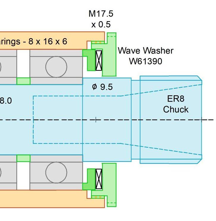

I may well be incorporating the rear nut into the pulley yet. That way won't the torque keep the nut locked?
Once I'm happy with the rest of the spindle design, I'm going to look at the drive etc.
I like the nose nut lock suggestion and will do a drawing but I've also found a wave washer that fits so will draw one for that as well.

Two more drawings. The first is the nose lock nut suggested by Kiwi Bloke.20mm spindle 06 nose.jpg
The second one has a wave washer in the nose. It's shown loaded on the drawing dimension wise.20mm spindle 07 nose.jpg
This one looks kind of complicated. I'm sure it can be simplified.
Steve

I would consider a spacer for the outer races, then the nose nut can be locked up tight.
To create the right preload is a case of making the inner race and outer race spacers different lengths.
if you have access to a surface grinder then you can make them initially at the same time - this creating a
paired length, and then selectively lap the inner one shorter.
On the back nut a pair of lock nuts should do.

Nah, don't like the wave washer. You'd still need to lock the nut. The wave washer does provide spring pre-load to the bearing pair, but it also destroys axial stiffness.
