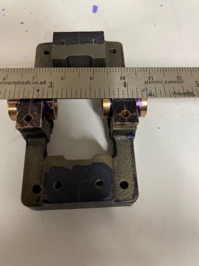

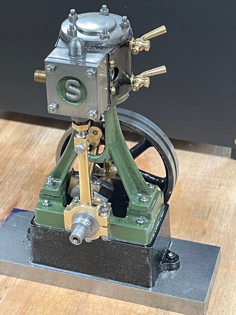

Hello Scott, sorry I'm a bit late to this thread, only just seen it. To answer your question 'has anyone else come across the 11/16 vs 5/8' issue, the answer is yes I did earlier this year. I am new to Model Engineering, this was my second engine and I had the same dilemma, so I decided to make machine the base casting and bearings and measure the width between the inner faces, and found it to be 11/16 as per the pic below (bit of interpolation needed!). I then made the crank to the 11/16 dimension, it was a tight fit between the bearings and needed a little easing. I would be interested to hear how you got on with this. I finished the 10V a few months ago, and am very please with how it runs (on steam). I have now bought the reversing gear which which I will tackle after my current project, the Stuart Beam which I am currently half way through. Steve
img_2038.jpgcompleted 10v
