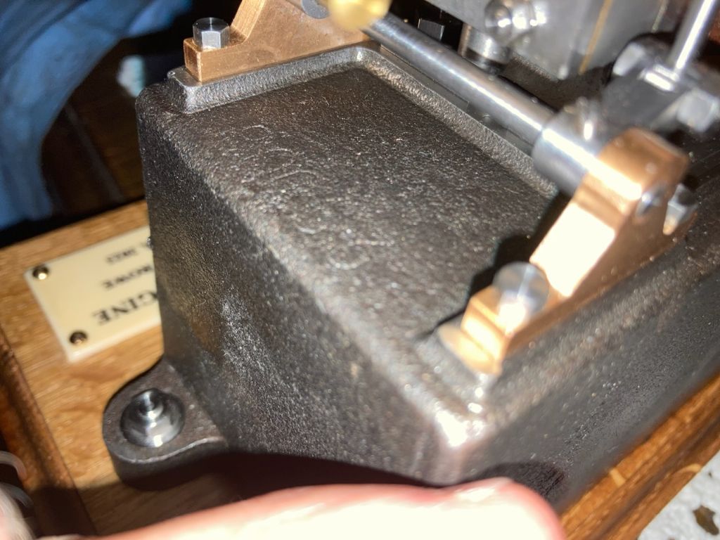

06/06/2023 13:02:02
Posted by John Purdy on 05/06/2023 18:24:44:
My Stuart beam is probably from the '70s or '80s ( I got it part built second, or more, hand ) and the number on the base is 80063 and on close examination with a loupe is definitely cast in not stamped. So I would assume it is a casting number.
The number on mine is probably she same as yours. It is quite faint on mine, so I posted what I thought it said. My base casting was a replacement that I bought from Stuart, so it is from a different vintage than my casting set, (the original was a terrible casting. The raised Stuart lettering was very defective and quite unappealing).
05/06/2023 13:10:45
Posted by noel shelley on 05/06/2023 11:58:27:
The numbers are faint but appear to be cast in not stamped so will not be a serial number, more likely a number to identify the casting . Possibly part number 3 of assembly 8065? Noel.
I think that you are correct. The numbers are probably a part identification. It seems odd that they bother to cast a part number onto a part that cannot be confused with any other, but that still seems to be the logical explanation.
I do know that at some time the rim of the flywheel changed and the bearing went from gunmetal castings to Brass extrusions. I don’t know if these changes occurred together or not. If anyone knows when that happened it might help to at least establish a before of after date for identification.
Thanks
05/06/2023 02:03:22
Posted by Hopper on 05/06/2023 01:29:22:
If the number is cast into the base rather than stamped it is more likely a casting number than an individual serial number. So would have stayed the same over many years on all such castings if the same pattern was being used.
I can’t say for certain that it is cast in. The numbers on mine appear to be 8065-3. The numbers are fairly faint and I left the casting bare. I am wondering what numbers if any that have on their casting.
Edited By Django on 05/06/2023 02:08:53
Edited By Django on 05/06/2023 02:14:22
04/06/2023 18:17:57
My Stuart Beam Engine has what seems to be a serial number cast into the top of the base. Does anyone know when Stuart was doing that?
Another question is, when did they change the flywheel and bearings?
Thanks
Edited By Django on 04/06/2023 18:18:54

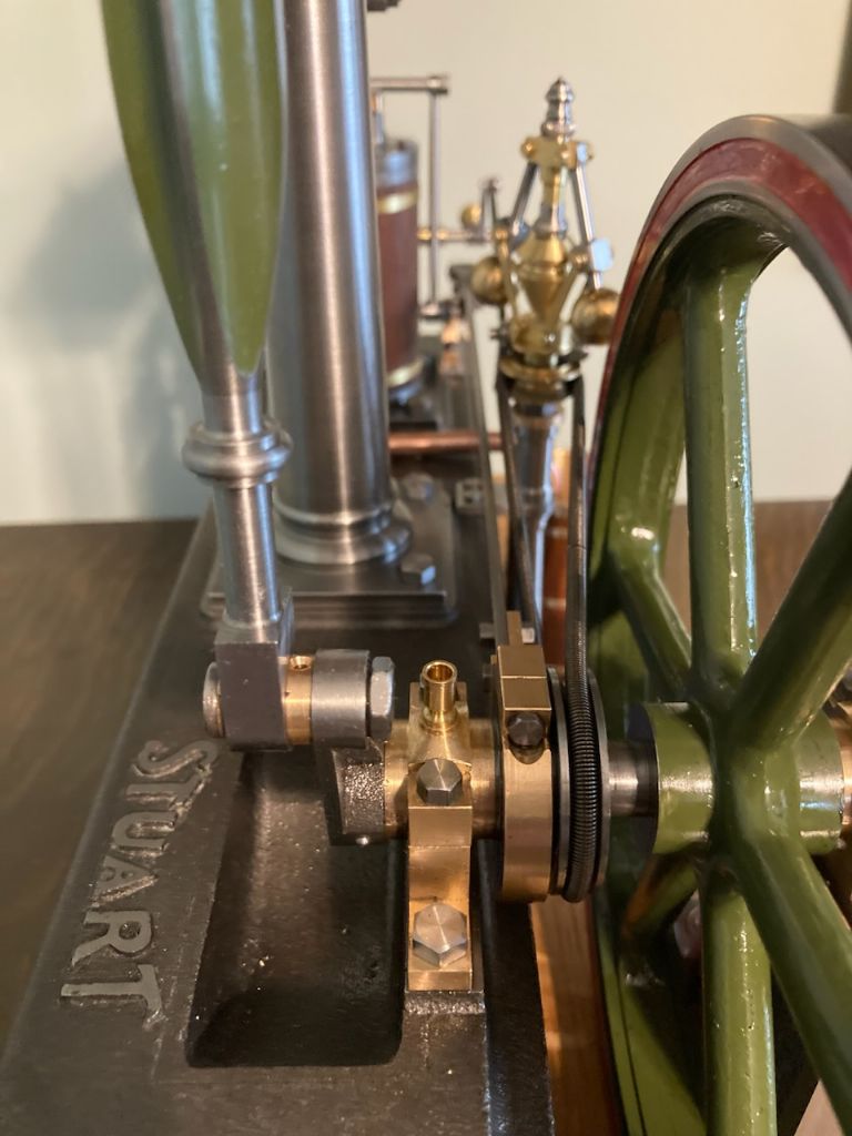

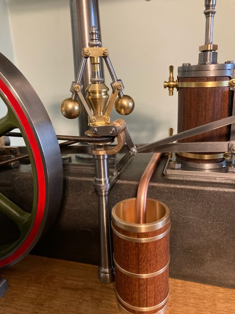

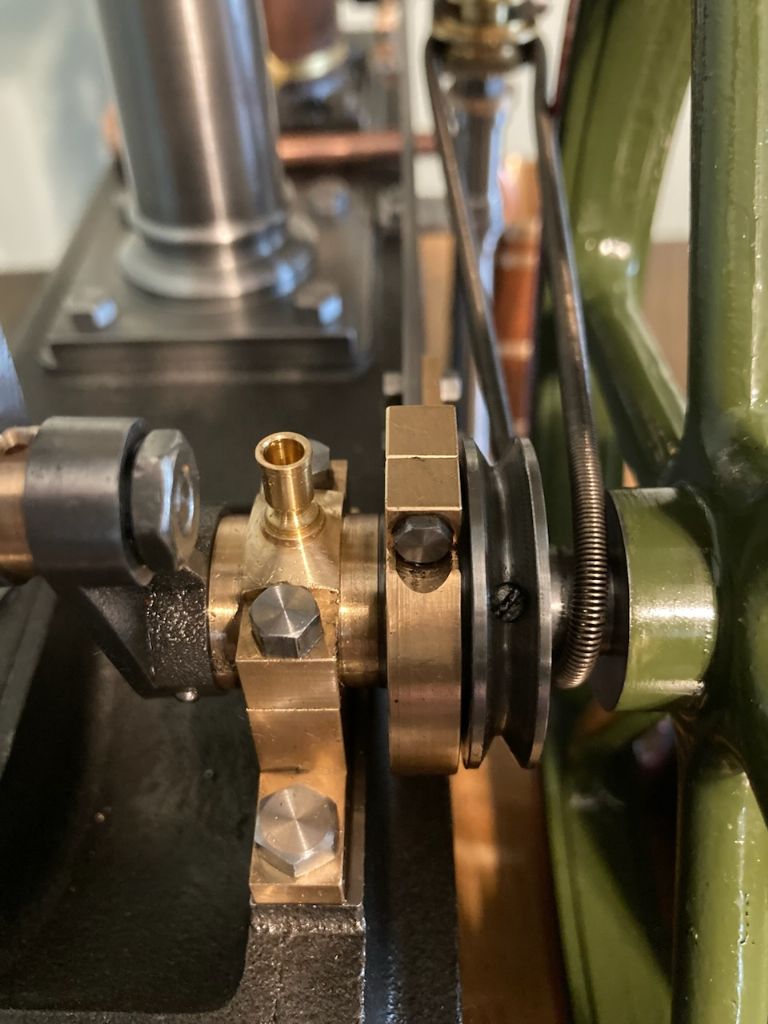

01/05/2023 15:54:21
fd29d381-17b2-4476-9f70-a21f5c02ffb9.jpeg83867c70-4a84-41eb-b503-436619157e65.jpeg5f298bde-fbc0-4710-8a44-2b54812f3866.jpegHere are some images of the governor and the pulley, (spring belt on and off).
01/05/2023 15:33:43
Your engine is looking great. Regarding the governor, mine begins to do its job at approximately 200 rpm. I used the Stuart ratio which is if I remember correctly, approximately 1.75:1. My governor’s balls are scaled down 20% and I substituted a weight for the spring and made other changes to improve efficiency and hopefully improve the appearance. I prefer to run mine at about 60 rpm, so the governor is not doing anything more than revolving.
One additional note about the Stuart governor. The drawing has you making an eccentric with a grub screw in the center and a separate pulley to drive the governor. This makes valve adjustment a problem because you have to dismantle the eccentric strap to adjust the timing. I simply bored the pulley out large enough to mount it over the cylindrical portion of the eccentric and use a single grub screw that is in the center of the pulley.
