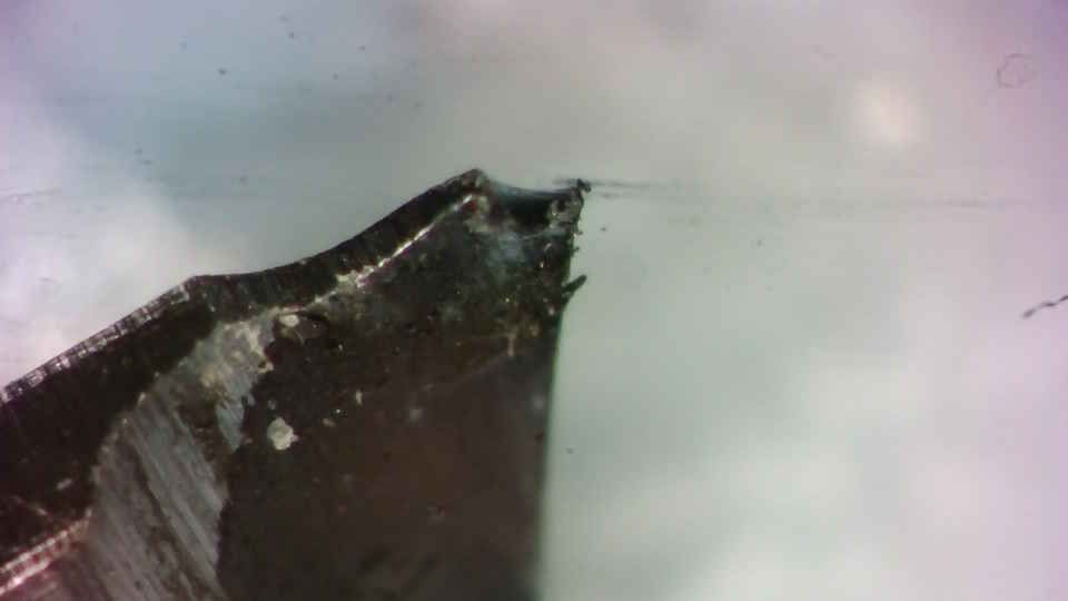

As an example of my issues, here are some pictures of a very fine tipped toll I ground, put to work to cut 3 grooves.
Sadly I don't have any before pictures, but the profile was reasonably square from the top and of course there was a point from the side. The end flat was originally about 0.35mm - the images are considerably enlarged!
In this case this end is the opposite end from the pointy end of a parting off blade which I'm reasonably sure was sourced from ARC and thus should be of decent quality.
All three cuts were in stainless. The first in 304 the last (when I noticed the quality is of uncertain consistency.
I expect that the tip got to blue temperature at some point in the grinding process.
Any idea what I can do to fix this?
Many thanks
Iain

re. your photo, Iain, I would hazard a guess that the tool was allowed to rub on the stainless, which work hardened and wiped the tip off the tool. Try regrinding with no top rake and be reasonably aggressive in feeding it into the work - don't let it rub.

I will be regrinding and will try various approaches on some test parts - rather than the tinal item. As far as agressive - the top is 0.3mm and I need to cut down to 0.3mm. I probably won't manage that agressively!
Do you think I should be running as fast as possible (for this, we have a 1.8mm dia target), or run slower and more controlled?
Iain

I'd try as fast as possible since the diameter is small (so you need a high speed to get a decent surface speed), and it'll be easier to maintain a consistent feed per rev, keeping it cutting but not causing it to dig in and break. You may get through a few test parts/regrindings!
