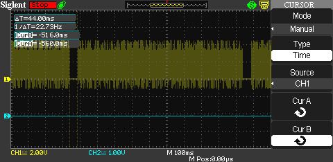

Any idea how a parallel port's performance compares with twiddling pins on a Raspberry Pi 4? What's the highest frequency a parallel pin can output...
I've experimented with a Pi4 in various real-time modes to see how fast it's IO pins can be made to go and results are both good and bad. Output is quick except for awkward pauses due to the scheduler...
The base thread speed really depends on how well the computer can run the realtime kernel. The computer I am using in the video is a 3rd gen i5 HP. It has pretty decent latency and allows for a base thread of around 40-50 khz. I have not seen computer hardware get much higher than that with linux/linuxcnc.
I have not seen much of a difference between onboard, pci and pci-e printer port cards. (other than some features are there or not depending on how it was made)
I have have tested linuxcnc with gpio on the rpi 4 - the base thread I got was 20khz - but because some functionality is missing in the linuxcnc gpio driver - you can only get 10khz step pulses
Sorry about the delay replying - having a busy week. I wrote this user-space code to test rPi output speed:
Assuming the library is efficient, I believe the program gets close to the maximum General Purpose IO output achievable from a Pi4. About 4.0MHz, two hundred times faster than linuxCNC's 20kHz, but unlike linuxCNC my code does absolutely nothing useful!
I think the scheduler and memory lock settings used have the effect of dedicating one of the 4 CPUs to my process, maximising the time between scheduler interruptions, and forbidding swapping (admittedly unlikely on a lightly loaded computer).
Next oscilloscope screen shot shows the scheduler to be working in blocks of 1 second, in which my program runs for 956mS, and is paused for 44mS in every second:
44mS is too long for my taste - needs investigation. Reading is more difficult I haven't found a quick way of responding to incoming bits in user-space yet.
Whilst busy flat out pin flipping the pi4 supports other activity more or less normally - the other 3 CPU cores handle business as usual and seem unaware that the 4th core is running flat out. Pretty sure the chip has ways and means of generating faster output in hardware, but that's cheating.
