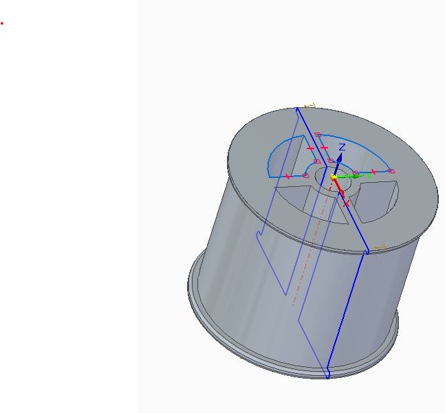

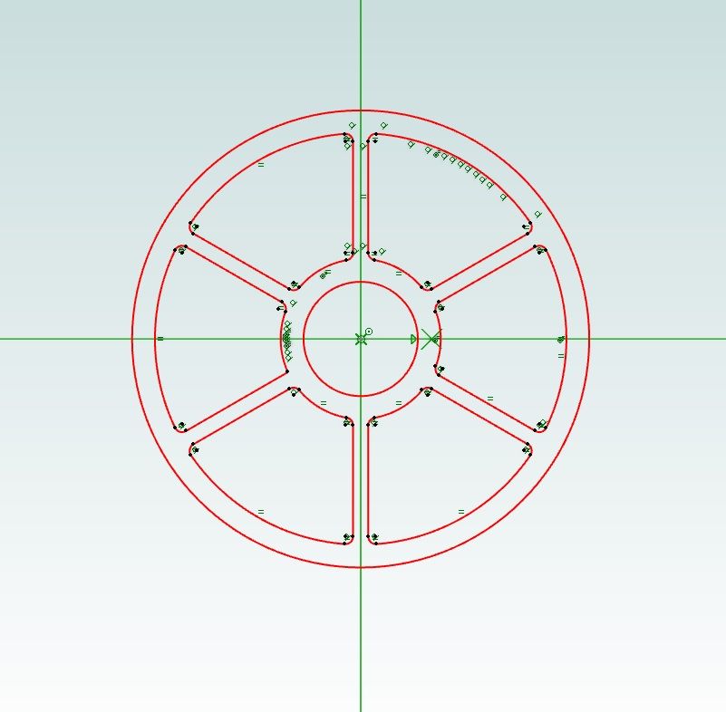

IanT12/04/2022 13:54:40
2147 forum posts
222 photos
Posted by SillyOldDuffer on 12/04/2022 13:07:31:
For example, starting with a sketch that models the spokes first creates a structure less resilient to change than one that cuts the spokes much later. Will the model break if the customer suddenly announces the reel's diameter should be bigger or smaller?
Let's see what happens in Solid Edge Dave....taking my existing Cotton Reel model...
Used smart dimension to select the outside reel diameter and change it to 40mm (from 30mm). I can do this because it is not a dependent dimension.
So then do the same for the internal diameter... (radius from 12.25 to 18mm)
Spokes still look OK. Might not have been as predictable if I'd tried to increase the internal diameter to exceed the external one first though. To be clear, I've only changed the two diameters here - nothing else was altered.

David Jupp12/04/2022 18:38:25
978 forum posts
26 photos
As others have pointed out, a 'quick and dirty' one off use model may be done a little differently to a model that will have the key dimensions re-set multiple times to produce variations on a theme (without throwing errors, or disrupting the topology).
Both have their place - there is no single 'correct' answer.
duncan webster12/04/2022 21:31:36
5307 forum posts
83 photos
My poor attempt, just noticed I've only done 4 spokes. Solid edge, draw half the outer profile on one face, revolve it, draw the Sector holes and centre hole on the top face, cut extrude.
I've used SE 2D before (quite a while back), but never the 3D. It wil take some getting used to but there are a lot of features to say the least.
