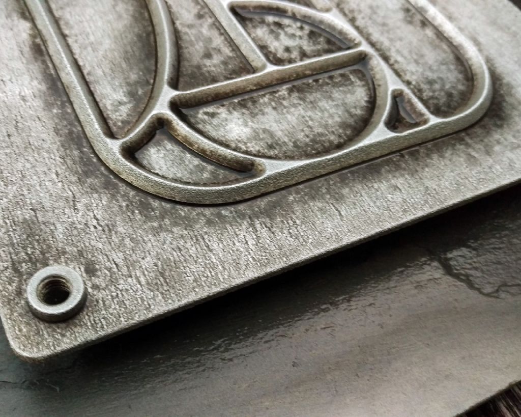

There is certainly some loss of crispness in the castings Noel shows, crumbling edges of the sand are often the cause just look around the back half of the rear wheel or where the sand broke away between the front wheel and the "E" of Reeves. It would really depend on what your client will accept
If the part is indeed going to be walked on then Loctite may not be ideal, It's OK on a decorative part as I've done similar with epoxy but in those cases it would only have been subject to light handling. These letters were "roughed up" to make them look more like they were cast.
PS that is not lettering stuck onto aluminium, just the machined background reflecting light differently

I did some tests a while back for a company who were after a bit of custom signage. That was CNC'd but I added a bit of patina to get a cast look (electrolysis and then acid) - it was in aluminium (pic below) - I get the impression that my customer's after crisp lettering for this job - perhaps I go with CNC-ing the brass and adding patina to the floor where the texture sits?

It might be worth buying a small piece of pb102 and seeing how it machines, although most sites as it is 20-25% machinable that is when compared with hard brass as being 100% and brass is very easy to machine. Different if they said it was 20% of tool steel!
As Noel say a lot will depend on how your client looks at things, I always spot things on photos of my work that I did not see in the workshop! The link I posted when I first mentioned casting the whole thing all look acceptable as nameplates and not a lot different to that red and black infilled one of yours. The paint hides the cast or machined surface so harder to tell the method used
