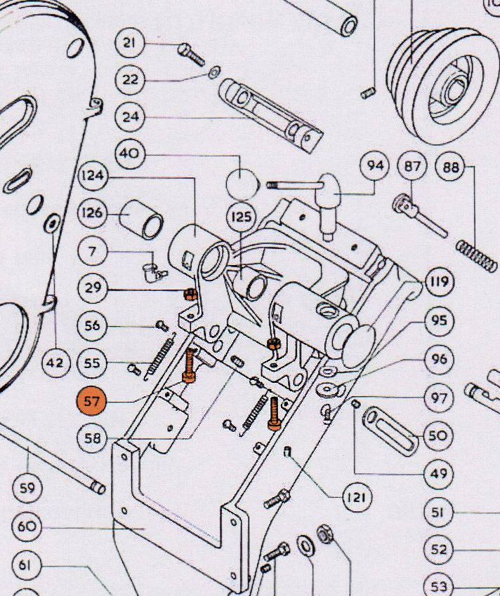

During these brief high speed tests I noticed a pronounced 'squeal' when switching on the motor... ultimately to figure out that the motor drive belt is a bit slack when placed in the high speed position. It seems to have a correct tension in the low speed position, but I could be wrong.
Does this indicate that a replacement motor drive belt is required?

Where is the adjustment for the tension of the motor belt located?

Two grub screws with lock nuts that rest on top of the shaft that holds the belt tension lever.

Michael, ... Are you referring to the two screws that I have indicated in this exploded diagram?

Yes , you use the screws you highlighted to adjust belt tension.

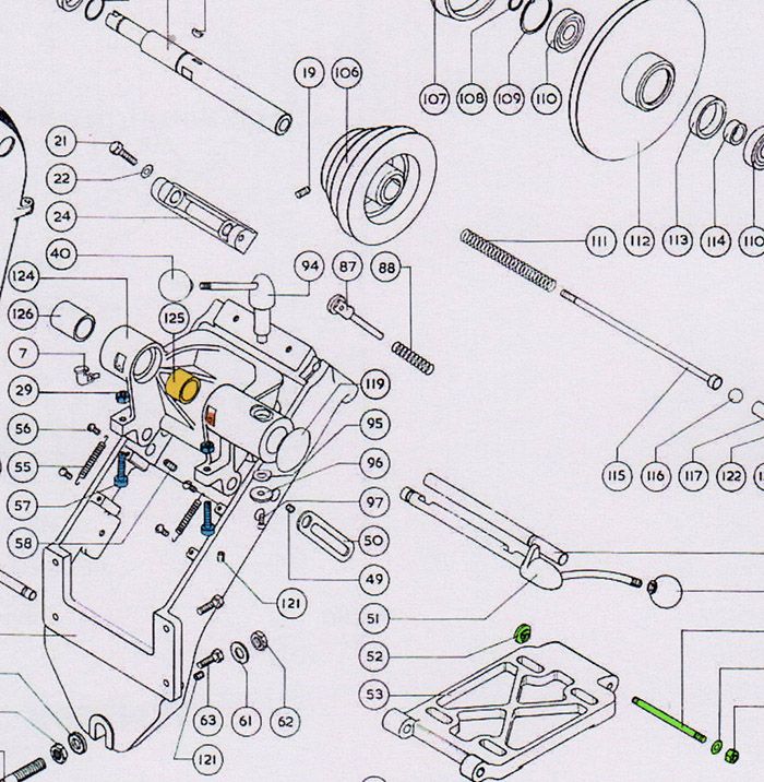

John, ... great suggestion to use the change gear retaining studs to check the hole threading. It turns out that the holes at 'C' for mounting a quick change gearbox are indeed M6. The others are 1/4 BSF.
Michael, ... I fiddled with the tensioning screws (indicated in blue below), but ultimately had to drop the motor a bit (shaft indicated in green below) as well to get the motor belt and counter-shaft belt tensions to balance.
In the process of testing it out I discovered that the counter-shaft bushing at the clutch control arm end ( #125 indicated in yellow ) must be pretty worn since the associated oil cup (mounted at red dot) empties out in mere minutes... or sooner.
Obviously, until I take the time to disassemble the counter-shaft/clutch assembly I won't know if I just need a replacement Oilite bushing or both that and a replacement counter-shaft.

Micheal, as Ignatz has pointed out the green bolt and nuts are for the motor belt adjustment, the blue ones are strictly for the layshaft pulley (106) to spindle belt tension.
