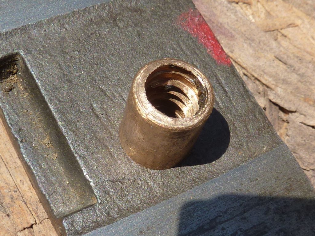

You mention a load of crud in the recess; are you sure the insert wasn't pulled in rather than pressed.
i.e. a bit like a top hat bush, with the grub screw just to prevent subsequent rotation??
Maybe screw in the leadscrew itself, almost all the way, and tap the end with a suitable hammer and a bit of copper to protect the screw end.

While heat cycling may loosen crud in the joint it requires cooling to loosen the insert - yellow metals have a considerably higher ceoff. of exp. than cast iron. I expect, if it were shrink fitted, it would likely drop out if immersed in liquid nitrogen.🙂

A simple puller made form bits would remove it.

After a good clean of the less accessible side of the insert in the saddle it seems that the hole behind the insert is 7/16 ( a good deal smaller than the front face of the insert) and there is no sign of a thread.
I decided that I was looking at a pressed nut and tried some cautious exploratory hitting on the end of my 7/16 brass bar. To my pleasant surprise it started to move before I chickened out.
So now it's out and pretty much undamaged I call that a result. Thank you for all of your input. Definitely a case of several heads being better than one.
The hole does indeed have a stepped recess.
I've miked the outside of the nut and (avoiding any potentially deformed areas) it reads between 5 and 10 thou over 0.5 inches... quite a wide range.
The compound will need a bit more thought because having cleaned out the crud it's clear that instead of a stepped hole the casting just overlaps part of the rear of the insert. I will need to make a custom punch to shift the nut but I'm not planning to mess with the compound until I've made some progress on the saddle. The saddle threads are pretty much trashed but the compound still has some life left in it.
For future reference I'd press the insert out or use the puller idea rather than hitting on the end of a brass bar but we will gloss over that for the time being.

Good result, now you have to decide what to do next, there is very little chance of finding a new one. If one is made, it would be safer to make it a just gentle push in fit and use Loctite, the cast iron is so thin on one side that there is a risk of cracking if the nut is tight.

Locktite will make future removal difficult if the rapairer doesn't know it was used. You might consider boring out the rest of the length so the new nut can be longer - last longer. Maybe add a second screw to secure it.

I think DiogenesII was correct yesterday. The hole is not concentric so the insert needs to be pressed into the casting and the hole and thread made in situ. So whatever thread I choose will need to be tapped I think.
Can I make a square thread tap (or three) myself?
No idea but I will give it a go. Worst case I will press the thing out again and go with a different option.

To find if the thread in the nut is concentric with the od, all you have to do is screw the nut on the leadscrew and see if it runs eccentrically. I would bet on it being in the same centreline, these big threads have a way of producing optical illusions. What is the OD of the nut?

So I went and checked... but I think it really is not concentric.
OD measured at between 0.505 and 0.511 depending on where I measured it (and that was avoiding the ends and the area around the grub screw hole).

I assume that you took it off because it is so worn that the backlash is unacceptable. When the thread is worn, the wear may well be biased to one side, if there are sideways forces, or even gravity. I realise just from seeing the dreadful design (only an idiot would bore a casting so close to the edge) that you worry about the concentricity, but would it matter if the replacement was made properly?

Yes I was thinking that it might be worth just making a concentric one using single point threading... although even then I will need to make a tool to do a square thread inside a 7.4mm (I think) hole. The front plate on the cross slide is hardly high tech - just a flat steel plate with the hole for the feed screw and a couple of 1/4 BSW fixing screws. The 'aim' judging from the old nut seems to be about 0.5mm left of centre.
Whether an internal threading tool is a sensible idea is debatable. I've seen opinions expressed elsewhere that 3/8 is below the size at which one whould switch to tapping.
I agree the design is pretty odd. I don't think Faircut had really got the hang of the whole lathe thing when they made this but one can't be too critical - mine has lasted 80+ years and is still usable... plus they have provided me with a way to refurb the cross slide nuts - a job that would be a more difficult proposition on a lathe with the threads cut straight into the cast iron.
The nut in the spare is on the verge of a complete thread breakdown which is actually quite useful because I now have no qualms about messing with it. The proper one is not so bad but there is still significant backlash in my cross slide and if I can make it better then I would very much like to do so... after I use the spare for practice.
