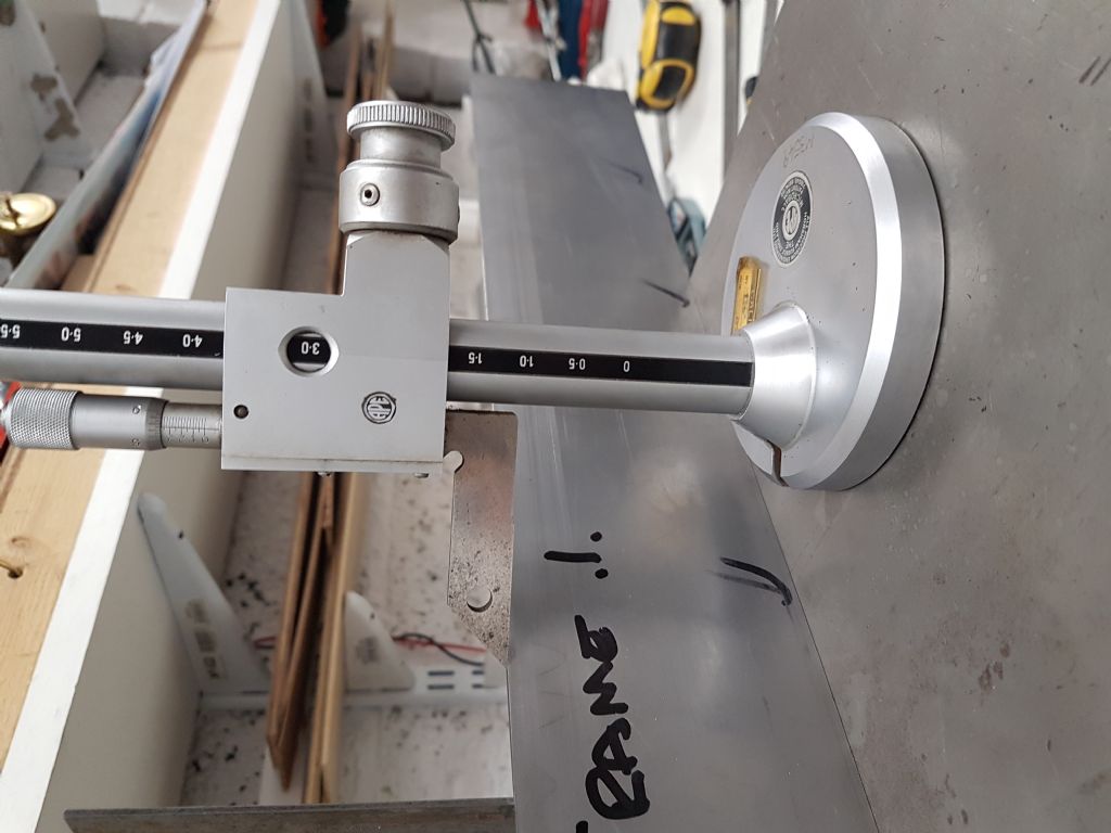

New (old) tool arrived today and I love it already. Been wanting a vernier height gauge for a while now. Checked it against a few other non calibrated measuring devices and there's 0.003" between 3 tools. The surface plate is old too so always going to be a few thou tolerance here and there.
APE Microball Vernier Height Gauge
Turns out my hand filing is 0.0025" out. Not too bad considering I don't have a milling machine yet. Obviously I want all parts to be 100% accurate but that's not realistically achievable in my workshop!

Posted by Iain Bachey on 27/05/2020 11:51:58:
Iain.
To be fair hand filing to within 2.1/2 thou isn't bad going at all for a "beginner", It can only get better but a read of this thread may prove useful to put your mind at ease, 100% isn't achievable in any home workshop. Its more a case of the parts fitting together correctly, been able to rotate a axle without it rocking in the axle block for example. For the body work (buffers) 1 or two thou will not make much visual difference, and id not beat yourself too hard for not achieving it to within a thou. just ensure that the buffers are marked up front and back and you use what will be the top surface to align the angle for mounting the frames. this way when setting up the frames there is little chance of the frames been built twisted. Frames assembled on the upper edge of the frames and buffers)
That looks a nice little height gauge. There are ways to asses the surface plate for accuracy yourself. though it rather depends on accuracy you want to achieve, to within a thou maybe two on running/rotating parts is good enough.
Ps keep the pic's coming, tooling is often forgotten in threads like this.

Hi Jon, thanks for the link, I will definitely have a good read.
This is a model engineering beginners project as I've never built a steam loco before but I'm certainly not a beginner at sheet metal work. Just that I usually work with aluminium
I will try not to get too bogged down with 100% accuracy as I will crack up obsessing over extreme tolerance!
The surface plate I own appears to be pretty good, a 0.0015" feeler gauge will not slip under a straight edge on it anywhere. It's a great tool combined with the new height gauge. If I can drill mark accurately then hopefully I can produce a straight loco!!

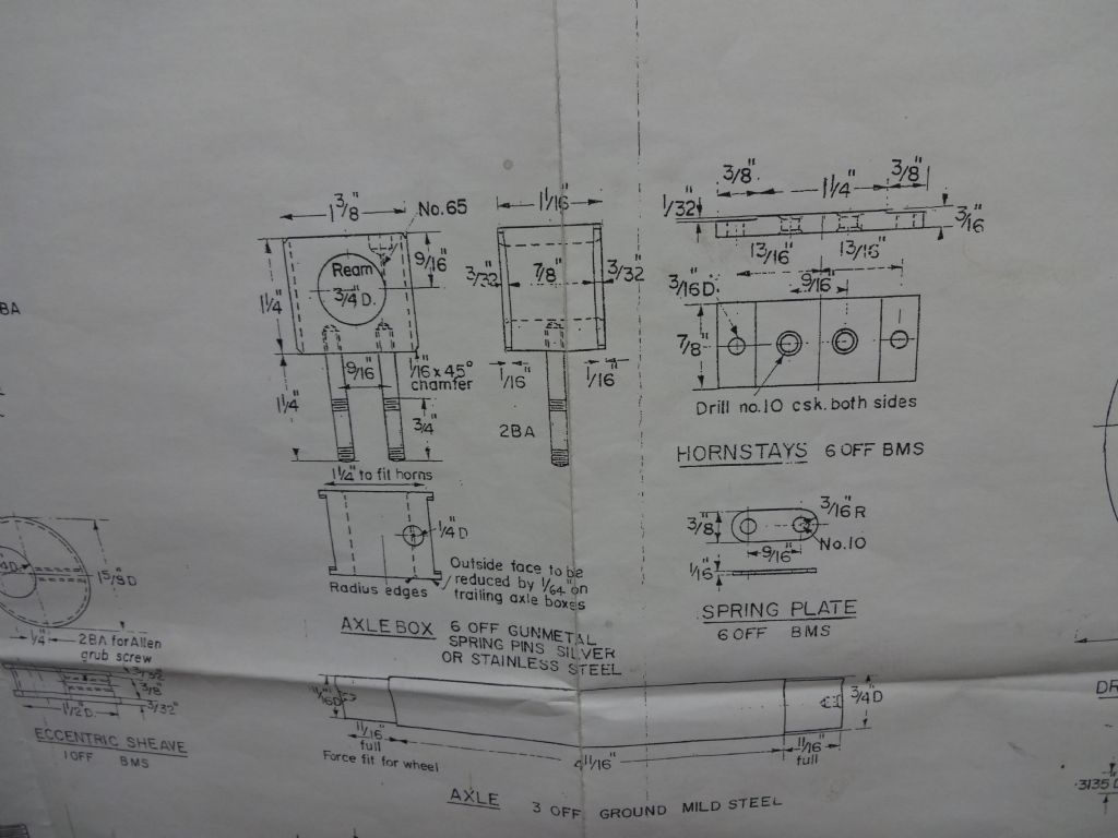

Old Crock28/05/2020 10:28:59
31 forum posts
18 photos
Iain, I guess you have been sucked into a Simplex build, like me, by oft repeated quotes on this and other forums, indeed by Martin Evans himself in the introduction to the build, that Simplex is a beginners locomotive. Let me assure you it is not! It could have been, it should have been, but in the current available editions (note plural) it is most definitely not for beginners. By beginners I mean novice first time builders like me.
Possibly too late now for you but for a beginners loco you could do no better than a Sweet Pea. It has simpler (Hackworth) valve gear, simple coupling and connecting rods, a marine boiler and, most important, easy access to all the mechanical bits once built. It also has a comprehensive build manual written by its designer Jack Buckler and I am not aware of any errors in it. Jack Buckler actually BUILT the first Sweet Pea. How many other designers actually build the first example of theirs?
Why is Simplex not a beginners loco. Simple. There are just too many errors, omissions and contradictions, all designed, perhaps not intentionally, to trip up the beginner. By the way the site for errors referred to by Jon in an earlier post is very useful but take it from me it only scratches the surface. There are plenty more.
A beginner expects to be able to construct a loco from drawings with everything to fit, possibly with minor fettling, and clear instructions. Simplex is not that beast.
It is no surprise that probably the most prolific part built models you see for sale are Simplex, usually close to but not complete chassis. Sometimes it is just castings where someone has given up the uphill task facing them. What does surprise me is the number of completed Simplex that are around and running successfully but I suspect they were built, or breathed upon, by experienced modellers, not first time builders.
What gives me the right to hold these views? Let me put my cards on the table.
I own a Sweet Pea. I did not build it, I bought it as a ready to run loco with certificates. However I have done a nut and bolt rebuild, redone all the plumbing, converted it into a 0-4-2 and other minor changes. I think know my way around a Sweet Pea.
As for building a steam loco I have never done it. I am a beginner, a novice in that field but I am fortunate to have quite a well-equipped workshop. As for Simplex I am building two! Simplex 1 as I call it I am building from scratch. Simplex 2 I acquired with a brand new boiler which is what I was really after. It came with a part complete chassis which was too good not to have a go at – I thought! It came into my life when my chassis was also half done. It opened my eyes to how two people can interpret the “same” design in different ways, but then it depends what you’re working from!
I have the luxury, or should that be the confusion, of having the full size Simplex drawings published by Nexus, the book of words by Martin Evans and copies of the articles from Model Engineer detailing the build.
I also have two friends who are/were building their own Simplex. One got so frustrated at having to remake parts he gave up. The other completed the chassis but the wheels wouldn’t go round, or to be more accurate the valve gear as designed prevented the wheels going round. It spent quite a few hours in the hands of a very experienced engineer (we are talking exhibition display quality) who by removing metal did get it running on air. A lesson to be learnt by beginners – have an experienced engineer to hold your hand – I am lucky to have a number in my club.
Iain, I hope I haven’t dented your enthusiasm (I probably have) but it pays to have a reality check now and then. Realise you are on a very steep road. There will be highs but probably more lows. If you have the patience, stamina and take advice you may just reach the top of the hill. I hope so.
Old Crock28/05/2020 11:48:13
31 forum posts
18 photos

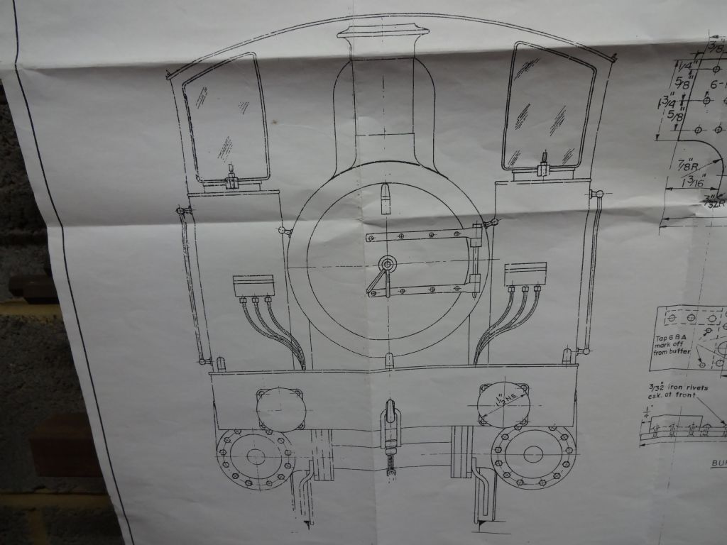

Having stuck my head above the parapet let me kick off at the beginning.
This is the full size drawing, General Arrangement front elevation. Notice those two “boxes” on the front of the side tanks?
Let us assume (we are a novice after all) that they are tanks with three pipes leading off on each side down inside the frames. I say assume because they are not shown or mentioned anywhere else on drawings or in text. As there are three on each side we can assume (again) that they are to lubricate the axle boxes.
This is the axle box. Note the lubrication hole is offset.

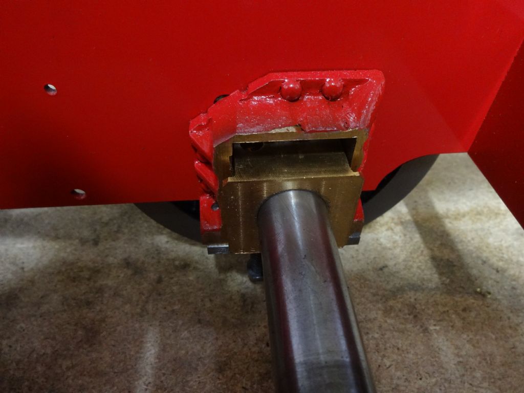

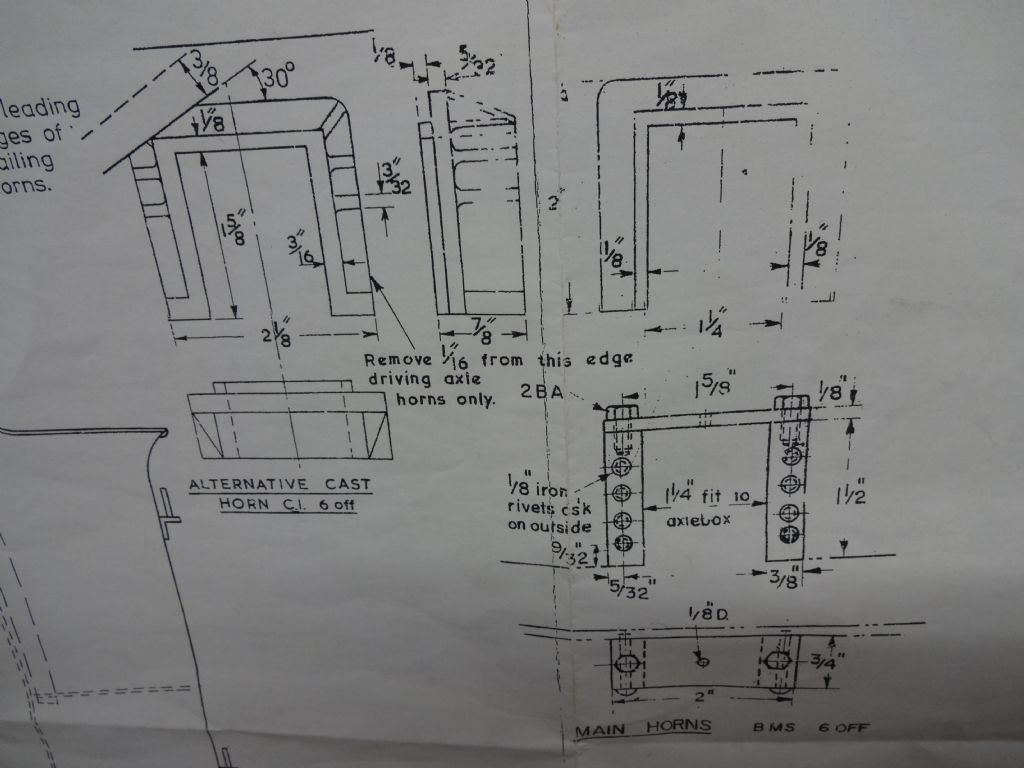

These are the horns. You have a choice. The cast ones have no hole for getting oil to the box. The fabricated version has a 1/8’’ in the centre of the keep NOT above the oil hole and no explanation as to what it is for.
This is the actual horn and axle box and the oil hole is in the gap. This is the rear driver which will, if it ever gets that far, be hidden under the boiler and behind the side tanks. Good luck getting an oil can in there. Lubrication of the axle boxes is pretty fundamental!axle box simplex 1.jpg
If the axle boxes are lubricated from the tanks referred to what size pipe? Does it rely on gravity? Where do the pipes run so as not to interfere with any other part of the mechanicals. Straight forward for a novice?

Old Crock28/05/2020 21:47:18
31 forum posts
18 photos
Jon, where can I find the errors on Sweet Pea? I did not build mine but I would like to know if and where it may differ from the original.
I know your point about self inflicted errors, I am sure we have all made mistakes but by and large they remain private! I am often told by my mentor about LBSC’s tendency to refer to earlier articles in his builds. Not many people have the space to store a full set of ME’s!
Your suggestions for oiling the axle boxes are welcome but the purpose of this thread was to point out the pitfalls for the novice. Most beginners will be well past the stage of completing the axle boxes etc before realising the problems in store for later.
Derek, the same issue applies. Sealed roller bearings are fine but they are not part of the design and are unlikely to feature in the novices thinking. You obviously learnt the hard way! A club member has suggested oiling through the axles as you suggest. Not an easy task when you have got past mounting and pinning them to their axles. Another vote for having an experienced engineer to hold the beginners hand.
My posts are trying to bring some realism to the “the Simplex is a beginners locomotive” mantra and to highlight the errors and omissions in the Simplex so let us move on ….. to the valve chest. Concentrate on the left side where the valve rod enters the boss.

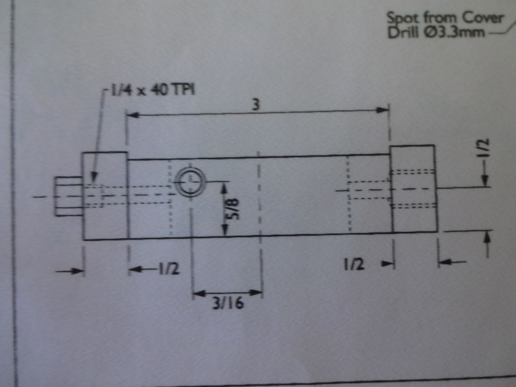

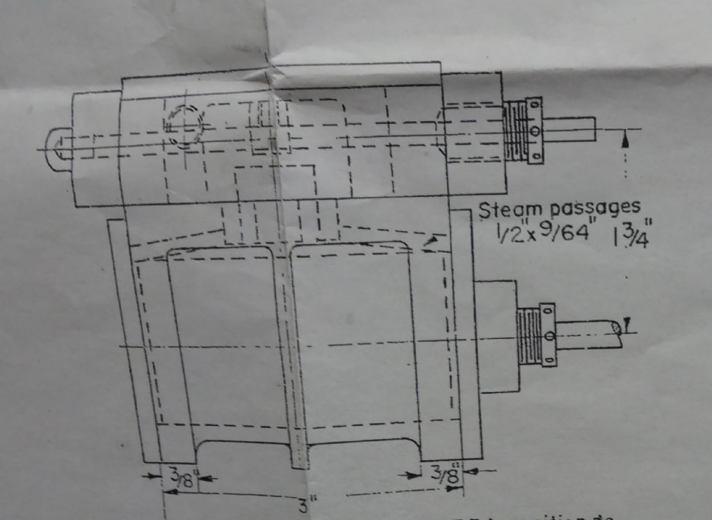

This is the full size drawing of cylinder and valve chest, notice the vertical line in the bore of the boss. To a novice is that important and if so what does it represent:

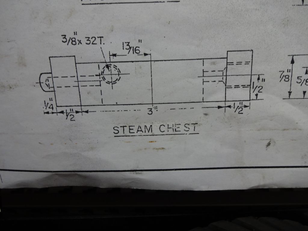

This is the full size drawing of the valve chest on the same sheet:
That line must have been a draughtsmans smudge ‘cos it has disappeared. Note to novice – ignore it.
Can you see any screw thread? The builder of my Simplex 2 could not either and made a close fitting insert to slide in the valve chest with a blind hole for the valve rod. No fixing shown and of course as soon as air pressure is applied the insert shoots out. Cured by some Loctite high strength retainer. However this design is contradicted by Martin Evans in the text where he says “This end must be tapped and plugged, using 7/32” x 40T tap if available, otherwise open out the last 3/16” to 7/32” and tap ¼” x 40T”. A contradictory case of do as I write not as I draw!
This is what the valve chest drawing should look like, taken from Terrence Holland’s series on a Fairlie Complex based upon Simplex running gear:
Keep calm and carry on!

Posted by Old Crock on 28/05/2020 21:47:18
At a guess, I'd say it represents the end of the valve rod, which is included in the cylinder arrangement drawing.

David Wasson28/05/2020 23:01:54
avatar
149 forum posts
43 photos
The "draughtsmans smudge" is clearly the end of the valve rod. The upper drawing shows the rod in place and the rod terminates inside the boss with a little space between the ebd of the rod and the bottom of the blind hole in the boss.
In the lower drawing, the "draughtsmans smudge" dissappears because the drawing does not show the valve rod in place, or the slide valve, or the packing nut.
