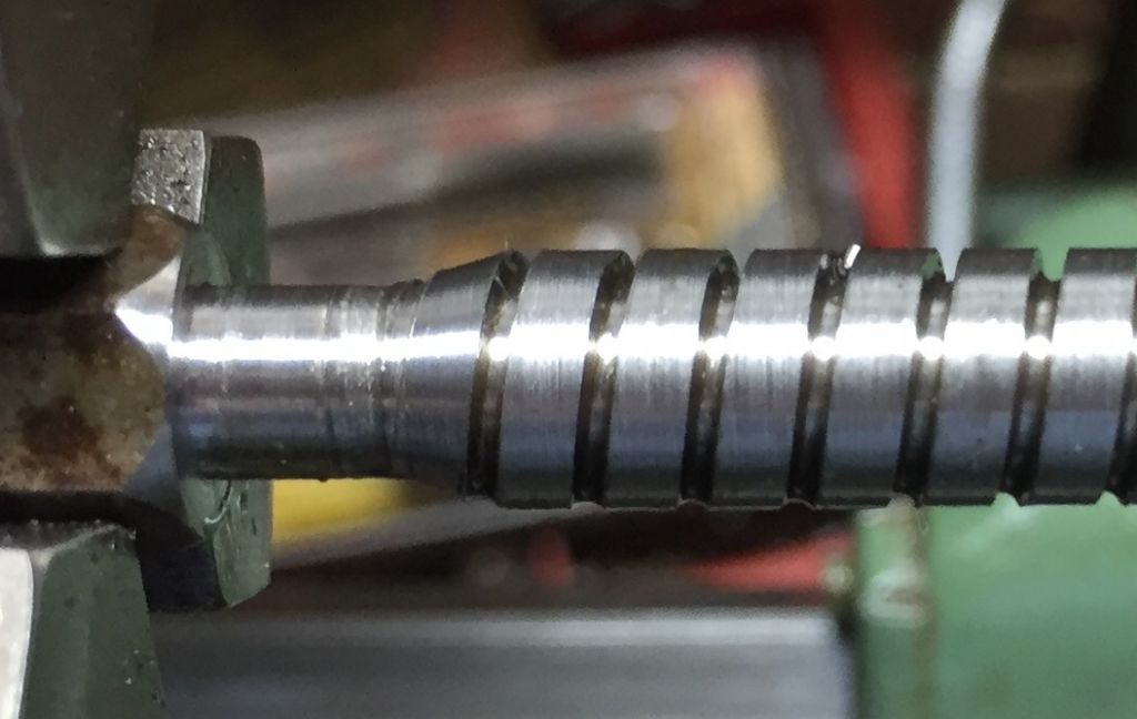

Since this thread has been running I have been making a mate a reverser screw for his locomotive. It is 5/16 diameter, two start square left hand. Each start was 8 tpi. The tool was about 1/32 wide. When I broke my cross drilled tool on the bms, I ground up a tool from 5/16 HSS tool blank, cutting out a block with the Dremel, and grinding to finish. Minimal side clearance for strength. Note that the toolpost is angled to the helix angles , which is quite a bit at 8 tpi. I switched to free machining steel, sacrificing hex, and put on modest cuts of 1-1/2 thou. Cut 40 thou deep. After the first start, I moved the top slide .0625 and cut the second thread.
The point is, it is very easy to grind up a tool for a job. Some model engineers, not necessarily the o.p., seem to be addicted to insert tooling. I wish they would grab a HSS blank and have a go at grinding a tool or two. They might be surprised how easy it is.

Posted by Simon Collier on 04/04/2020 02:04:16:
There's no need to waste time grinding to shape. If a lot of material needs to be removed (like the tool shown) use a mill to shape and then grind to add reliefs.

Posted by Simon Collier on 04/04/2020 10:35:29:
Would you use carbide cutter and high revs?
A carbide cutter is a must. General rule of thumb is run at the same speeds as ordinary steel, but with small DOC and high feedrate. Ideally the shear zone needs to be red hot. Just to prove it works here's a toolbit being milled:
In this particular case the milling was to achieve an accurate involute profile rather than bulk material removal, but the principle is the same.
