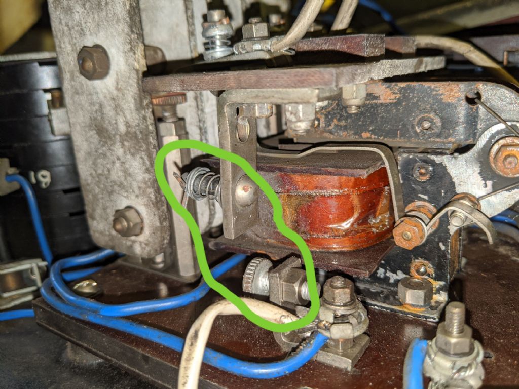

Posted by Robert Atkinson 2 on 27/11/2019 07:33:00:
Posted by Richard Kirkman 1 on 26/11/2019 20:03:27:
Posted by Phil Whitley on 26/11/2019 18:23:24:
I'm getting quite confused with all these terms. Specifically which part is the contactor, is it this part? And if its not this part, what is this part and what does it do and why?img_20191125_125101.jpg
Hi Richard,
The item pictured with 3 contacts separated by grey (asbestos?) insulation panels is the contactor. The contacts don't look great. If you can hear this clunking with the start lever operation the PC40 is powering it.
Do you have a multimeter / test meter? You really need to get into some fault finding.
First thing would be to check the contactor contact resistance you can do this with it unpowered by manually closing it , pushing down on the brown (Tufnol) insulator that carries the moving contacts and then checking the resistance across each contact.
Robert G8RPI.

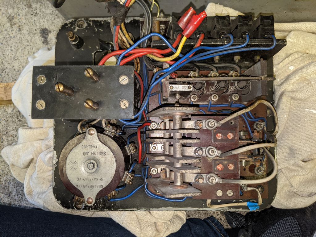

According to the circuit diagram the contactor has two pairs of 3 switches. One pair connects three phase to the pump and the other connects 3-phase to the main motor.
Contactors are electrically operated switches. Basically a low safe voltage is applied to a magnet coil that pulls the switch contacts together, and they do all the heavy lifting. Your contactor is very old-fashioned; everything is out in the open, making it vulnerable to damp and dirt.
Joining the dots:
  1. The contactor must be working because the pump runs (you think!) However, the contactor should make a distinct 'clunk' noise when it switches on or off, and that's not been mentioned.
  2. In the photo above I've labelled the switches. I guess the three on top (SW1,2,3) connect the pump. If so, the lower set connect the main motor. The rounded ends of two switch tongues can just be seen: I've labelled them Lower 1 and Lower 2. I believe the centre tongue, labelled 'Missing!' has broken off, so the motor has at least one of its 3 inputs disconnected. Given that the contacts are filthy, may be more!
Although the contactor may be of obsolete design, the control circuit is isn't! Much the same is used on modern lathe.
Modern contactors like the example above come in nice sealed boxes, rather smaller than yours, with no maintenance required. Entirely possible to replace the old contactor with a new one, the main problem being to identify one with a 240V operating coil, and six switches. They're readily available. (Ignore the annotations - they're for a single-phase motor.)

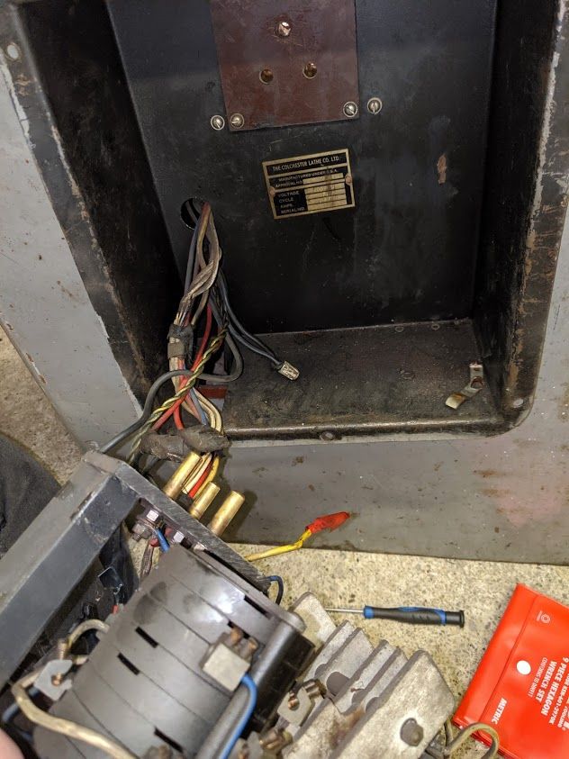

Dave, I don't think the pump does actually run. I just hear it buzzing, but I don't think it's a loud enough buzz for the motor to be running. But the point is it's getting some electricity
When I turn the on switch, I hear a large clunk noise. But I think that's just the noise that the switch makes. I don't think the contactor has moved apart from when I'm in there.
The tongue you mentioned is definitely missing, I hadn't noticed before. And I've only just noticed now, that another tab and contact that should be paired(the one that's broken in the bottom of the case) should probably go here?
The white/dirty white cable going from the bottom is the coolant pumps cable. So the blue wire has been put down there when it should be going onto the contactor above and have the tab which is loose in the bottom connecting the pump. Does that make sense to you? I'm just guessing sti, but it seems to be logical to me

SOD, I think you are mistaken.
''According to the circuit diagram the contactor has two pairs of 3 switches. One pair connects three phase to the pump and the other connects 3-phase to the main motor.''
The Colchester diagram shows the coolant pump being started directly from the rotary switch, by 3 of the poles, the other three poles are connected to the line contactor and thermal overload and thence to the spindle motor.
Hope this helps.

There seems to be some mis-reading of the circuit diagram going on here. The top set of switch contacts (6 off) in the upper part of the diagram all relate to the Santon switch.
Rotating the switch from 'OFF' to 'ON' just turns on the coolant pump and the contactor has no part in this.
Rotating the switch further additionally applies power to the terminals of the 'Motor Starter' (contactor). A contactor is used here to avoid the switch load on the Santon switch and to provide 'no-volt' release in the event of a power failure. It may also incorporate a means of disconnecting power to the motor if too much current is being taken.
I will leave things at that point rather than confuse the points made above.

Dave and Swarf Maker are correct - I've misread the diagram. A1 to to C2 refer to the Santon Rotary Switch, not the contactor! Please ignore what I said! Sackcloth and ashes again!

I am getting it wrong too! you lift the front lever to turn the lathe motor on, and push it down for off! I spotted this today when I used my lathe, you can't miss it really!. OK, time to drain the coolant sump unblock the pump, and see if it is actually running, or just buzzing. If it is actually running, we know that three phases are coming out of the converter.I think there is an exposed peice of pump shaft that you can see rotating, I will check tomorrow..
Here is the starting sequence, turn on the power, set the motor/coolant pump switch to motor, and lift the front lever with the red control knob, when you lift the lever, you should hear the contactor pull in, and the motor should run.
When you lift the lever, it operates the "limit" switch at the rear of the headstock which completes the circuit to the coil in the contactor, and the contactor pulls in, and the motor should start. if the fwd/rev switch is after the contactor (I suspect it is) then it may be that this switch is faulty. I assume you have tried switching between forward and reverse a few times, but if you haven't, do it with the power off, then try the lathe again. can you post up a pic of the contactor taken from square in front of it so we can see all the contacts and connections (several pics not objected to!), and also a general one of the headstock controls, and the motor panel, so we can see what we are dealing with. We will get to the bottom of this!

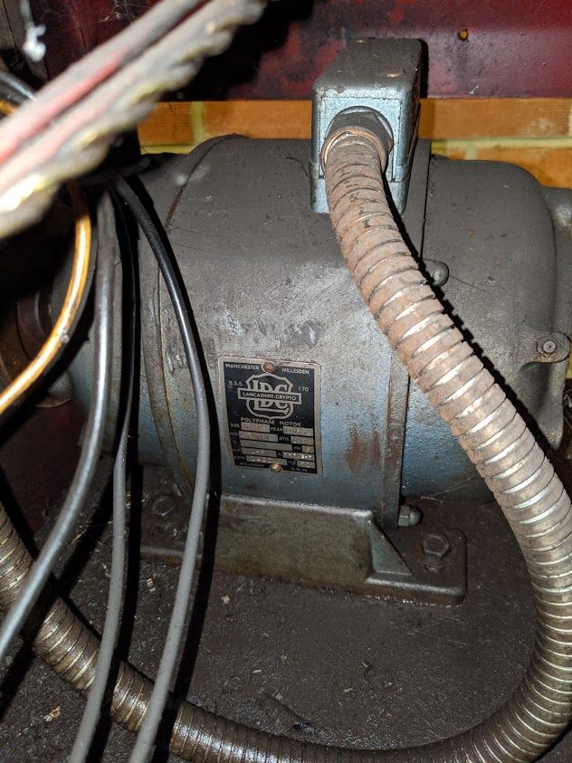

Can't get any more pictures of the lathe till the 13th, but i think i may have a few other pictures somewhere

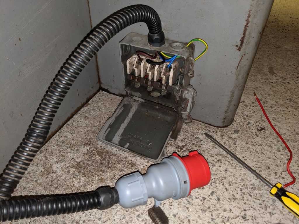

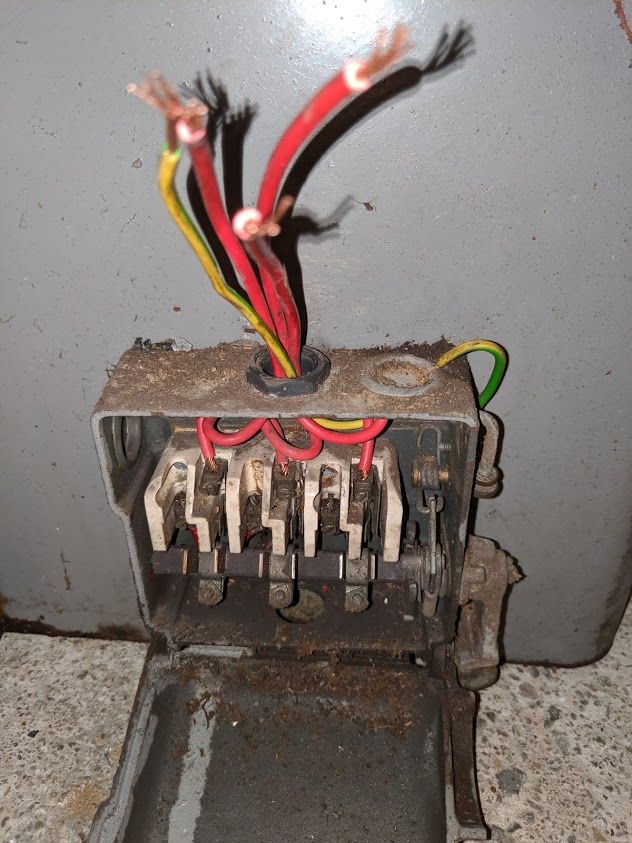

Thats the isolator box i had to wire a plug to when I first received the lathe, not too relevant I don't think, but just covering all bases, as there could be issues anywhere
And that's how i wired it, I think it was 2.5mm 4 core. So as you said that should be earthed?
Looking closer at the motor plate it says its from 1955, so quite old. It also says if i read it properly that the motor is 1.5hp. perhaps the earlier models had smaller motors. I will double check this when i'm home as the picture isn't the best. However, if it is 1.5hp then perhaps a 3.5hp static converter will be enough to power it for now (especially if Mal said his powered it for a few years)

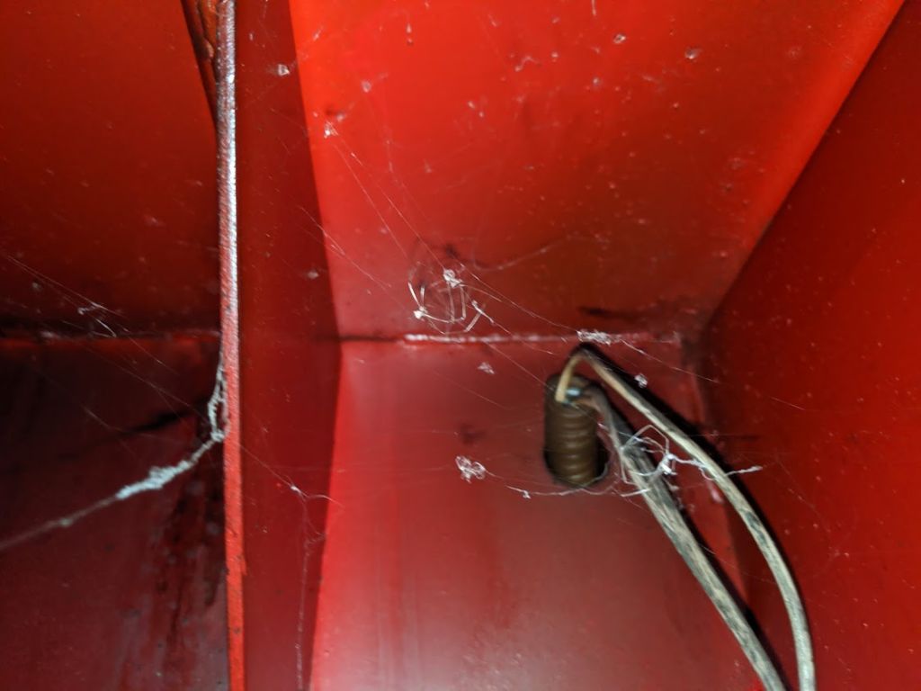

This is where the wires leave the control board and lead through the casing to the coolant pump, just the 3 white wires

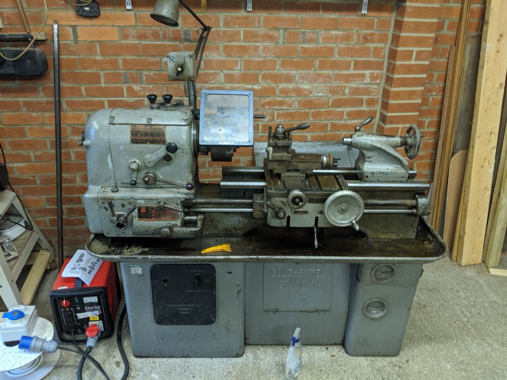

That's the lathe itself, still has a lot of cleaning to be done, but need it working first. As you can see, my forward reverse switch is not original like on your lathe Phil.

Well, I see the nice new cable with its plug going into the big switch box. What I don't see are any wires coming from the output contact set of that switch and into the lathe itself. Are they routed through the backplate of that switch? There is a hole for the wires to come out but nothing visible.

Yeah they go out the back into the casing, don't have any pictures of where they go. Not too sure if I even know where they go, but it shall be investigated

Right, there are several areas of the contactor I am not happy with, mainly, as everyone else has noted, the middle of the three contacts appears to be missing, but I can't be sure of that, it may have been modified so that it still works. When I first saw these pics at the top of the post, I thought they were examples of a different lathe, not your actual machine, I see from the ones you have just posted that they are yours. I will pull my control panel tomorrow, and have a look, but I think mine has the later contactor (Crabtree?) fitted. Below the plug in pins on the board, you see three coils, these are the overload tripping coils. the long straight bit of paxolin that goes across the top of all three appears to be a manual reset, you could try pushing it up from the bottom end, where the long arm sticks down, and see if it clicks and closes the overload contacts, may have tripped out if the phase convertor cannot produce enough power for starting. There are various areas on the whole panel that look to be overheating, or have been in the past, and TBH, rather than try to repair it, it would be easier and quicker to take the old contactor off the panel, and replace it with a modern one, keeping all the outside controls as original, but putting new guts inside! having said all this, if two phases are getting to the motor, it should growl and try to turn, and if the contactor is not pulling in, the overloads are irrelevant, as they come after the contactor in the circuit, and the way you have described it, the main contactor is not pulling in anyway. they are LOUD!!

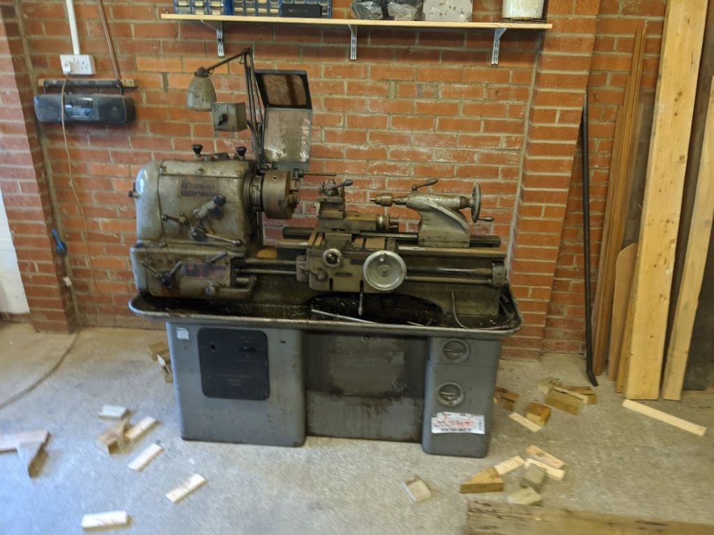

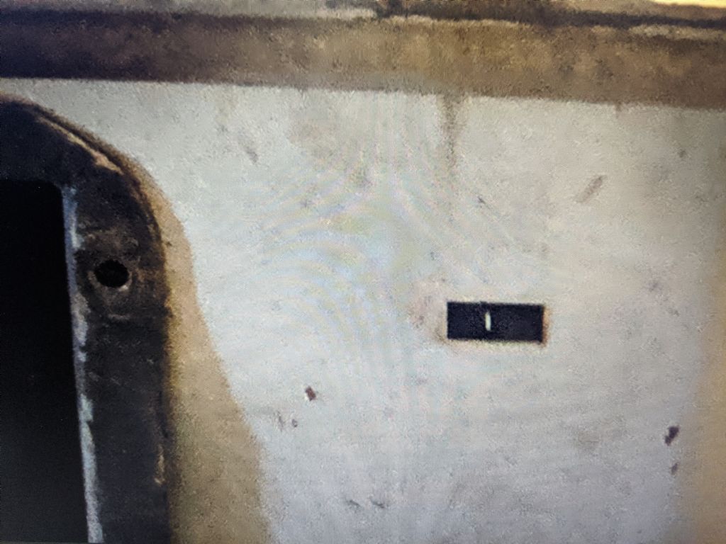

The picture of the lathe appears to show a hole, but its just a small sticker that has a 1 on it
So I'm pretty certain that it has never ever been dual speed. The motor is definitely original too, so I don't think its a possibility.

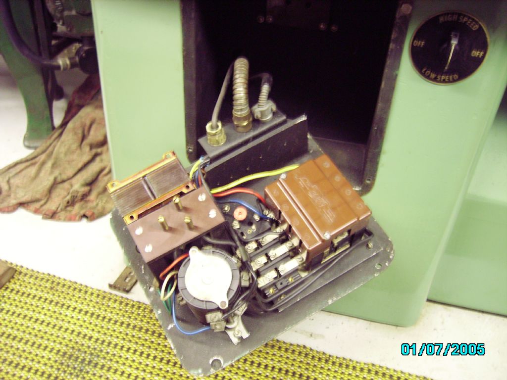

well richard here is the internals of mine, for what its worth !(not a lot as it is different), the start stop lever does work as I said earlier, if you put power on to the lathe with the start lever in the up position, the pump will run, but the main motor will not, until you press the handle down then lift it up again.
Looking at the pics of your contactor,The three black wires connected to the terminals to the right of the three pin plug, on the overload coils, go to the motor, the three blue wires connected to the other side of the overload coils are the feed from the contactor. You should, with a multimeter, be able to test three seperate phase wires from the isolator switch (check the action of the switch to make sure all three blades are going in to the contacts properly) on the back, through to the three pin socket in the back of the control box, then test from the pinsof the "plug" part to the rotaty switch , out of the switch to the contactor, from the other side of the contactor to the overloads, and then on to the motor, via the reversing switch. The missing contact on the contactor is irrelevant for now, as the contactor is not even pulling in, and it should do this even if it only ends up sending two phases to the motor because of the missing contact. When you have established that three phases are getting to the input side of the contactor, check that you have continuity through the contactors operating coil, and then you will see that one side of the coil is connected directly to a phase and the other end of the coil goes off to the safety switches on the gearbox end cover, and then to the "limit" switch on the back of the headstock, which completes the circuit to pull in the main contactor. Looking at the oily state of the limit switch that could be full of muck and oil, and not making contact, take the lid off and check it, I am going to try to post up the wiring diagram from my lathe, although the contactors are different, they are electrically identical, and this diagram is somewhat easier to read and understand.
