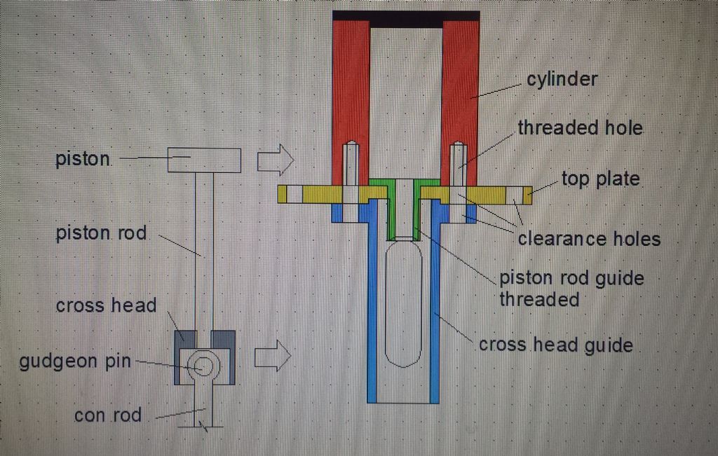

One last post from me with a diagram I did last night.
As I understand it, you have a cylinder whose bottom hole is s slidefit for the piston ron and the top has a registration plate which fits into the underside of the plate.
Not quite like above Iain the piston rod guide is separate from the cylinder. The register is on the underside of the top plate.
Have a look at the jepson drawings on plans-for-everything.com and also the drawing with this post.
Hope it helps you Geoff see also the photos of the cross head

Geoff - I much appreciate the drawing - I get it now! However I wasn't quite sure what the bottom picture was of.

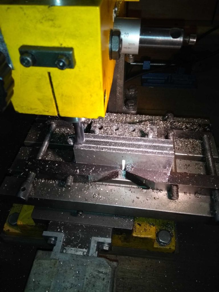

Square up the pieces and mill to approximate size.
This was my first attempt, but I realised on checking that something was wrong and it turns out that my angle plate does indeed have an angle, however it's not right. Not a right angle that is! for the crank I ended up using my angle table and setting it at right angles with a 20 40 80 block.
With this and the journal I found I could get my measured end with a thou (0.02mm), but that the other end could be up to 3 thou out (thats over about 100mm or so). Not precision engineering, but I suspect a decent result with a CMD10 micro mill.

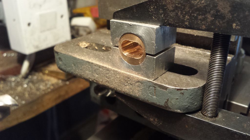

Journals: Done! Main Shaft. Done!
Pin bored out to 20mm. I must say I'm seeing the same thing with this bore. The outer diameter is just a little bit bigger than the inner one (by the faceplate). The only thing I can think is that the head isn't exactly in line with the ways that that might be awkward to fix.

Posted by Iain Downs on 08/12/2018 17:48:25:
... must say I'm seeing the same thing with this bore. The outer diameter is just a little bit bigger than the inner one (by the faceplate). The only thing I can think is that the head isn't exactly in line with the ways that that might be awkward to fix.
Another possibility is 'spring' of the boring tool ...
Have you tried a few finishing cuts with the slide locked at the same setting ?
This will often produce tiny slivers of swarf [from the depths of the hole] for several passes.
End result will [should be] a less tapered bore.

I have run back and forward a few times with the same slide setting. However, I have to say that I can't see what's happening at the bottom of the bore so it could be I just need to keep trying.
I will to a trial bore with some scrap and see if I can get it better. Now you mention it I think I had a similar discussion when building my oscillating engine.

You need the tool to be really sharp to get the little whispy cuts that Michael mentions, if the tool is even slightly dull it will get pushed off of the surface.
