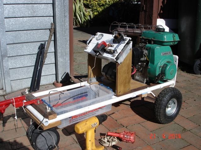

My home brew portable gen set uses a 3hp Kawasaki motor to a car alternator, and I can get about 500Watts out of it, I have an inverter for it, but I'm yet to try it on the fridge. The base that the unit is sitting on doubles as a sack barrow, and is rigged as a trailer to be towed by my bicycle. I can boil enough water for a cupper in about 20 minutes
Ian S C
Edited By Ian S C on 18/02/2018 09:28:19

The little gen set cost very little, I'v got 3 or 4 alternators, the motor came from a garage sale $NZ10, the wheels on the sack barrow $NZ13 each, every thing else out of the junk box. Automotive alternators are inefficient, and a better genny could be built with little difficulty, with that I would expect to get about 1.5k Watt with the 3 hp motor.
