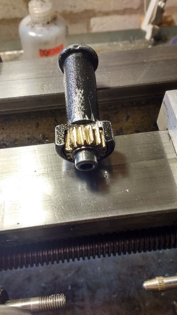

I think Roy is more likely to be right than Nigel, now that I've examined my threading dial in more detail. Jon
Seems both can be right !. Myford ML7 Manual mentions the Fibre Washers are provided for alignment of the Dial markings with the zero mark on the Indicator Body (page 28, fig 39).
They (washers) can also serve to provide suitable resistance to permit engaging and disengaging of the indicator with the Leadscrew by hand pressure as many have found to be a handy procedure, but is not mentioned in the Manual.

Thanks for the reference to the figure in the manual - I obviously don't know that manual as well as I should.
When I look at other indicators on ebay they clearly don't have a capscrew holding the pinion gear on, which would obviously change the adjustment possibilities dramatically.
and
I am therefore beginning to wonder whether my thread dial indicator is either an old one or has been modified because it still seems to me to be much easier to align things by adjusting the retaining screw than trial-and-error with fibre washers that will compress over time. To boot, mine is also missing any fibre washers.
