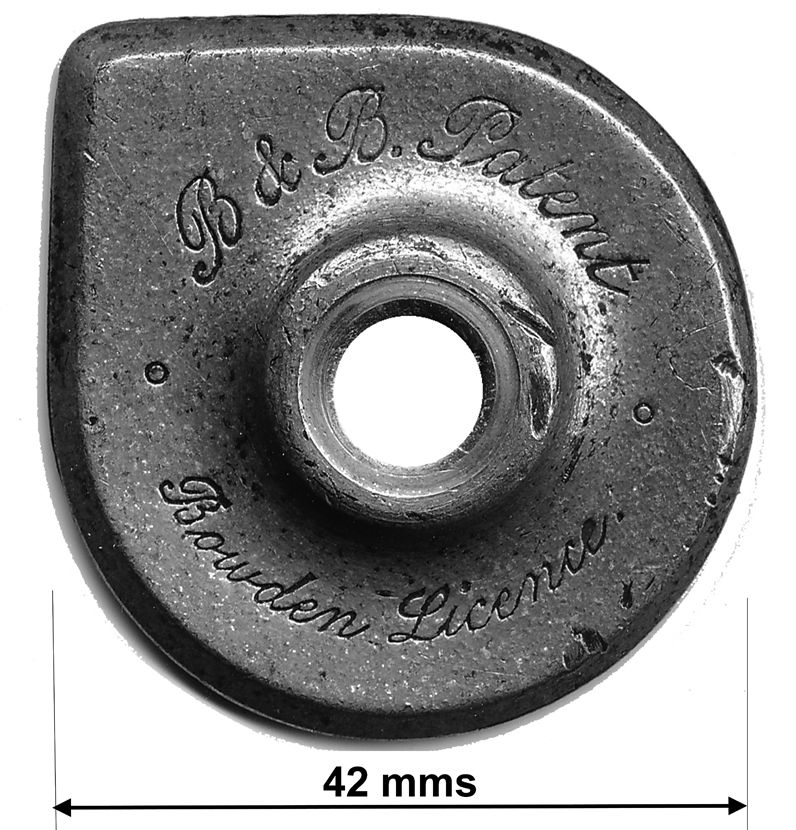

On an early component such as this, how would the lettering have been acheived? Some kind of pantograph engraver or a stamp? ...or even hand engraved?

Often die-cast.

For a small company like B&B at this point in time, early 1900's they would have been hand engraved with gravers. There was a lot of pride in workmanship in the Edwardian period

For anyone else who might be interested! Brown and Barlow were formed in 1902 and merged with Amac carburetters and Binks ditto in 1927 to form Amal Carburetters. The name, trade mark etc have not been registered since around this time.
B&B never made a die-cast carburetter, only brass and the first misadventures in this direction were made by Amal in 1933
Whilst the very early B&B carburetters might have had engraved trade marks, certainly by 1909 their markings were always stamped in. B&B were quite a successful company and their volume of production was so large that engraving each one was probably not feasible.
The control lever photo posted by John Hinkley (thanks John) is actually a 1920's design but mine is earlier, flat topped and has the legends B&B Patent and Bowden Licence stamped in
Regards, Chas

When I said hand engraved I meant the pattern, assuming they were cast in but a steel punch would probably do the job better.

Well Chas emailed the logo through and it's definitely proprietary but good news it it will scan and clean up fine once I can get back onto my desktop machine.
Once it's cleaned up be a Simples job to mill two plates up in brass ( one a mirror image for LH side ).
Chas can then adopt these for his lost wax pattern and get them cast.
Another happy punter and no armchairs were harmed in this exercise.

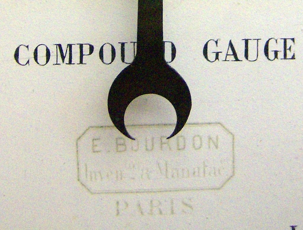

Here's a nice (Mid 19th century) example of a trade mark stamped into brass and ink-stamped onto the dial of the same instrument. Both very similar but not identical.

Whilst both are right Neil, the purists in the vintage world and they are as bad if not worse than Muddle Engineers will only accept the original on the part no matter how different it is to printed matter.
It's a given fact nowadays that any vehicle entered into a concours competition is far superior to how it left the factory.
In those days sales and getting stuff out the door meant more than polish.
