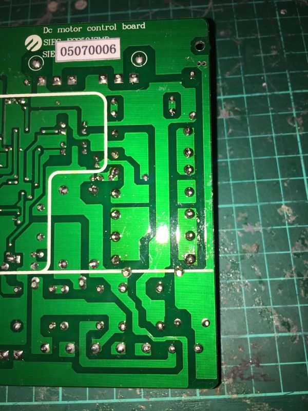

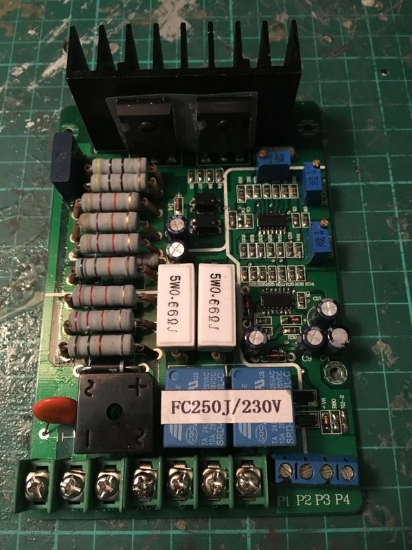

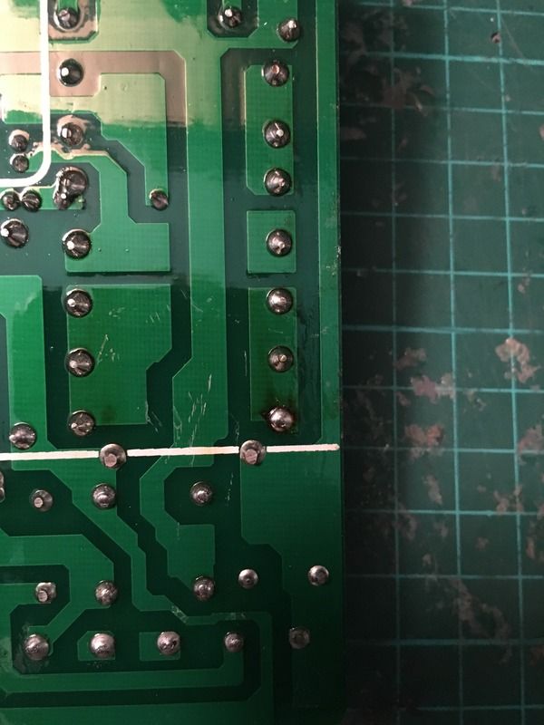

zak moussa25/06/2016 19:58:19
17 forum posts
This Resistor looks blown but the multimeter does give a reading
 photo E623DD60-6922-4BF2-903D-6FB95823DF6B_zpsci5hr87b.jpg photo 82F77566-DDD4-4A4F-A61B-2B6BBA0FBE2F_zpsi6js5ne7.jpg

Hi,best bet is search eBay for a generic motor control board,i found one from China £18. And had no problem since.just check the output against your motor size,,mine was 300watts.good luck!

Hi, Zak - I'M with John Swift on this one. You say the motor seems to be OK, so it is almost certainly the two FETs bolted to the big heatsink that have failed - it happened to me about 6 or 7 times. There are newer control boards available which seem to be able to withstand overloads much better than this older type. You can proabaly get the newer one from ARC. The FETs are cheap enough and it only takes a few moment to unsolder and unbolt them to fit new ones - they are not too difficult or expensive to buy (try Maplins). It is worth a try before paying ~100 pounds for a new board.
If you have access to an Ohmmeter, there is usually a short circuit between two or more pins of the FETs - usually dead short, only a few ohms.
zak moussa26/06/2016 10:52:32
17 forum posts
Posted by An Other on 26/06/2016 10:40:43:
I have a meter and your right the first and middle pin is short on the second fett, compared to the first i am assuming they are the same rating
I will go to RS and buy two fets swap them over and see if that makes a difference

John Rudd26/06/2016 17:38:46
1479 forum posts
1 photos
Choose a controller carefully....
They are not all the same....you need one that is suitable for a dc motor....
The mosfets are IRFP460 from memory, you buy them from ebay cheap enough if you can wait a few days or pay RS prices...the printed circuit board although uses thru hole technology, when it comes to removing components be careful. I suggest you unbolt the mosfets and cut the leads close to the body, then use thin nose pliers and a decent iron to remove the legs. The printed tracks are easily damaged- first hand experience, I've repared a number of these and other Chinese boards..,,,

Hi Zak,
In some ways your post reminds me of another Londoners post on here, who has the same problem as you. Make yourself a big flask of your favourite brew and go through this link
When you purchased off Gumtree, was it working fine, had it been used regularly?, do you know if there were sparks flying from the motor, or had the machine not been used for a while, parked in a cold and damp shed?
When things went 'poof' as you say, what exactly resulted in it going 'poof'? Had you correctly engaged into the hi gear? Had you checked that the machine worked correctly in both settings when you bought it from the seller? did you dig in into the material you are trying to turn?
This circuit board has no overload protection. To the best of my knowledge, non of the brushed C2 = CL300M mini-lathe do. Same applies to ALL of the cheapest option brushed model control boards in the market place. Simple way of checking is usually there is no fault light on such machines - I think. This means that overload can blow the board, being it from abuse/abnormal use due to lack of training, or dirty power. What is the quality of power in your area? what is the quality of wiring in your premises?. For anyone who has a C2, we always recommend use of a cheap surge protector plug fitted directly to the wall socket to which the machine is connected. Replacement control boards are supplied without guarantee or warranty as they are tested before dispatch. 25% of buyers still blow them because they fail to carry out the correct tests on the motor, or proceed to abuse/carry on regardless etc...Then we get into any argument!....hence one of the reasons for the price being what it is. You can read into that as you wish
Did you ever buy a £20.00 car battery to carry out the test on your motor?..your picture suggests that you use a 'small battery' to test the motor. How fast or slow did the motor turn when it was connected to this battery? All you say is that the motor turned, which means nothing by itself.
You suggest that you are ok with electronics in your opening post. Are you competent enough to use a multimeter, soldering iron, solder (original leaded may be), and do you have access to it?.. Your machine is old. The FC250J board came out before the XMT...before lead free solder. Old stocks of such boards are still kept and sold as spares.
If you proceed to replace MOSFETs, do consider using higher rated MOSFETs. This was discussed in the early days, i.e. long time ago, but I can't remember which MOSFETs as ARC moved away from repair/upgrade a long while back after leadfree came into play. I can't guide you on this as I am not competent to advise details. All I can remember is that it had something to do with compensating for over voltage supply from dirty power. The current MOSFETs are correct, but they 'might not' deal well with unregulated supply, and you might end up in the same place given all the factors mentioned above. So, when one considers to blame such boards, do also consider to take into account ones own abilities to use a lathe, and un-regulated power.
If you consider a generic control board, only do so if you really know exactly what you are doing. Otherwise, save yourself some time, read the long link thread mentioned above, in which all the good, bad and ugly ideas were discussed over time, and note that there seem to be continued issues relating to that project. I say this with the greatest of respect to all concerned.
By the way, please don't think about asking ARC for different boards or motors as an upgrade to yours, as unfortunately this is not something we can offer. We only carry like for like replacements and we are unable to give guidance or advice on alternative replacement projects.
