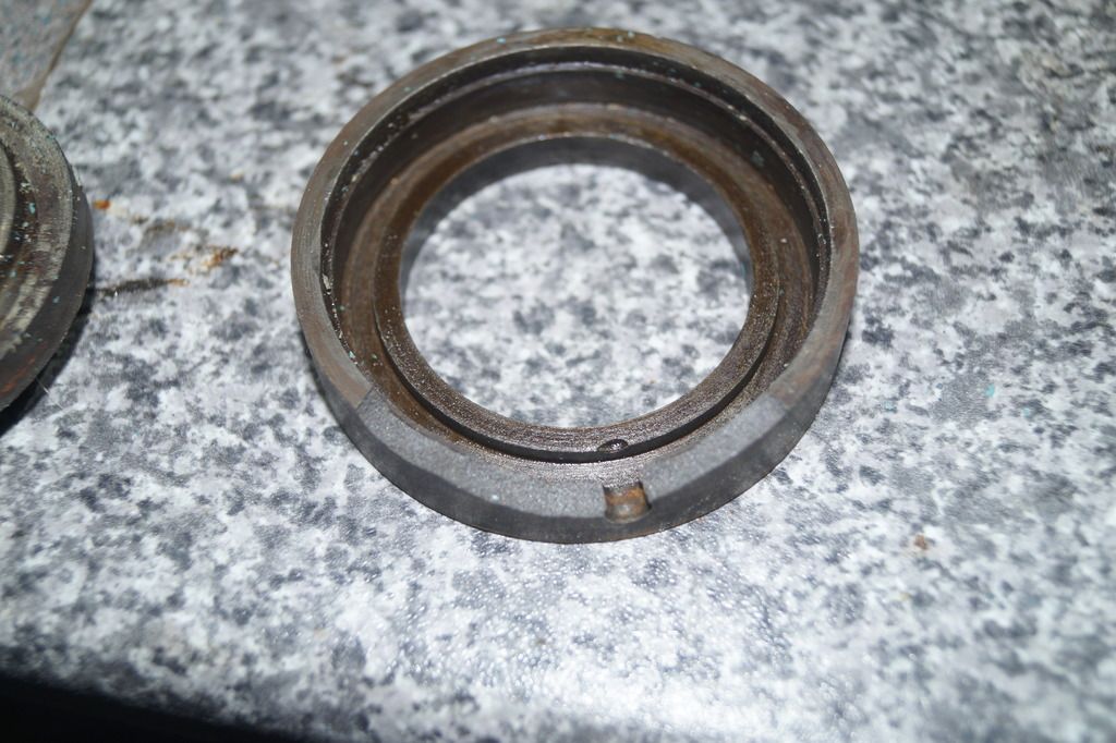

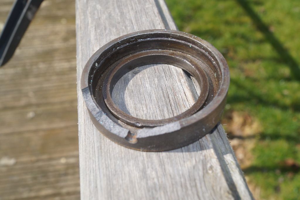

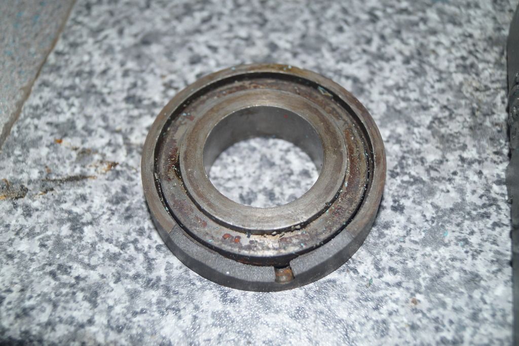

although ive found some damage , this sits under the top bearing that supports the shaft, its held in place by a pin and a grub screw. is it possible to get one made up? (i would have a go myself but lathe still not finished , waiting on myford again)..... spares dont exist for this!

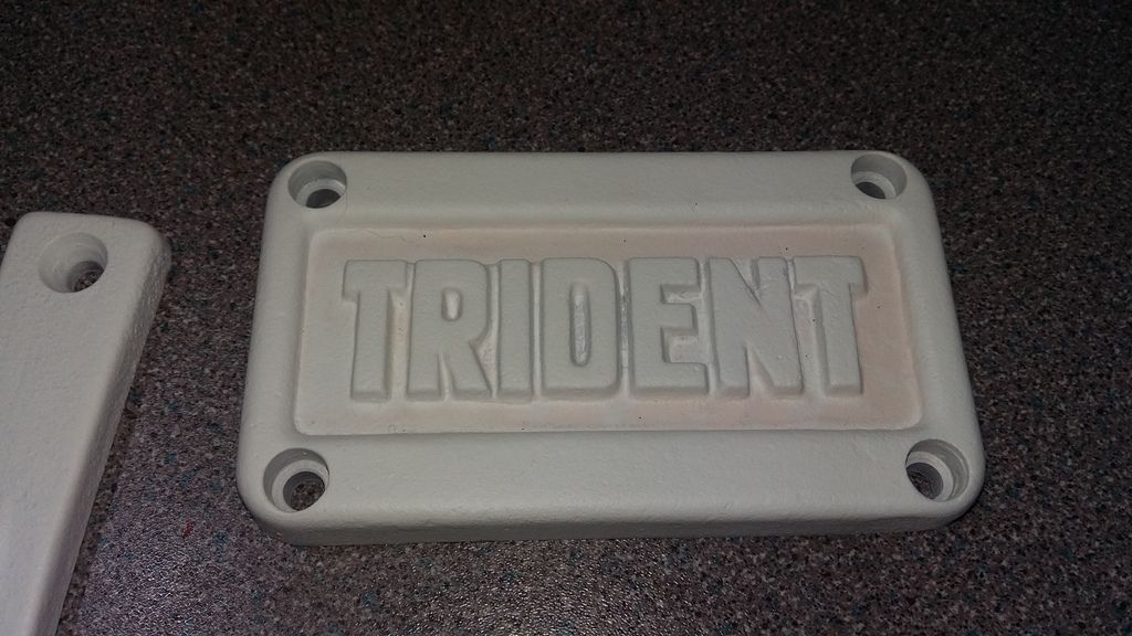

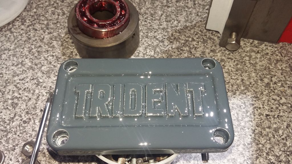

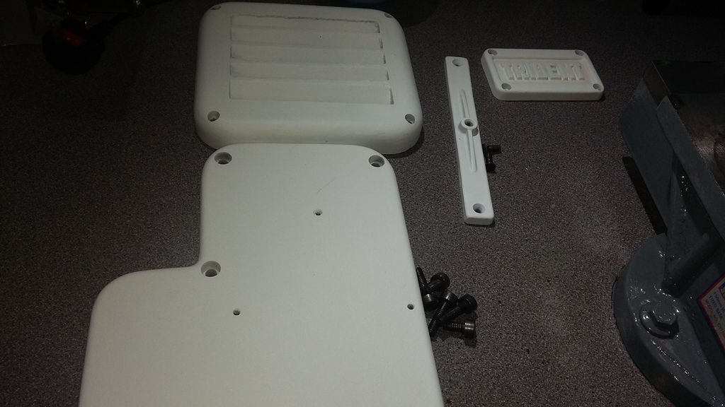

and some covers that have been taken back to bare iron and primered.

Ajohnw02/04/2016 22:52:30

Great work. It's good to find bearings in them and probably will be worth replacing them. I looked at one once but it turned out to run in cast iron. It was a bit smaller too.
What is the damage - all looks intentional to me ?

sorry john picture was terrible , here is a better one in the daylight !
its looks like cast to me , but i could be wrong

hopefully somone very kind will be up to the challenge!

Anyone feel they can help me by making one of these ?

Thanks very much John , dont mind paying for metal , time,  postage etc , but cant put the head back together without it, if my lathe was up and running i would have a go myself all bearings are on order and should be here next week, timkin came out so timkIn are going back in ....
Please anyone that feels they can help make this spacer get in touch and i will be forever in your debt !

Well progress at last , found a very nice gentleman called dave bryant who has made me the spacer to replace the broken part in the vertical head . Pics below

Oh plus finally found the original colour .
Needs x2 coats but finally colour !
