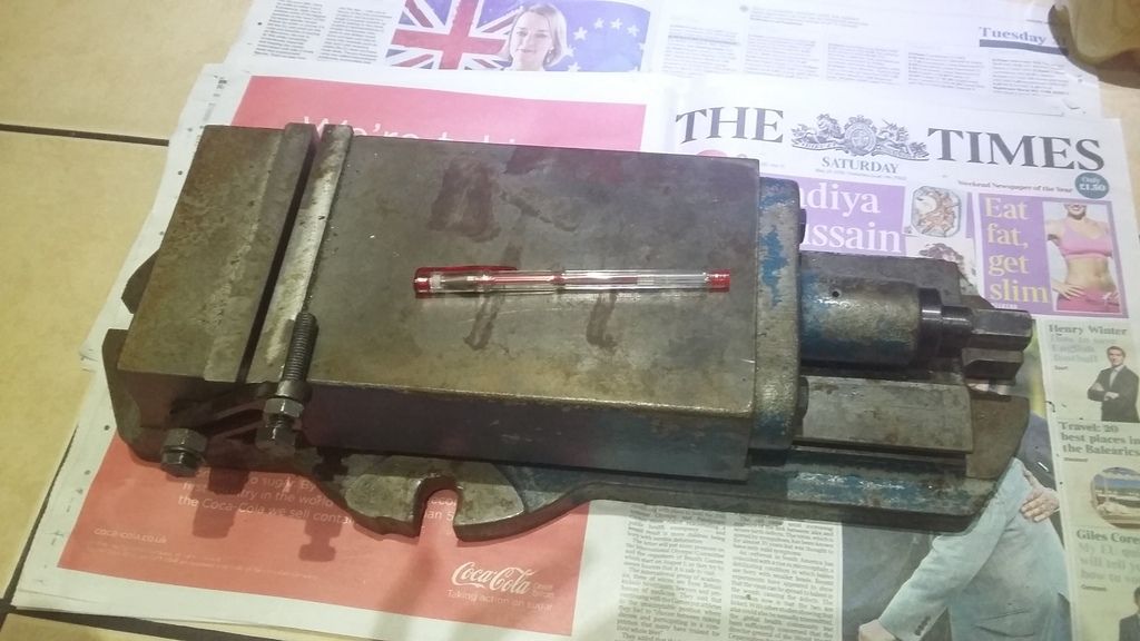

finished the vice off , seller said it opens to 4", that was only because of all the swarf in it , now it opens to 6.5"

on another note i found a nice vice for it .....
thought i would strip it as its nowhere near clean enough for me , and needs a lick of paint.
good job i stripped it !
more pics when its been cleaned / painted!

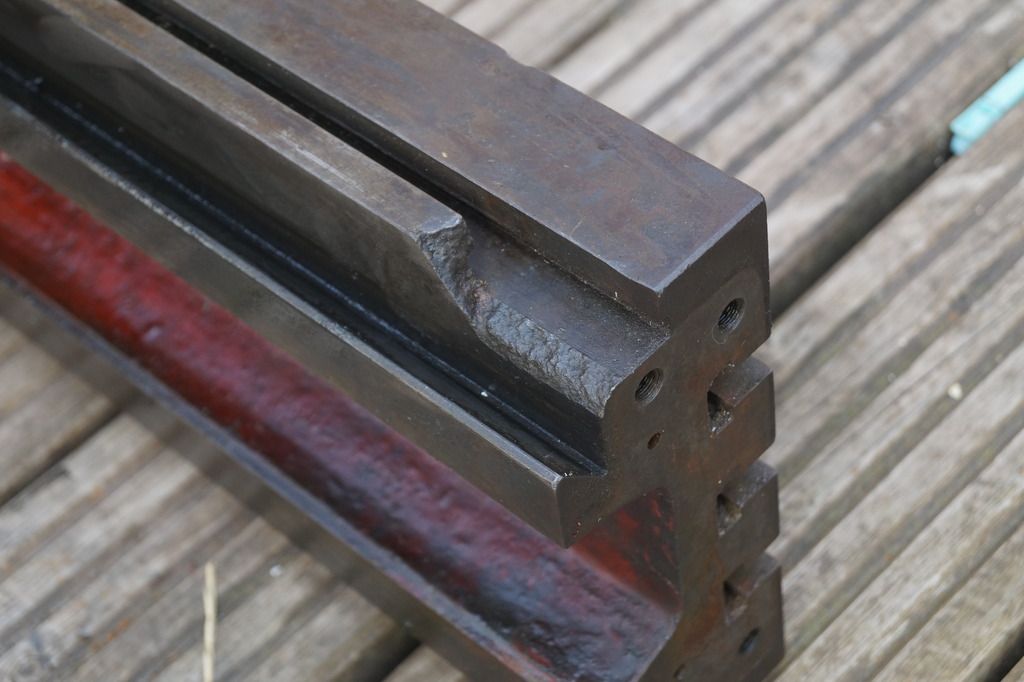

here is the table before hand ,
on it is a 12mm drill gives you an idea of the size , its about 30" long.
and here are the grub screws
some damage i found , but not sure if it will detrimental to the machine , or if it could even be repaired.
