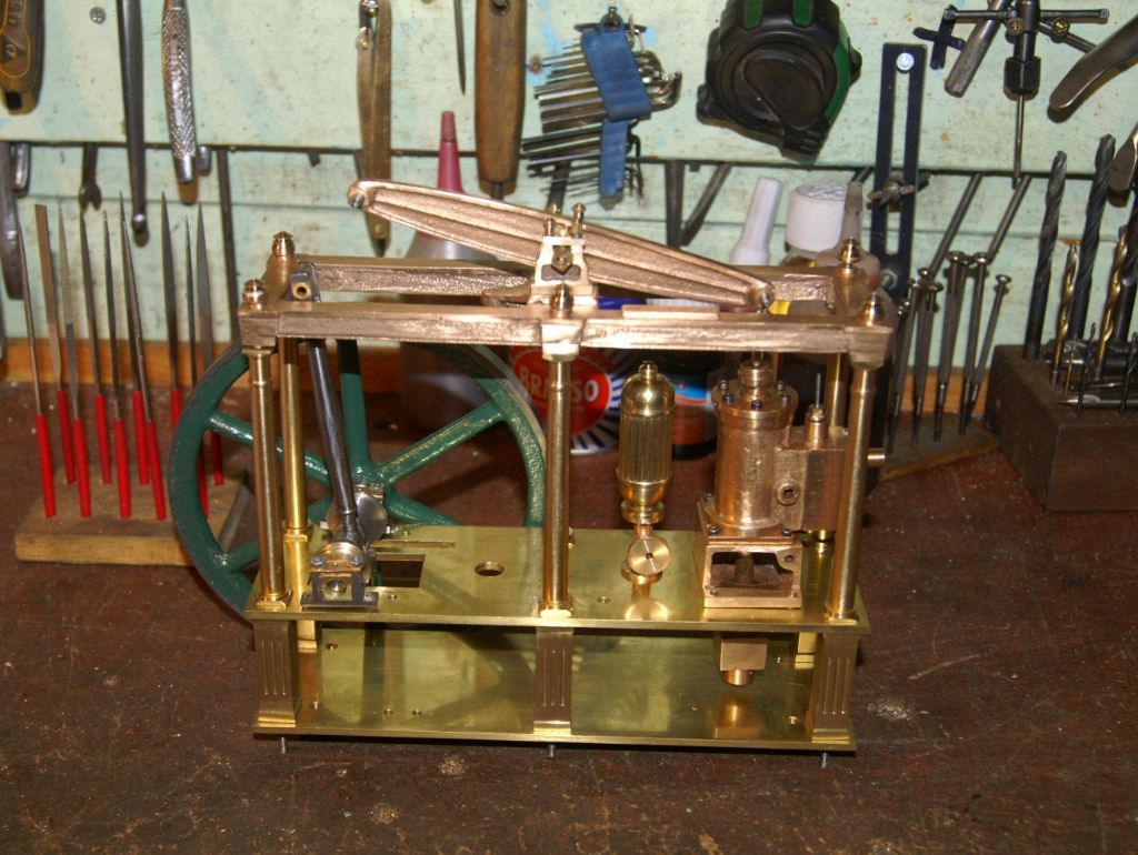

john carruthers30/10/2015 12:17:47
avatar
617 forum posts
180 photos
Got the pedestal/cylinder covers/valve and rod done.
Used the new (ish) indexer to mark out the cover holes.

john carruthers05/11/2015 16:18:40
avatar
617 forum posts
180 photos
Today I received the 2mm ball end mill and made a start on fluting the square lower columns...

john carruthers17/11/2015 16:23:55
avatar
617 forum posts
180 photos
Probably the most recognised bit, the air vessel. Still have to make the flange drilling jig.

john carruthers20/11/2015 18:21:42
avatar
617 forum posts
180 photos
ls 20-11-15 (1).jpgAnother week done but nothing very obvious to show for it. Lots of little 'hidden' parts.
Next step, the eccentric strap and rod. I may make the lattice 'rod' from 2mm tube, see how it looks.

john carruthers23/11/2015 09:41:54
avatar
617 forum posts
180 photos
eccentric sheave, straps, rod and 'forked jointy end thingy'.
I shall clean up the solder a bit more.
john carruthers28/11/2015 11:17:29
avatar
617 forum posts
180 photos
Making a start on the parallel motion plinth.
